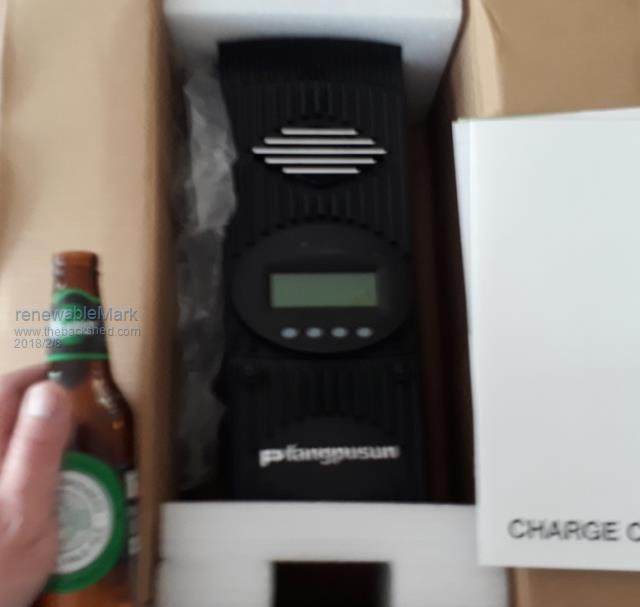

Got my new controller today.here
It can take a higher voltage than my previous ones (100v current max) so I wired everythin in 2 series and parralled them, now I can series three to get a tad under 120V open circ so it's still classed as ELV, so less line losses, sweet!

That Fangpusun is a rip of an Outback, although you can run higher voltages you will get higher efficiency in the controller if you can keep you panel voltage as low as you can above 65 volts. The difference is not huge but there is a few watts you can pickup,=. Probably what you lose in resistance at a lower voltage negates any gain anyway unless you go to heavier wiring to the panels.
What you can't do is exceed 150 volts, the critical time for that is predawn on a very cold clear morning. There is a temperature coefficient for all panels and you need to be sure the open circuit voltage won't go too high when they at their coldest. However, if you are >120V you will be well within the safe zone.

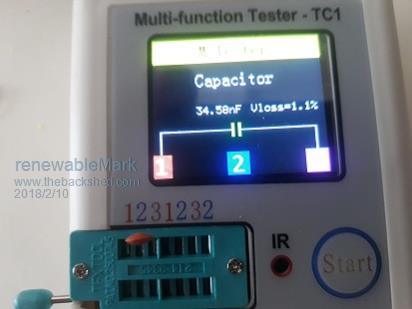

Hey guys I have been testing the components and most are fairly accurate, however
the 100uf electrolitic caps are testing around 86.
The 100nf monolithic are coming out at 34nf!!!
Am I expecting too much or is this way too far out?
Surely the circuit won't operate as designed if the values are only 30% of what they should be.
I tested them with the multimeter too and the tester appears to be accurate.
Cheers Caveman Mark
Off grid eastern Melb
noneyabussiness
Joined: 31/07/2017
Posts: 527
Posted: 01:19am 10 Feb 2018
I have one of those... they usually pretty accurate ( to a point )... make sure it is calibrated...
But i personally have had stuff that far out, usually old caps etc. That would be expected

renewableMark
Joined: 09/12/2017
Posts: 1679
Posted: 01:25am 10 Feb 2018
The multimeter showed a very similar result.
So that 100nf mono testing at 34 surely needs to be tossed??
How far out do you normally accept as within spec?
Cheers Caveman Mark
noneyabussiness
Joined: 31/07/2017
Posts: 527
Posted: 02:30am 10 Feb 2018
i would personally... because i have heaps spare.. but if in a non critical roll and the only one you have then keep it...
the letter next to the number usually is the tolerance spec , 104J for example the " J " represents say 10 %... sometimes though it can mean the voltage rating.. just to mess with you
