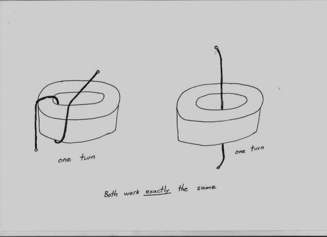

Its not obvious, but the only part of the wire that actually does anything is the bit that is within the ferrite slot. Or in the case of a toroid, the very short section of wire that passes through the hole. The other three quarters of the length wrapped around the outside is just there so it can make another pass through the hole.
You will have noticed that clamp testers and current transformers often just go around a single wire very loosely and they work fine.
So don't fret about trying to wrap a really fat cable around a ferrite with very sharp corners, it really is not necessary.

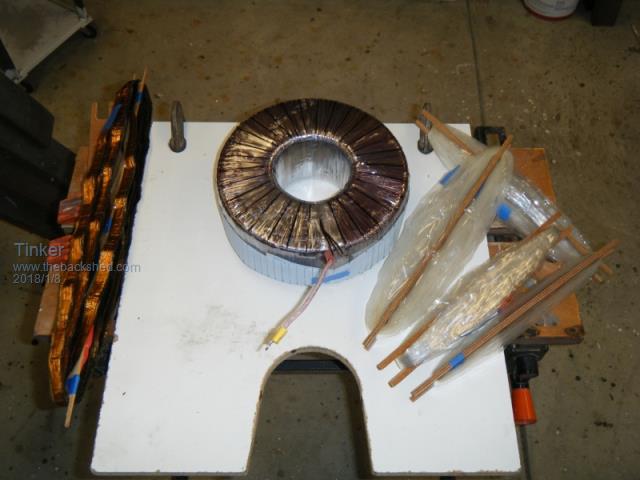

Here's a picture of my winding table:
Its safer than trying to wind the thing while its on end and ready to roll off the table.

[quote]While warpspeeds comments are true with the toroid, you should try to wind as tight as possible to avoid vibrations in the turns. That is also why we epoxy each layer and wrap that clear tape back on.[/quote]
Yes a good neat tight solid winding is definitely the way to go for the final effort.
But for quick and dirty initial testing, for example a ten turn experimental winding as previously suggested, just ten loose sloppy turns of any old pvc wire will work exactly the same for measuring turns per volt, or magnetizing current.
With all these things, one pass through the hole counts as one full turn, regardless of where the wire is located in the hole, or how it gets back around the outside of the magnetic core to the other side.

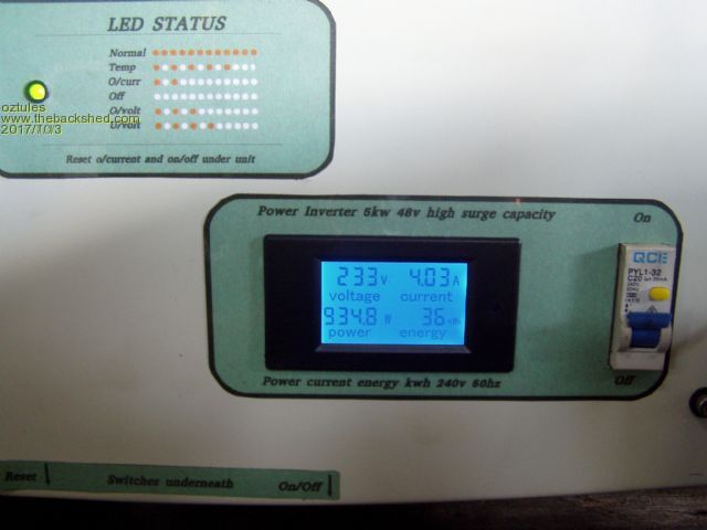

  oztules said   Clockman.... ... not really.....it is best to have a press button on the external surface of the box. Mine is under the unit ( wall hung ), so is not obvious, but easily available. This allows easy soft cap charge, and simple reset to start after that.
Ideally, you would have a two pin connector on the board..... I just solder a few wires on at the moment.
Once running will never be needed again, unless you overload extremely, then you want..... a reset button .
No Warp, it is not even remotely worthwhile complicating a simple system. A push button is all thats needed, and all the folks who have these things over here, probably don't know the switch is even there ( it is labeled as reset on bottom), but it will never probably be be required. The on/off is also on the bottom, but who wants to turn off their power ( other than experimenters)
Hanging is only probable if you don't want to splat the terminals on installation. After that, it is not likely to ever be required again except for current reset. In normal installations, the batteries are not disconnected again until refit.... once again a reset button is all thats needed.
Here is a pic from another thread that shows the switch label/s
.........oztules
So when you start the unit up do you hold the reset button when you turn the DC supply on, then release the button?

Posted: 08:14am 03 Feb 2018
No.
When you put the 48v batts on, it will probably start if you splat the terminals, but if you use a say 30r resistor to alleviate the splat, it will hang... then press the reset, and it will start normally from this time on.
........oztules

OK thanks Oz, just to clarify it, you "prime" the system using the resistor, once charged up, then the resistor is removed and dc power input permanently connected.
Cheers Caveman Mark
Off grid eastern Melb
oztules
Joined: 26/07/2007
Posts: 1686
Posted: 08:21pm 03 Feb 2018
yep
Posted: 11:24am 04 Feb 2018
  renewableMark said   OK thanks Oz, just to clarify it, you "prime" the system using the resistor, once charged up, then the resistor is removed and dc power input permanently connected.
This is the way I turn mine on too. But the resistor is connected across the DC C/B permanently.
With the breaker open the caps charge up via the 33r resistor (use a big one, 10+Watt rating, in case there is a problem). I have a zener diode controlled battery voltage sensor which turns a LED on when the caps are charged up. When that happens the DC C/B is closed manually, shorting out the 33R resistor.
That battery voltage sensor also doubles as a low voltage shut down. This is done by tripping the over current thyristor. You can see how that's done in one of the circuits I posted a while ago (building an inverter from scratch).
