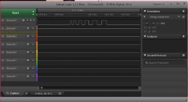

This has a new command "BITSTREAM" at the request of RonnS which mimics the bitbanger CFunction on the MM+
This waveform was created with the program
DIM INTEGER BITS[10)
SETPIN 40,DOUT
PIN(40)=0
FOR i=0 to 10
BITS(i)= i*2 + 10
NEXT i
BITSTREAM 40, 11, BITS()
The syntax is:
BITSTREAM pin_number, number_of_pulses, array_of_pulse_lengths () in microseconds
Notes:
unlike the bitbanger function the BITSTREAM command will automatically create an end transition to the last pulse.
The direction of the first pulse will be determined by the state of the pin when BITSTREAM is called. If it is high then the first pulse will be at zero, if it is low the first pulse will be at 3.3V
The arrays can be INTEGER or FLOAT but the pulse length must be specified in microseconds
The miniumum pulse length and pulse increment is 1uS
There is a known clock issue on the Pi 3 (it is not know if this affects all boards or only some - it certainly affects mine). Timings for the Pi 3 are scaled by 1.128 so pulses may be wrong by up to 0.5uS. The Pi Zero W works perfectly.
In addition 5.4.a04 has some tidying up of digital I/O to remove runt pulses when using SETPIN x,DOUT
I would like feedback on whether serial output works properly on your PI 3 as this is subject to the same clock issue as described above and I've tuned the timings to work on my Pi 3.
