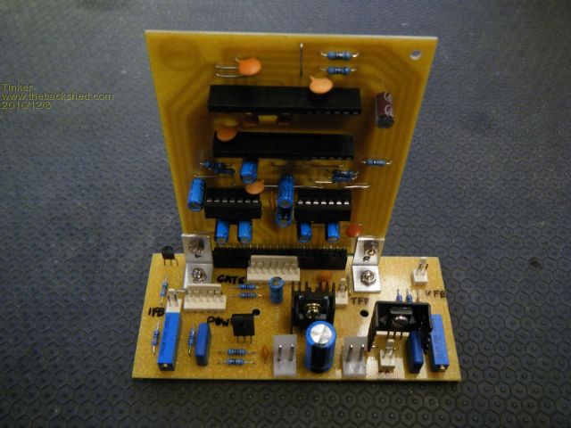

Have assembled the new layout of my EGS002 replacement board and it works! I'm happy now. Its a plug in replacement to my modified 20 pin EGS002 board (see previous page re the mods). But the big plus is the driver IC's can be easily replaced, just plug new ones into their sockets. These chips seem to go kaputt when the Mosfets fail catastrophically.
So, here is what it looks like:
The board plugs into my little motherboard where the header pin connectors are located.
The 300mm long gate leads from the socket did not appear to affect the running of the inverter.

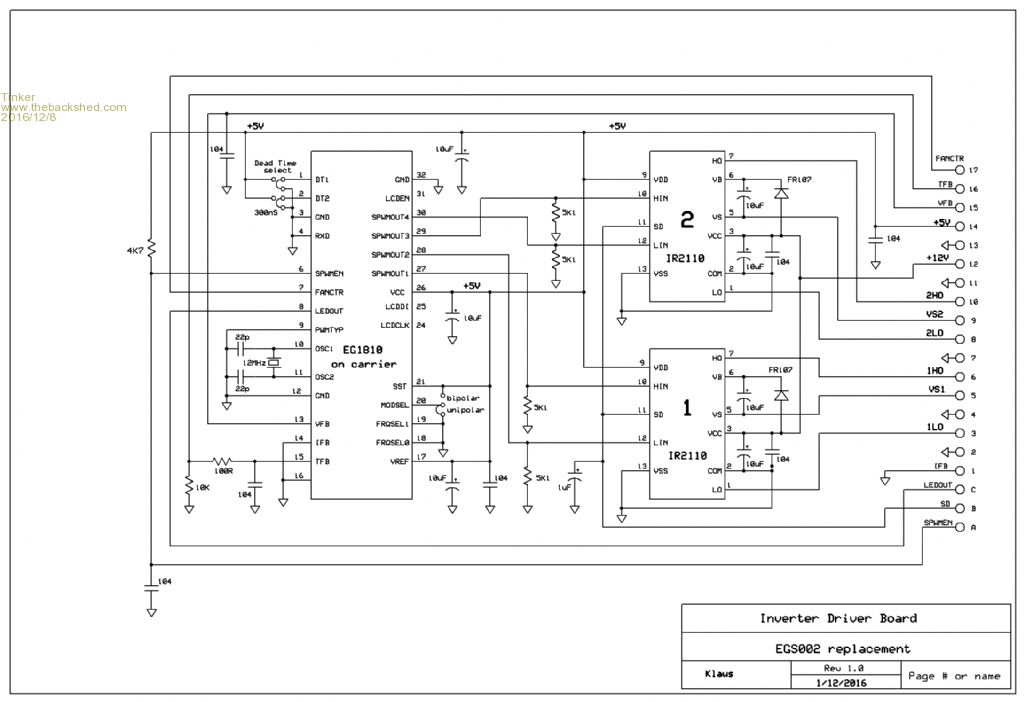

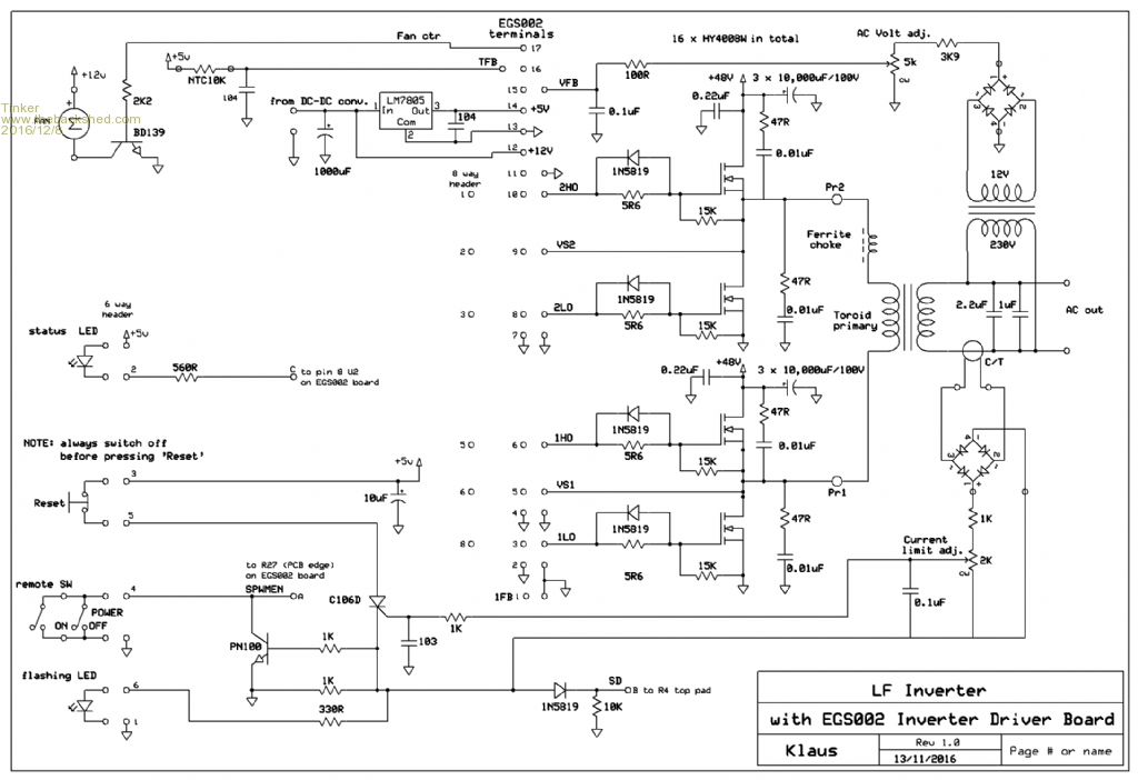

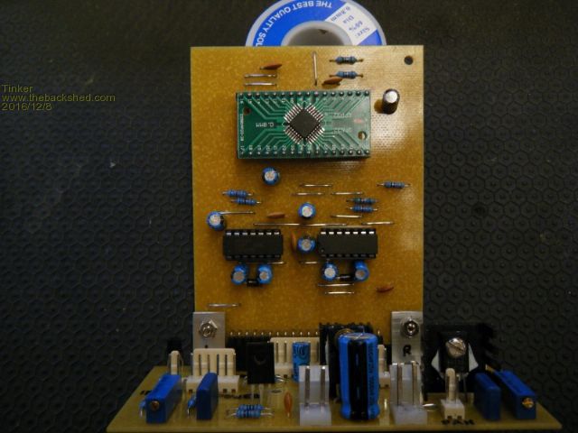

Here is a close up of the replacement board:
And, in case anybody is interested, here are the latest schematics:
Please note that the schematics I had posted previously have changed. I have to post updated ones as there is no way to correct what I posted some time ago.

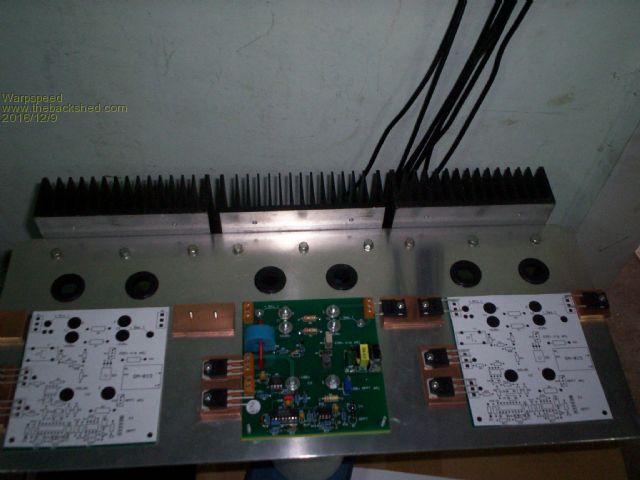

I don't want to muddy the waters here.
But after much messing about myself with building various projects over the years, and having quite a few blown mosfets from time to time (hahaha) I now build things in a way that I can replace a mosfet in less than thirty seconds without a soldering iron or the slightest risk of damaging the circuit board.
The trick is to use TO247 packages as mentioned earlier, and three terminal screw blocks on the circuit board. Here I am using copper spacer blocks, simply because I already have the material. Aluminium would work just as well.
If you tap holes through the spacer block a long 3mm screw can be fitted permanently up from underneath holding the spacer block in position. The mosfet then just drops over the protruding screw.
Dead easy.
One of Murphy's laws says something like "parts that can be very quickly and easily replaced never fail".
This is an old picture of a project in progress, that illustrates the general idea.
If I was building something that had a whole bunch of mosfets, I would not now consider doing it any other way.
