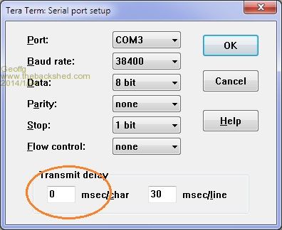

I still have problems with the full screen editor, same as on the other Maximites.
I just not seem to get it to work right in Tera Term (4.74).
Is there some secret setting that i miss?
I tried every setting I could think of but couldn't make Tera Term misbehave.
What you are seeing looks as if VT100 is not set for terminal type.
Are you using UTF-8 encoding?
Also, check meta key is off
and local echo off.
Any keyboard mapping used?
You could send a copy of teraterm.ini

TZ, I bet that the problem is caused by your configuration of Tera Term. The delay between characters must be zero as shown below. This is because MMBasic measures the delay between receiving the escape character and the next. If the delay is too great it assumes that the characters are individual keystrokes and processes them accordingly.
I have found that you can also set the delay per line to zero and it makes no difference. Finally, when you get it going try changing the baud rate to 115200 (OPTION BAUDRATE 119200) and then check out the editor... it makes quite a difference.

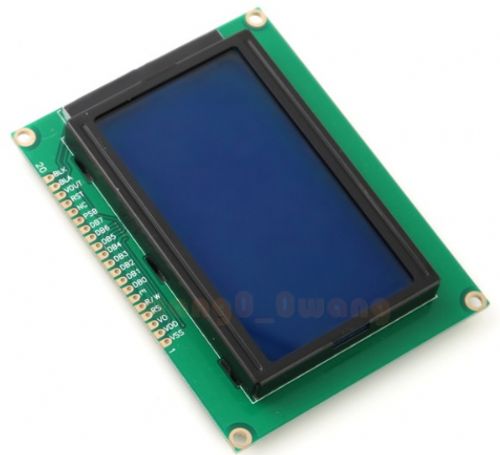

Posted: 08:09pm 24 Jan 2014
elproducts wrote:
Excellent. Thanks.
I didn't realize Geoff had created a Maximite graphic display example.
Does your graphics display have a CS1 and CS2 pin?
I don't see those connections in the code.
The link below is an example schematic I did with Great Cow Basic and a PIC16F886. I'm gonna try to drive this with MicroMite/ Maximite but I'm wondering if the displays are compatible. Mine is a 128x64 based on a KS0108 chip set and I got it on EBAY as well.
This is a photo from ebay, there is no CS1 or CS2, search for "12864 GLCD"
Geoff did an example for a alpha numeric display and I used part of his example

I connected my usb/serial converters (i have three different kinds) to the scope and noticed that even with 0 delay in Tera Term there is a delay of at least 10ms between characters. I am not able to measure it at the USB end, but i start to suspect that something is wrong with my USB hardware or driver.
I have the same editor problems on the UBW32 that i used to make a CMM.
My laptop died a few days ago so i have no other computer available at the moment to see if that is the problem.
Using other USB ports on the same computer does not make a difference.
I'll bring the micromite to the office on monday and see if it works better on another pc.
Posts: 3372
Posted: 12:11am 25 Jan 2014
MMBasic will wait for 30mS after the escape char for the next character to arrive. After that subsequent chars in an escape sequence can have a maximum of 20mS between them.
I could increase this timing but I am not sure that it will make any difference to you. I tested this at 1200 baud and there were no timeouts.
BTW This has worked perfectly for everyone else so there must be something strange in your setup.
