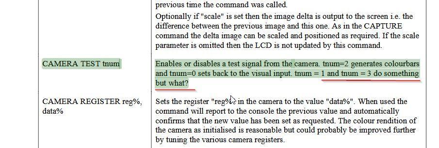

I believe something is unfinished here

Good one!
I think that is Peter taking a mad stab in the dark.
