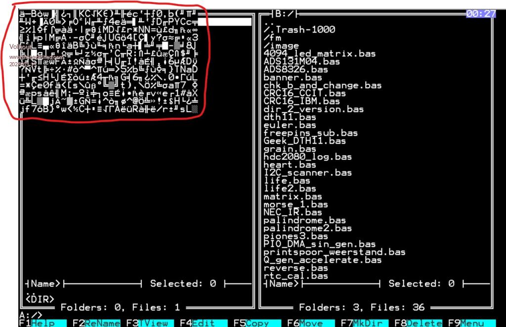

- tested on Teraterm (windows): screen does not autosize. Best viewed on 81x40 (manual setting). When 80x40 is chosen the blinking cursor is to right side, over the minute digit of the clock. When 81x40, the cursor is not corrupting the clock.
This can be resolved by adding the line "OPTION DISPLAY 40,81" to the program.

EDIT: the tests with sound and showing pictures all ended in ERROR messages when there is no audio (PWM/I2S/SPI) defined, and no (VGA/LCD/HDMI) screen defined. That could be handled more gracefully.
EDIT2: the screen saver (in my case) did not cover all 80x40, but only a roughly 32x16 area at top left size, also characters where white, not green. I will confirm if this is related to the fast screen update (Pause 10) and play with the value.

Michael,
The screensaver size is not related to update rate.
Even when slowed down, it still only manages 32x16 area.
This is caused by incorrect MM.HRES and MM.VRES, since there is no display.
But we have set terminal windows as 80x40 with OPTION DISPLAY 40,81
This has a working screen saver...

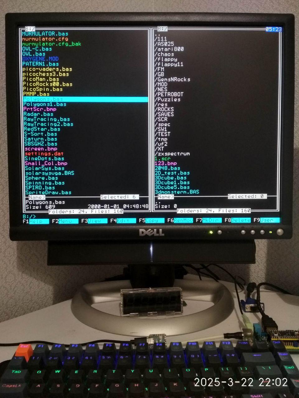

Today I did a little programming, made file coloring and multi-select, for now it only marks files.))
FM140.zip
Need advice on coloring files, assigning buttons, etc.
Of course, I can't keep up with you, I'll dig into this further as much as possible... I'll be looking at your code.
