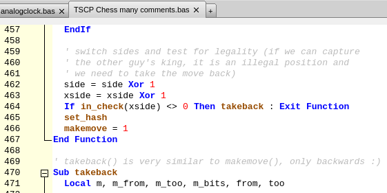

Posted: 02:56pm 05 Oct 2022
Hi Jim,
Have not seen any abnormalities. Works nice, the coloring of functions is really useful. Thank you for that.
I noticed it also colors labels (xxx:) was not expecting that but that is actually also nice...
I will put it through it's paces the coming weeks and see if I can find problems, but for now: TOP.

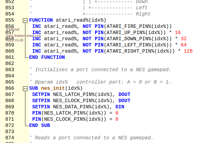

Posts: 6254
Posted: 02:56pm 07 Oct 2022
Hi Jim,
Minor remark:
Functions that end with a % do not color.
Posted: 07:40pm 07 Oct 2022
  Quote  Functions that end with a % do not color.
Nor do ones that end in ! or $.
I will see what I can do...
Posts: 6254
Posted: 08:49pm 07 Oct 2022
The ones with $ are colored. I checked.
Posted: 11:52pm 07 Oct 2022
  Volhout said  The ones with $ are colored. I checked.
Not always. Now they will. The changes I made might have changed a few other things with keyword recognition because there is a lot of interaction between the various lists.
