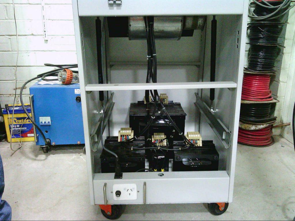

That is basically what I did, my outer cover being a resurrected two drawer filing cabinet turned around backwards, so its fully open at the rear.
Another successful method to house very heavy transformers would be to buy an old antique buzz box stick welder, and throw away the guts. That leaves a very robust one foot cube metal box, with ventilation louvers, two wheels and a handle.
See the blue box in the picture.  That is now a 5Kw three phase dc rectifier with three stacked toroids inside.

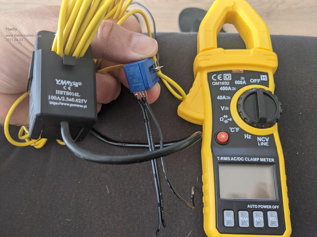

Finally I tried the 15A rated LEM sensors that I de-soldered from the DC side of an Aerosharp board, but I can't get that going at all.
These LEM current sensors have 4 wires.
Ground, 5V, output, and reference.
Give it 5V on 5V pin, with the supply going to ground pin.
Now measure the output relative to the reference pin.
The reference pin is internally pulled to 2.5V.
And the output is driven relative to that.
So put the DSO ground clip on "reference" pin and the DSO signal on the output.
From the photo above the pinout is
from left to right
5V, ground, output, reference.
The output will not make much sense if you measure it with respect to ground.
It will always be something like 2.5V
This is by design.
These devices are nice, they allow isolated current measurement with 5V supply.
I can't quite tell from the photo but it might be a CSR 15 which means it gives
an output of 2.5V with a bipolar output adding or subtracting from the "reference" 2.5V with a gain of 41.7mV/Amp
It does not go rail to rail, i.e. output goes down to ground or up to 5V.
There is a limit.
If it's the CSR 15, then it can measure +/- 51 Amps or
+/- 2.127V relative to the "reference" pin, which is 2.5V
So the output would go from 0.37V up to 4.63V for the -51 Amps to +51 Amps
If the part is a CSR 6, then the measure range is smaller but with better resolution.
It has 104.2mV / Amp gain but same deal for output.
It's all relative to the "reference" pin.
Edited 2021-04-04 19:15 by poida

Poida have you used the LEM sensors on DC or AC successfully? Or both?
It's a CASR 15-NP part number. It was in the DC section of the inverter (from memory) but I popped open the casing and I saw a coil so i was puzzled on how it could measure DC current.
It's possible I may have blown it up. I have many more on hand and will give them another go.
poida
Joined: 02/02/2017
Posts: 1507
Posted: 10:32am 04 Apr 2021
I've used them with DC and AC.
The frequency response is from DC to about max. 300kHz so it's good for the sort of things we are doing here (with 20kHz switching)
These parts cost about $20 AU from RS components
I think they are worth the time to remove from the boards.
How they work:
a ferrite core concentrates the magnetic field of the current
conductor through a small space where a hall effect sensor is located.
An opamp is then used to create a magnetic field to oppose this
and the opamp output is used as the sensor output.
It's not as fast as a simple current transformer but it does DC.
They are lower noise than the Allegro parts.
But just as easy to use.

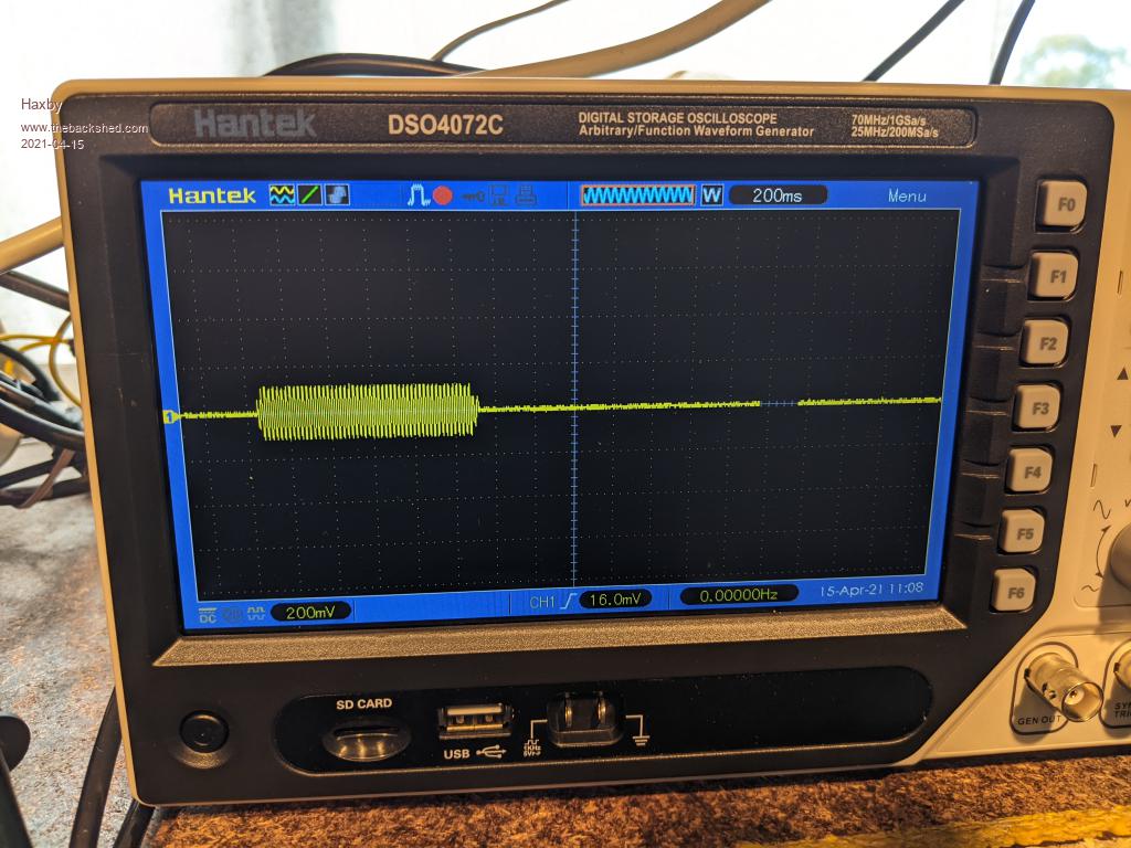

Ok a 100A to 20ma current transformer was delivered to me today.
I set it up on a cut extension cord with a 10 ohm resistor across DSO probe, parallel with the CT output. Just a single loop of active wire went through the centre of the CT.
So v=IR
200mv=10ohm x 20mA
So 100A full scale should be 200mV on the oscilloscope. Right?
Well that's not at all what I get.

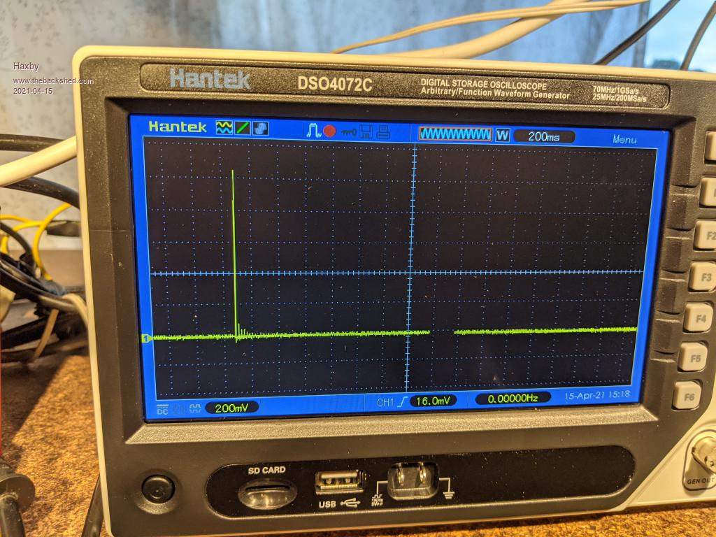

First a 2000W cheap heater:
My clamp meter shows 8.6A which is close enough to 2000w so I trust it's accurate.
The DSO shows around 120mv peak, so around 80mV RMS.
Why the huge discrepancy?

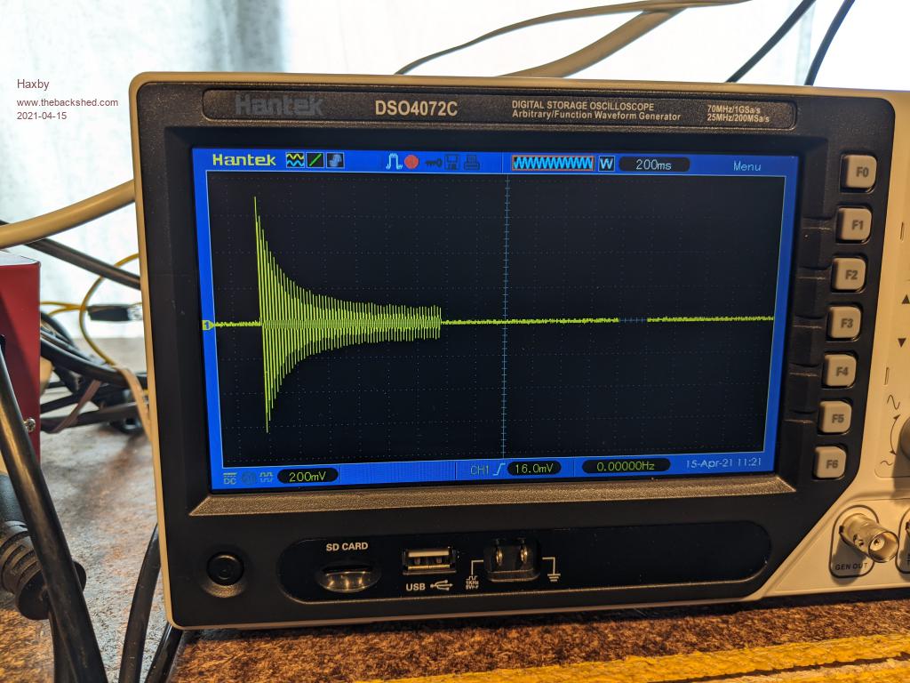

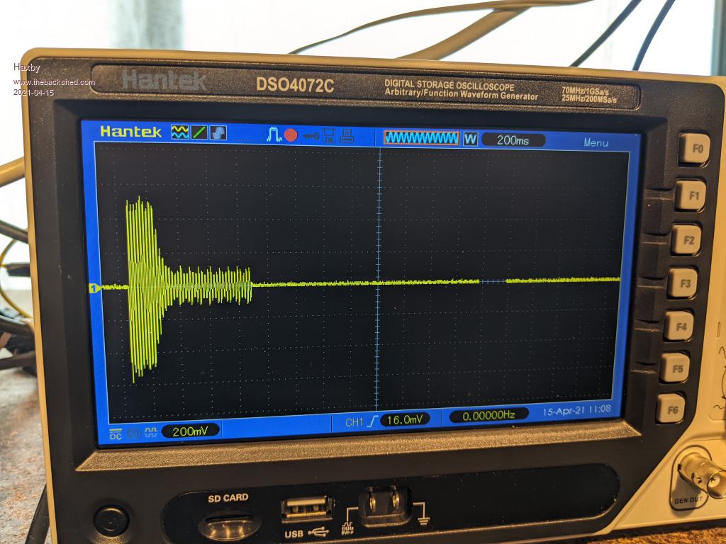

Anyway here are some more screenshots for those interested. Based on the 2000w heater baseline measurement, I'm reading the scope as 20A per division. I have kept all scope settings the same for all 3 appliances.
Here is the 2000w AEG brand belt drive 50L air compressor starting up. Looks like around 50A peak:
And here is a miter saw spinning up from standstill. Woah, 70A!
Edited 2021-04-15 15:00 by Haxby

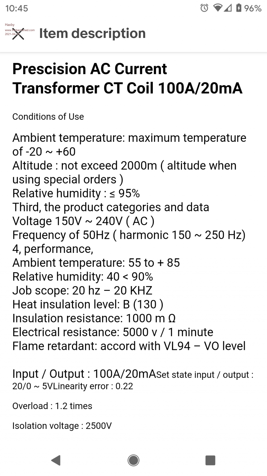

Here is the spec sheet of the CT.
