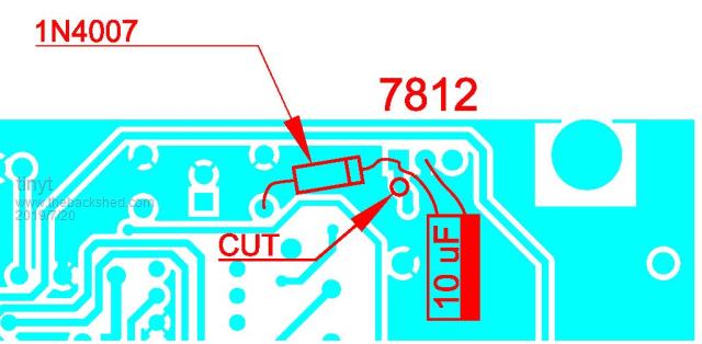

Digikey has a 1A .22V vf diode LSM115JE3 @$1.12.
Maybe instead of looking for a low vf diode to clamp the 5v supply, try this.
Add a regular diode in series with the input of the 7812 regulator. This is PCB bottom view.
Maybe it will block the negative spike from flowing thru the 7812 and 7805 regulators. I have also added a 10uF filter at the 7812 input. The 7812 output might be slightly lower than 12 volts. Hopefully it should not affect whatever fan it will power.Edited by tinyt 2019-07-21

[quote]I suppose we need to put a low Vf diode on the 5V supply to clamp it to no less than
-0.5V[/quote]
It may need to be the Shottky type to turn off fast enough.
A sleepy old 1N4007 power diode may not be up to it.

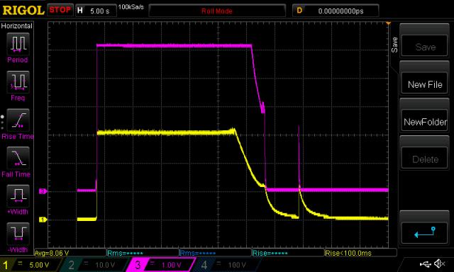

The manifest specified converter is NOT a flyback type, just a non-isolated Buck.
But this 1V spike is present on it's output (of 15V) and it correlates
perfectly with the observed 5V supply spike.
Pink is 5V on nano2,
Yellow is 15V output

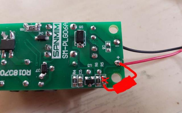

I thought I might use the tiny flyback converter as used in
the Warpverter that RenewableMark is building.
I have fitted one of the 15V units to the second nanoverter board.
They can go to 15V. But they do not supply much current before the output drops.
Only about 0.3A at 15V
I only had 12V flyback units so I changed the feedback resistor to suit 15V.
I found I needed 12.2K for 15V and 9.3K for 12V output.
See below for modification.

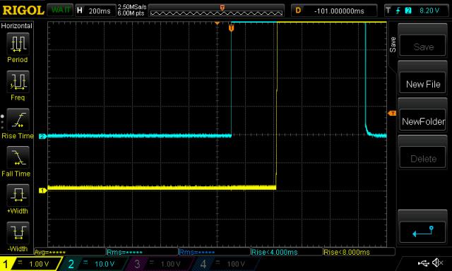

This is the power-on behavior of this converter.
Light Blue is 50V supply, Yellow is 15V output. Note the vertical scale, 1V/div
No negative glitch at all.
And it takes about 300ms before output appears.
I think I will use these dc-dc converters. And it forces me to provide an external supply to power the fans. Oh, well.

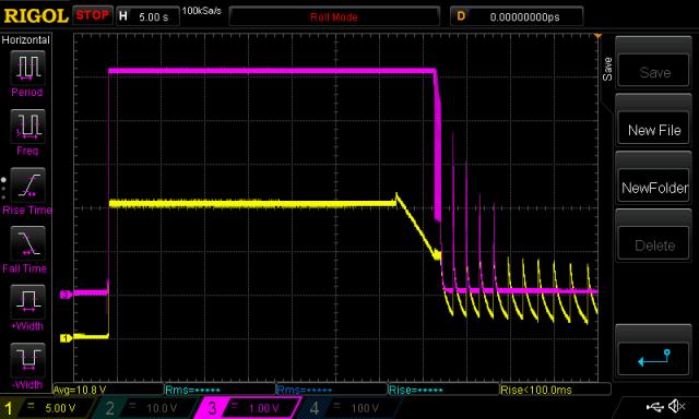

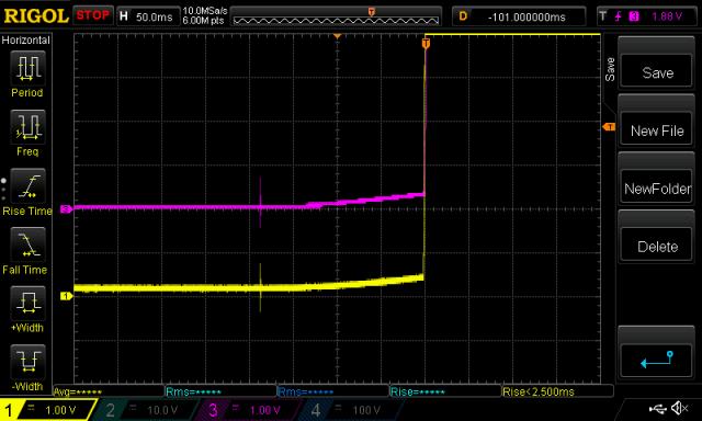

More observations of the dc-dc supply and the two linear regulators.
One thing I neglected to show was I am using a 7805 dc-dc module
in place of the linear 7805.
I chose to use this when the linear 7805 I first installed was getting
stupid hot. And that was under nominal run conditions drawing maybe 100mA.
This may have some contribution to the nano programming loss.

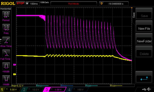

So here I show a slow scroll of the application of 50V supply
and removal after about 5 seconds. Let's see how the 5V supply behaves
when I use the more efficient dc-dc type 7805 device.
Yellow is 15V output from the 50-15V converter, Pink is 5V at the nano.
I zoom into the area when 15V drops below about 9V
and we see the dc-dc type 7805 module oscillate it's output, at about
a 33ms period. Probably going to cause problems with the nano(s)
I immediately replaced that component with a linear 7805 and we
now have none of that oscillation.
The negative pulse remains, due to it originating from the 50-15V converter.
Have I created a waste of time for us all with my use of the dc-dc type 7805?
