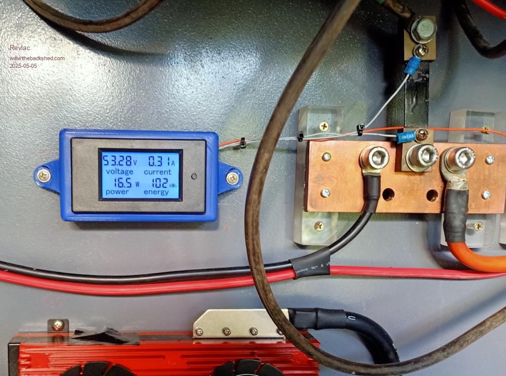

Finally got around to making an enclosure for the current meter, Designed and 3D printed for the PZEM-051 and others etc, fits ok with some little file work and trimming.
The only other change in the meter reads 16w now, it was reading 12 watts, whats up with that....nothing.
Intend to make one out of better material, this is PLA just for a test fit.

Still a very nice job on that housing.
Have you tested the accuracy of the DC current readings in those meters? I'm finding that some similar units are out a bit, and I like the simpler display on yours.

I have quite a few of these meters and most of them have a cut or two in the shunt when they were initially calibrated, I doubt it was done to perfection.
This one seems to be quite good at higher power levels, but I will have to check the lower idle power it measures on the inverter, next time its shut down I can check on this with the current limited power supply.
The printed case works well and I made it with some room inside so the wires fit in easily, had second thoughts on the design of the lugs holding the case to the cabinet.

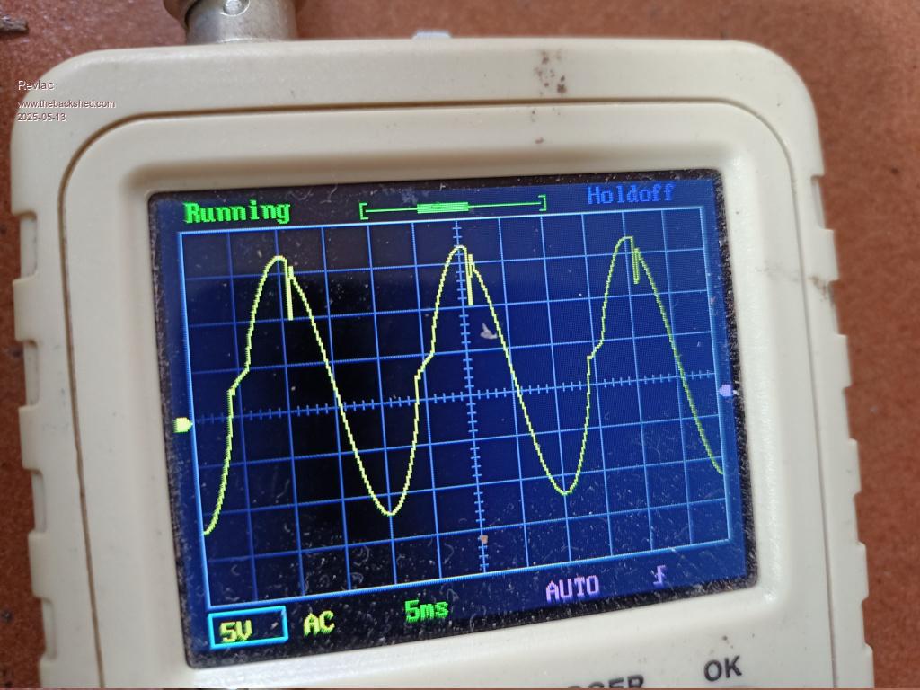

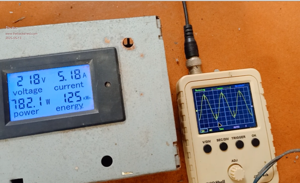

Inverter has been running well, voltage is set to 230vac and it holds it very well, just a small deviation of +/- 1volt, Though I found a significant voltage drop under load the other day.
I was using the heatgun on High, through a speed controller, "AC 220V 10000W SCR Speed Control"  and the inverter output voltage dropped down to 217vac on one occasion that I noticed, Decided to have a look at the signewave with the little scope to see if it was bad or something to worry about, as it turns out, it was mostly the peak of the wave that was getting chopped with the SCR switching, when running at higher power the voltage wile rise back up again.
I don't think it is a problem on its own but weather it will be while running the house, don't know yet, haven't noticed any noise from the inverter as the heatgun is so noisy anyway and I can't be in 2 places at once (tried it) will try something later, the inverter seems to survive it just fine.
I have been using this heatgun with speed controller for years on the HF inverters and haven't seen as much voltage drop.
Now when I switch the heatgun to low and use the speed controller, I think everyone knows and has seen the single diode effect on the signewave, and is the reason I don't use low speed anymore.

The sharp divot (first picture) is a product of the SCR speed controller, The controller was wound up to half power and the SCR's are working at the peak of the signewave, just the most dramatic example of what the controller will do, turn the controller up and the divot decreases dramatically till almost nonexistent, the same when winding the speed controller down low and there is little to no divot.
The second picture is the same controller speed setting but with the heatgun on low to show the diode just above zero crossing along with the SCR triggering.

Hi Aaron, hopefully those little meters are true RMS meters and also allow for highly reactive and highly distorted AC waveforms when calculating output. Inverter feedback loops are not usually true RMS detectors so there can be more voltage variation with highly distorted loads.
The Inverter will make some noise when a load starts pulling current from only ONE half of the AC cycle. However it does not seem to bother the Inverter in any way, you will find that with more inverter loading, especially resistive, that the heat gun noise will be lower, our Hot water system at nearly 3kW will swamp the effect of the Hair dryer that my wife occasionally uses.
Apart from the visible spike in the AC waveform, there will be all kinds of ripples and wobbles from high Harmonic distortion created by these bad load.

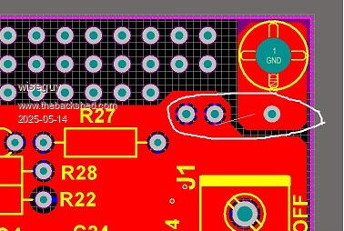

Dex had a similar fault when inverter noise was upsetting the voltage control, under higher loads the output voltage reduced. Try putting a 10n ceramic capacitor as per the picture (white circle either 0.2 or 0.3 pitch) and then re-test to see if it is improved.
(This "cure"? assumes a metal standoff to the chassis below for the screw on that corner)

I wasn't sure if the meters were giving me the full picture, the one on the wall at the switchboard was the first one I noticed the voltage drop, to further check what was going on I used another meter and located that near where I was using the heatgun and could get the picture and short video of the the voltage drop, this was also at the end of a 20 meter lead which shouldn't make much difference.

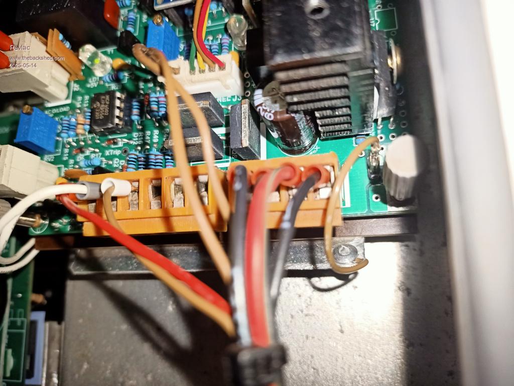

Using the little DSO there was a drop in the signwave amplitude could also see it in the video clip, even more with the heatgun on low, played it a few times to be sure.
Later today I used the phone sound recorder to see if the transformer makes any different sound, (mounted about less than half a meter from the transformer) could barley pick up any sound at idle, then with the heatgun running at half speed/power 10 meters away,  there was just a small buzz sound recorded but not very loud, interestingly Tried it again and walked back to the inverter and there was no voltage drop on the inverter Display, still reading 230v....that was interesting and a few things to consider.
I posted a photo of the output filter that I hadn't finished connecting properly, there is a fuse left in place from the original inverter, the output relay is after that, the the VFB gets its feed before the fuse, I should probably annihilate that fuse.
  Quote  Try putting a 10n ceramic capacitor as per the picture (white circle either 0.2 or 0.3 pitch) and then re-test to see if it is improved.
I had been thinking about that, I forgot to post a picture of what I had done  Made up an aluminium shield under the controller PCB and wired that to the ground pin on the PCB, not sure if it was best way to do it but the voltage has been very stable with all other loads I have thrown at it.
It might still be stable at the VFB, I will have to check the voltage at either end of the filter and that fuse.

The fact that the meter on the inverter shows the correct (incorrect?) voltage although other meters downstream show a reduced voltage (the real voltage) I think is more proof that inverter noise is corrupting the regulating feedback signal to the Meter and Nano.
The corrupted feedback signal may have noise riding on top of the feedback sinewave and once the feedback + noise equals the Nanos target voltage it happily regulates to what it sees and the meter also displays what it sees, hence the error.  Killing the noise lets them both see the true feedback voltage.
The AC feedback is best close to the external output ie after filters etc (but before any fuses or relays) as that would cause the output to go to maximum if the relay or fuse opened as there is no feedback then.

  Revlac said  Made up an aluminium shield under the controller PCB and wired that to the ground pin on the PCB, not sure if it was best way to do it but the voltage has been very stable with all other loads I have thrown at it.
That can induce more noise, remove lead and place with a cap (as per wiseguy) on the PCB, the internal PCB ground plane is connected to the PCB mounting hole, which is the connection point to the aluminum plate that the PCB is mounted on.

  KeepIS said   That can induce more noise, remove lead and place with a cap (as per wiseguy) on the PCB, the internal PCB ground plane is connected to the PCB mounting hole, which is the connection point to the aluminum plate that the PCB is mounted on.
KeepIS, I did not see the yellow wire that Revlac was grounding the PCB plane to the chassis, thanks for commenting.  However I also want to clarify that the PCB ground plane is not physically connected to the screw on that corner of the board. If you insert a capacitor into the provided pads/holes then the ground plane is connected RF/noise wise to the screw and thus the chassis.

I may have previously, misinterpreted ground plain DC- with with ground, as in grounded frame of the inverter, The wire (bit hard to see in the photo) was connected to pcb ground plain using header pins in the 2 holes just to the right of J1, same as those circled in the picture a few posts back.
I have put the capacitor in place and is now connected to the Shield plate underneath, Now I have run the heatgun and speed controller once and the inverter LCD reading is tracking close to the other voltmeter reading in the breaker box, its located 2 meters away and connected to the inverter with 10mm2 wire, so that appears to be working better
I have checked between the inverter case (grounded to the earth rod several meters away) and the control board DC- with the little DSO, Its Noisy, looks like a Rock Concert a Circus and some spanners thrown in, there looks to be several overlapping frequencies, have to take into account there are 3 inverters using the same Ground Rod.

Those are very sharp and repetitive divot disturbances.  I wonder how they show up in the actual VFB waveform at the controller.

Heat gun with diode on low setting, single 3 stack inverter.
These kinds of spikes and distortion have always been there in Inverters, in the past this type of garbage equipment could destroy some inverters, they don't bother these Inverters. Feedback goes through a transformer, full wave rectifier and filter, it likely shows as simple voltage change at ADC VFB.
I have not looked at the Dual inverter with this crap load, I have only monitored the DC current levels with a DSO for any current spikes, there are none to speak of, and the Toroids are almost silent with the Hair dryer which also has a diode on low position.
These loads have had no affect on any other equipment, and I have lots of equipment running both in standby and always ON, 24/7 for years on different (high power) Inverters.
