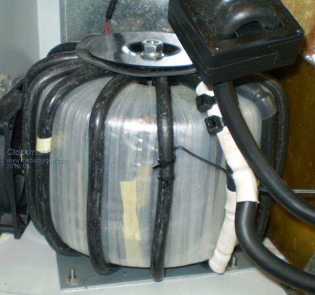

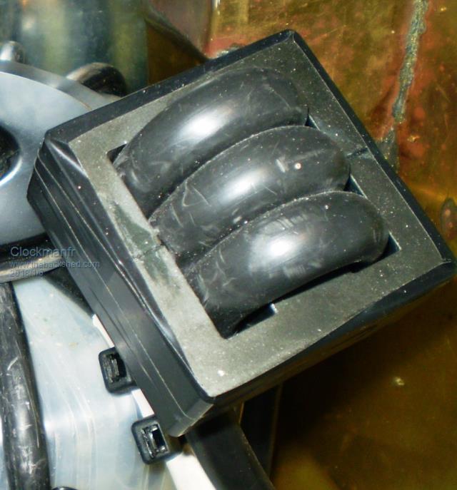

Here are my ferrite cores that go on one of the Primary cables, wrapped around a minimum of three times.
The big OzInverter has these, but doubled up giving a 40mm thickness x 80mm x 80mm when assembled. A 75mm/2 flexible cable will easily go around the centre ferrite column 3 times.
http://www.ebay.co.uk/itm/E8020-E80-Ferroxcube-3C90-E-EE-Ferrite-Cores-transformer-AL-5000-1set-/370683164776?hash=item5 64e703868
The 6kW OzInverter has these, just one set. 27mm thickness x 66mm x 64mm when assembled. Again wrap around at least 3 times, here I use 50mm/2 flexible cable.
http://www.ebay.co.uk/itm/E6527-Ferroxcube-E65-E-EE-Ferrite-Cores-bobbin-Power-transformer-AL-8600-1set-/370597734866?ha sh=item564958a9d2
Super glue the core together, I use insulation tape to hold them tight while the super glue sets. Like this .......

The bobbin (former) is nearly as expensive as the core, you don't really need it (and you get more wire room without it).
But beware, the corners are sharp and require tape.
Some suggest super gluing the cores together, this is a one way trip and I do not like it. Its a lot easier if you can hammer your wire around a dummy core made of hardwood or something and then insert the core halves over it, rather than trying to wrestle that stiff wire through the core opening and break the fragile thing in the process.
Besides, I found my core was a lot quieter after I stuck one layer of clapton tape to each mating surface, this creates a tiny air gap.
I also used 3.2x4.5mm rectangular enameled copper wire rather than that unwieldy cable for this choke, 4 in hand gives me 57.6mm sq and I very much doubt you could fit any insulated cable with that section on this core.

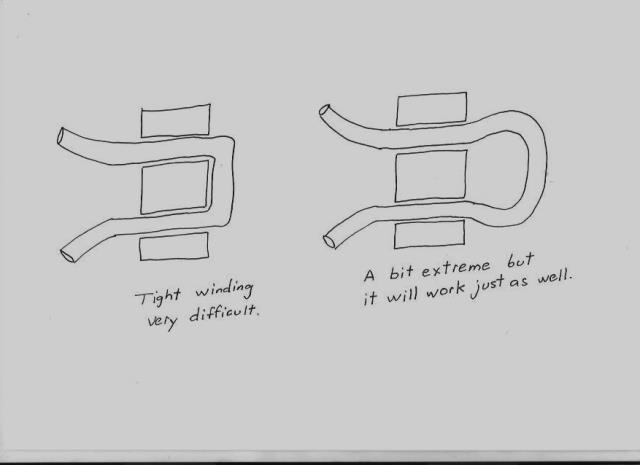

When winding very heavy cable through those ferrite E cores, its only necessary for the wires to pass through the slots the required number of times.
There is no requirement to have a very "tight" winding, as its very difficult to make very tight right angle bends around the rectangular centre of the core.
So don't worry about having big loops sticking out on either side, it has absolutely no effect on the inductance.
The length of wire will obviously be very slightly more, but the difference will be negligible in the great scheme of things.

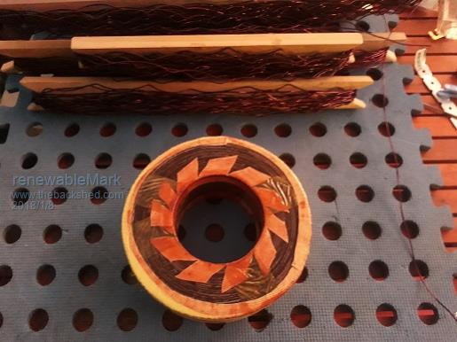

I got my torroid all apart today, sheesh got sore muscles I didn't know I had.
Warpspeed, thanks mate, I didn't know that.Edited by renewableMark 2018-01-09
