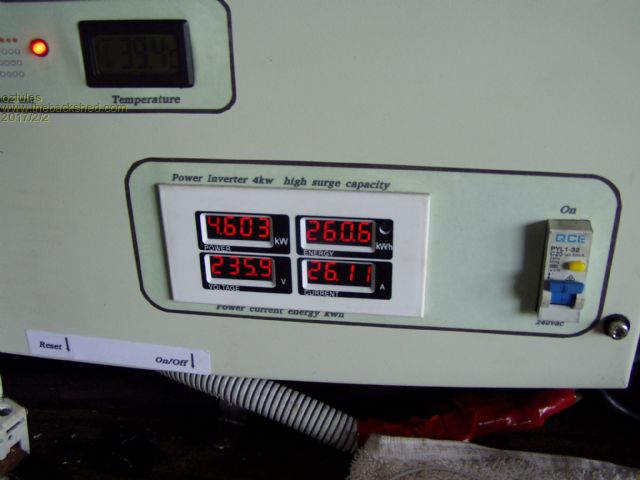

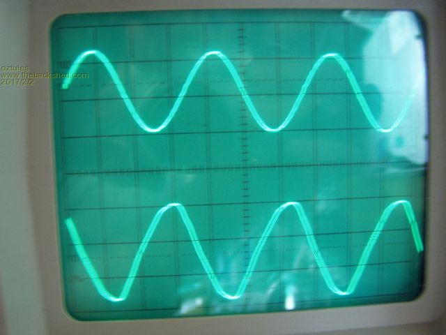

There is a new scope..... a German thing, but it has dual scan.
The top one is the 8010 running a few kw...... and the bottom one is the town grid I am at 50hz, and they are drifting above that from the looks of it.

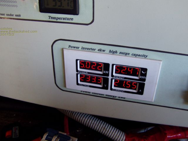

Here is the unit s few weeks ago...
and now a day or so ago...
So we have gotten a few kwh's under it's belt......
The unit runs at 232v... so the voltage drift is very slight for a 5kw load.... still blows me away.
Madness.... some times it just works...... actually if you blow that pic up, you will find some glitches in there somewhere, but it is much better than the main grid from the looks of it.... and stress free life for fets on the island too
Warp.... this one has it's current cut off somewhere past 15kw, as it shows 15kw and more starting the 5hp lathe motor with a clamp meter.... it's sampling is not fast enough to see the real transients I suspect.... probably in the 20kw range.
I set the current trip so that it does start the lathe
Start up is not a problem.
...........oztules
