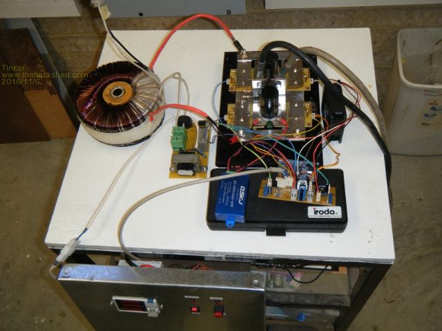

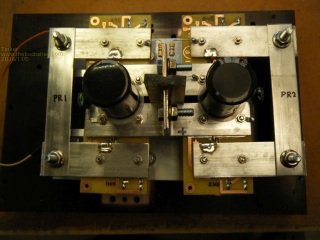

I was not game today to push my little 1Mosfet per leg inverter past 500W. It runs very well then, nice soft start and steady output voltage. I do not have a frequency meter but looking at the CRO graduations it appears the output runs at ~52Hz. The EGS002 is set to 50Hz. Is that reasonable?

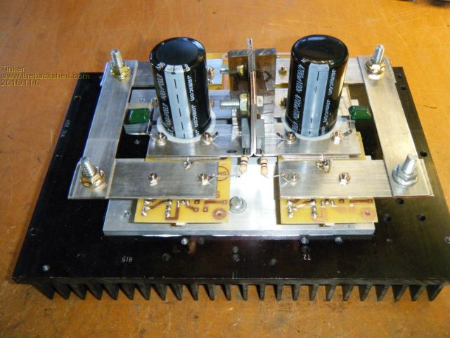

Here is a close up of the general layout.
So there is nothing wrong with that since the unit works fine.
Looking at the wired up inverter:
I deliberately left the leads to the gates long to see if there are noise issues. The leads are 300mm long to *each* of the gates. There are no long and short leads (like longer & shorter gate drive tracks on some PCB's) so the gate drive signals take identical times to get there.
I'm not sure if this is a big deal but it works for me.
The copper busbar track idea works well, the only bugbear is the difficulty to solder to them (they suck all the heat away and require a *huge* soldering iron).
So I already have the drain Mosfet lead clamped, clamping the source lead also only requires a small mod to my PCB.

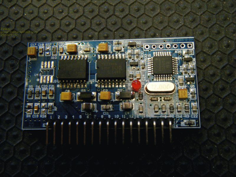

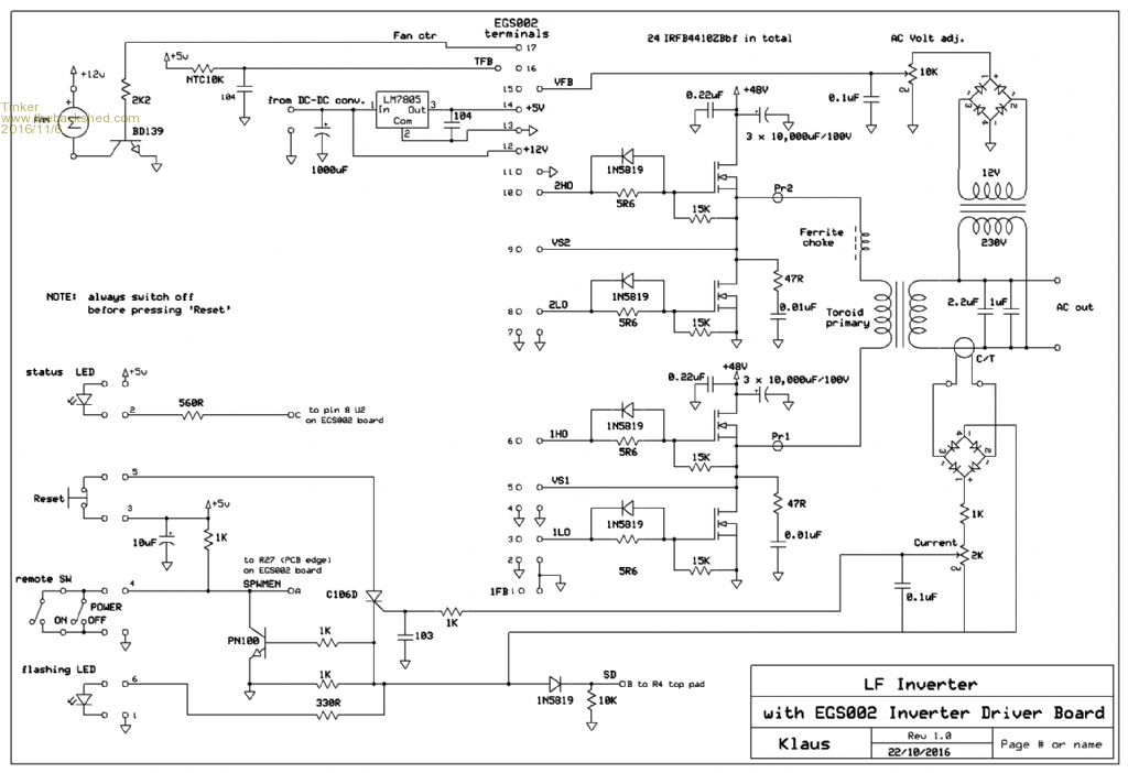

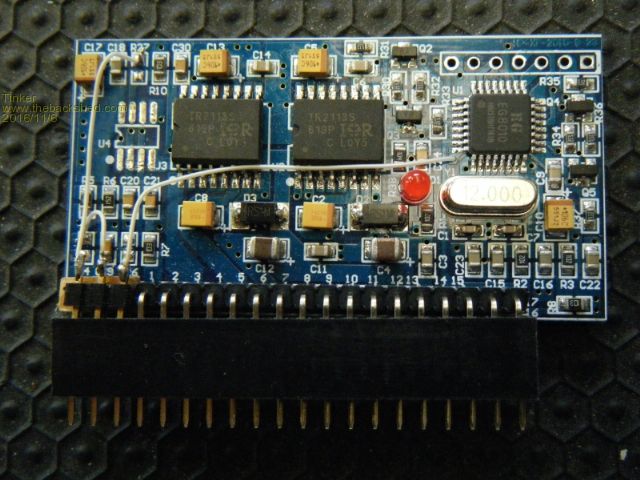

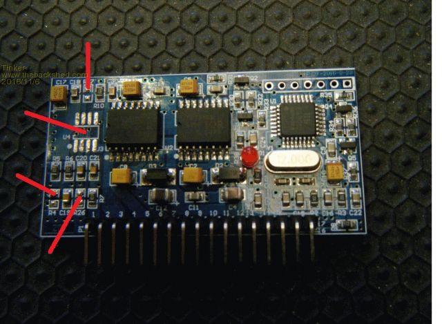

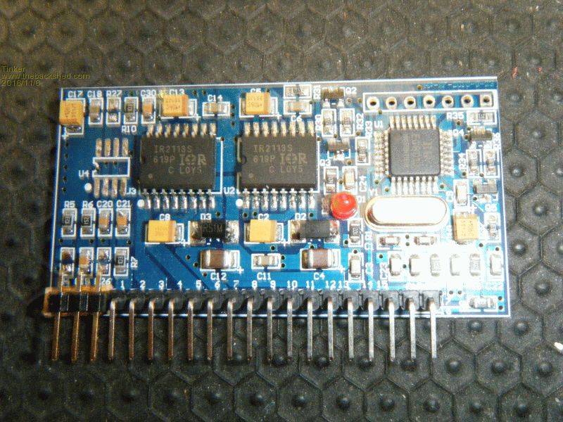

EGS002 driver board modifications.
First a few components need to be removed:
R27 was already missing on my boards.
U4, R4 and R26 still require removal.
I do not own any fancy SMD unsoldering equipment so here is how I removed these items:
I had two old chisel type soldering iron tips which I cut short (to make a bigger diameter stump) and on one filed a wider chisel point. This was now wide enough to bridge all 4 leads of one side of U4.
Then I inserted a scalpel blade under U2 with a lifting action while all 4 leads were heated by the wider tip. So one side of the IC easily lifted off the board. Grabbing the IC body with tweezers the other 4 legs were unsoldered, easy peasy .
For the SMD resistors I filed a notch in the other cut down iron tip, just wide enough to straddle the component. Heating both sides at once and swiping the part off takes less than 1/2 second with no damage to the board.
I cleaned the solder pads with a narrow solder wick and inspeccted everything under a big magnifying glass to check for solder bridges.
Next came converting the 17 pin header to a 20 pin header.
I cut a header strip down to 3 pins and made a little 2mm thick wood spacer to glue the extra pins in line with the existing 17 pins.
I named those pins A,B,&C from left to right as they are ahead of pin 1.
The letters correspond to the ones on my schematic.
Please disregard all other schematics of this board that I had posted here before. This one works for me.

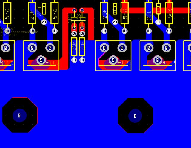

High side snubbers missing?.... may become unstable at higher power if not used.

"high side snubbers missing"?? There is a snubber (47R + 0.01uF/250VAC) at each end of the primary - see drawing. So one at the hi side and one at the lo side. Am I missing something here, please explain? Definitely do not want any instabilities at power.
Ha, I did not think the SMD IC legs can be cut with a blade. There's no way a side cutter gets to them. Thanks for the hint.

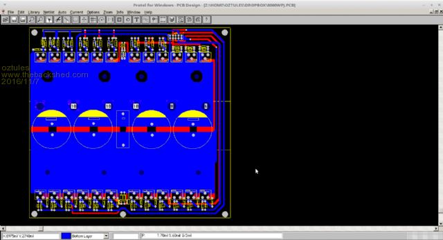

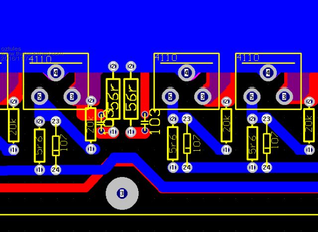

easy way for me is this.... three screen shots of the first duo of snubbers from primary to ground (-) and then primary to b+... then a far away shot showing position of both... there are 4 (four) snubber newtorks I use.... chack your PJ boards... they are the same.
First neg to primary/s
Then B+ snubbers
Pic to show position of other shots
Ignore the 56 and 50 r.... they are all 50r on the snubbers, but I am not particular with the drawing from the looks....
.......oztulesEdited by oztules 2016-11-08

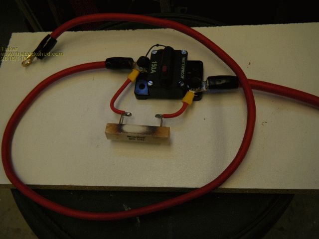

At the risk of mentioning the obvious, here is something I found very useful when testing my inverter:
Its simply a marine type DC circuit breaker bypassed with a 33R/20W resistor. The discolouring of this resistors shows it already has been useful , I salvaged it from the main board of the 3Kw Aerosharp.
I just wish I used that at the beginning, would have saved me a few Mosfet chips.
Following is how I test now.
Switch everything off (C/Breaker & inverter SW), no load connected.
Connect DC leads to battery bank, there might be a tiny spark upon making contact.
Measure the voltage at the main capacitor rails. It should increase to almost battery level as the caps charge up.
If this voltage settles more than 0.5V lower from the battery bank voltage, disconnect immediately, something is drawing too much current - investigate.
If cap rail voltage is OK connect a CRO to the 240V winding and switch on the inverter ON switch. The wave form should soft start and settle steady with no distortions.
If OK continue, if not switch off and investigate.
Close the DC C/Breaker (this shorts the 33R resistor), the wave form should remain steady.
Apply a small load - 100W or so, if everything looks OK connect bigger loads up to the expected limit.
If it was wired up as in the above diagram and it suddenly shuts down at a bigger load the current sense potentiometer may be set too low and needs adjustment then.

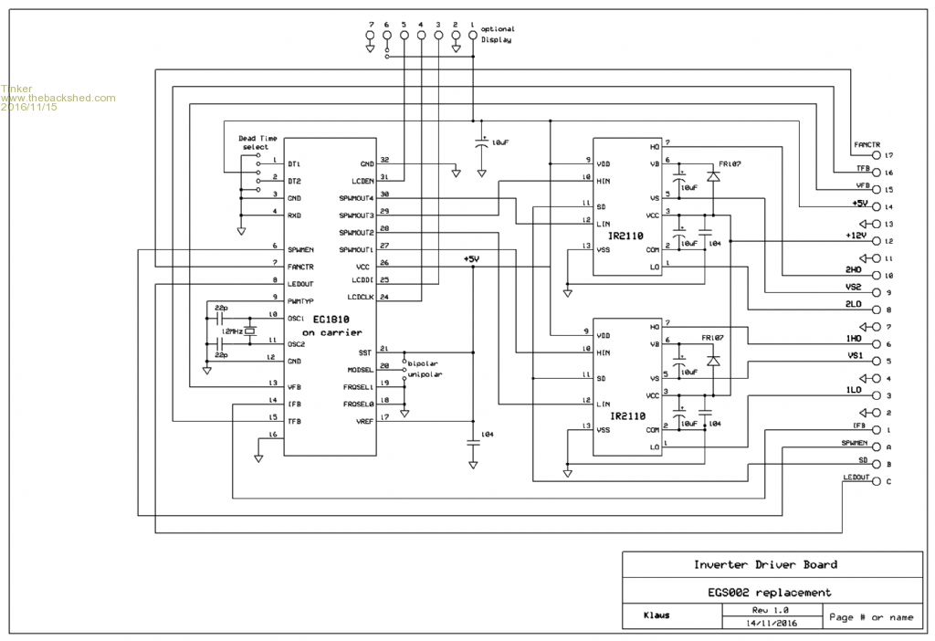

Being fed up with EGS002 boards that malfunction far too easily I have drawn up my own.
It is a direct plug in replacement but with less bells & whistles. The info for it comes from oztules driver board and data sheet perusal.
But I would like a thorough checking by somebody else, its too easy for me to make mistakes.
So, here is the schematic:
This is to be used in conjunction with the little mother board, the schematic of which I posted earlier.
Once it is confirmed that the schematic is OK I'll proceed to lay out a simple single sided PCB for it.

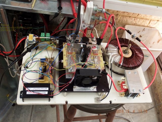

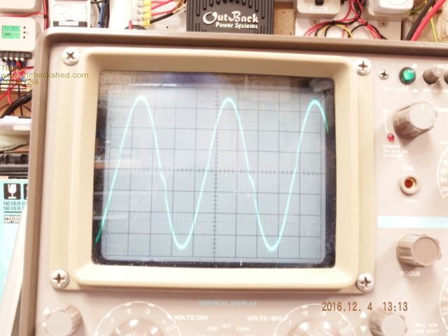

Today I managed to pass my target of 1KW load from the 4 Mosfet test inverter. I stopped increasing the load at 1150W load, the little toroid I'm using is from a 1200W Latronics LS inverter and most likely not rated for continuous 1200W.
After a while on 1150W the toroid reached 80 degree on the primary winding, I then reduced the load to around 600W, giving the winding a respite. It was running much cooler then.
The heatsink did not get warm at all, barely above ambient temperature and the little fan never switched on.
Here is the test set up:
And here is the oscilloscope trace at 1150W:
The little wiggle on the down curve almost disappears at no load.
I took that picture with the camera on a tripod and set the scene select to "fireworks". Seems to capture the whole trace but my ambient lighting was still a little too bright.
So what is different now? Well, the big break through came when I reduced the PCB tracks between the gate and its resistor/diode to virtually nothing. These parts now cannot be closer located to the gate pin.
Also, I gave up with the IRFB4410Z mosfets, they kept blowing up at >600W loads.
They were also not ideal with regard to leg size and spacing. I cannot understand why others even bother with TO220 devices on a high power inverter.
I now use TO-247 Mosfets (HY4008W/A). Only four per bridge leg will be used in the full size inverter, four of these having a larger current rating than the 6 x 4410 that others use.
They are no more expensive for a similar current, buying 32 x HY4008 is only slightly dearer than buying 50 x 4410's - double the required number to allow matching the on resistance.
With regard to on resistance, the HY4008 I got from Ali express were under 4mOhm, mostly around 3.5mOhm. Only two were a little over 4mOhm.
The only thing to note with these TO-247 chips is their odd (5.44mm) leg spacing which does not suit the snap in position grid of the simple PCB layout program I use. I could, however, tweak the pad location by disabling the snap in position feature.
The above test was with my last EGS002 board driving the Mosfets, there are 5 junked EGS002 boards lying on my bench now . These boards are not very robust IMO.
I am still progressing with the design of my EGS002 replacement board, its not as easy as it seems.
Oztules was either very knowledgeable or lucky when he got his board working first time. Track layout appears to make a big difference but I'm close now, waiting for some more driver chips.
Posted: 01:23am 04 Dec 2016
Oz certainly has something on his side that others of us seem to be wanting for.
Good to hear you have had a win with the gate modifications. I have revised my design again by reducing the pad size on the gates and the pins where there is no current flow. I have etched the board but have been busy installing an air conditioner. The board I am using at the moment has TO220 IRFB4110 MOSFETs and I got 8 KW out of it for 30 minutes with no issue. However I am only using them as they are cheaper than the TO247 version, when I am happy with how it is performing I will start using TO247 IRFP4110's I have. The AC I just installed can draw up to 3.55 KW, although it was down to under 1500W this afternoon when it was a little cooler. So I do need the Inverter to handle 4KW plus for extended periods.

Well Mad, you have beaten me now. I have had plenty of 8kw for 5-10 or more minutes, but never 30 mins continuous. So after some false starts, it looks like you ave it now.... your tenacity in the face of disaster is a credit to you.
Tinker, you results are looking very good too, and I hope it translates up to your monster you are going for.
I got some HY4008 for about$30/24. They measured in at 2.7MO... every one of them.
I too decided that the chinese make a mess of copying the 4110 american things, but should not bother/counterfeit their own. So it seems to be. There specs are identical with all 24 of them, and the lowest I have seen for RDSon so far... 2.7 is not too shabby at all.
I don't know how well they work, as I have not made a board for them as yet... may strip a clockman board and try them on that.
The Latronics transformer seems to be a bit under done for their rating.
Tinker, how is the current regulation doing at high power shut down, I am finding slight inconsistency in the scr locking off at the moment. What works fine on one board, needs slightly different resistors on another... no idea why that could be...
