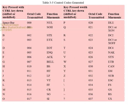

  TZAdvantage said   I still have to figure out the VT100 codes because that is what needs to be send to an MM. Arrow keys, function keys home, end, pageup, pagedown are all ESC codes but i can not find a good source of information.
It would then be possible to use the keyboard to edit programs.
Try these:
2015-09-04_190640_TerminalEscapeCodes.zip
Chris
http://caroper.blogspot.com/
Posted: 10:11am 04 Sep 2015
Thanks Chris. Just what i need.

What should we do with keys that are combined with Control.
Ctrl+C is obvious but which other ones would be valid and/or useful.
The program also allows for a RAW mode that sends every key to the output so i don't need to do all combinations.
I am particularly interested what it should do in VT100 mode and especially for when it is used as a keyboard for a Mite.
edit: found something with google. And yes it was on Geoff's site. of course!
Edited by TZAdvantage 2015-09-06
Posts: 10109
Posted: 04:53pm 05 Sep 2015
As far at the CTRL key combinations are concerned, I can't actually think of any other then CTRL-C, really.....
The others, like ESC/F1-F12/PageUP/PageDOWN etc, are not CTRL keys(in that you need to hold CTRL as well as pressing these keys), so I can't actually think of any others then CTRL-C. I welcome anyone mentioning any others I am not thinking of.

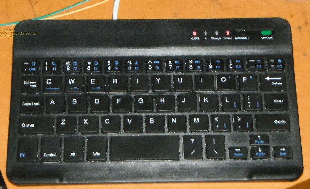

Yes, the connect button would be better. I forgot about that button.
Software is coming along slowly. There are a lot of combination keys on that keyboard. Especially with the Fn key.
Did you ever get this thing to work on a PC. Mine pairs and connects but can not get a single key out of it.
I wonder what the delete key should be.
A backspace when pressed by itself?, and a delete when you combine it with a shift?
I am almost inclined to see the word delete in blue so that a Fn+Delete gives a delete instead of with shift. Seems to make more sense when typing and is more in line with the arrow keys becoming home, end, pageup and pagedn when combined with the Fn key.
It does not make any difference in difficulty it is just that i think an Fn key will be easier to use to choose Backspace or Delete.

Posted: 05:17pm 06 Sep 2015
I see merit in using this keyboard for use with a micromite. It is compact, has a good matrix as we found out and it will serve its purpose very well.
As a keyboard for a laptop, TV box etc it is not that good. Bluetooth is shaky at best. I can get it to work on a Android phone, nothing else.
I have lots of stuff i use for testing my websites on and it does not work on most of them. So no this keyboard is not very well for use as it is advertised.
What i would like to accomplish is that this keyboard can replace a real keyboard for the micromite. Being able to edit, save and run programs should be just as easy as when you do it with teraterm. To get that to work it should emit VT100 codes. Also the function keys should work as those are used in the editor.
ctrl+c for stopping a program also. Navigsation with the arrow keys, pageup/Pagedn, home, end, backspace, delete, etc are all needed to make editing possible. It is not that difficult to do, but doing it in a structured way so that when someone wants to use another keyboard is more difficult. I would like to get it to work by just replacing some lookup strings.
Writing it in basic is so much more easy then doing the same in C. Only the very rapid, Edit, run, debug cycles alone are worth it. With C it is writing,compiling, programming the chip, debugging etc. A 100x slower process. The more i can figure out with basic the better. After that it is just a translation to C.
The chip i have in mind to use is the PIC16F1459. It has enough pins AND it has USB. I also have a working HID software for it, so it could also function as a USB keyboard.
One of the projects i want to do is making a small keyboard with just the keys i use a lot when programming. The keyboards on the current smaller computers often use an Fn key togeter with another to access the function keys. In wrinting and debugging software it would be great to have a little keyboard with just F5,F8,F10 and F11. Those are used often for run, step etc.

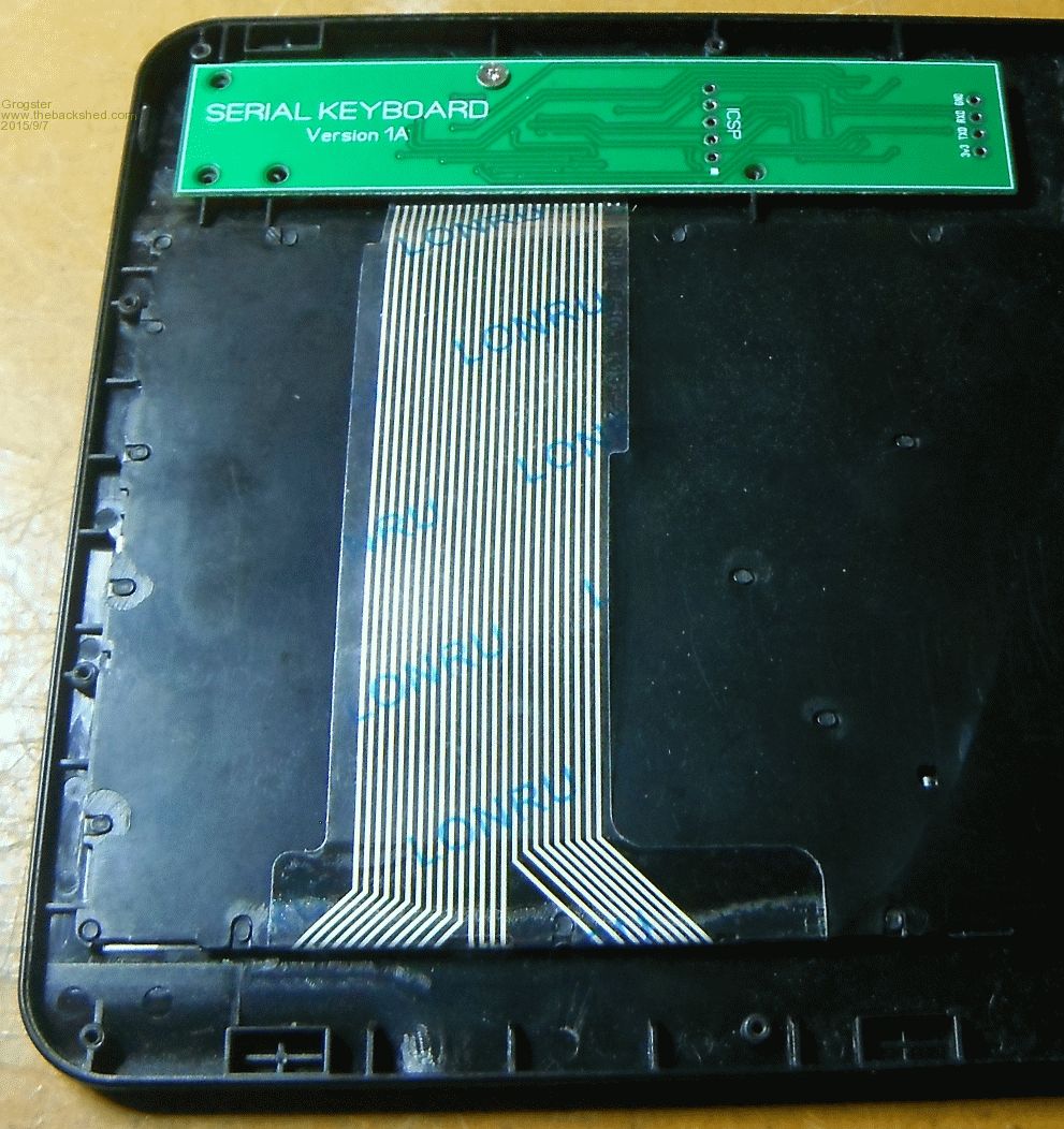

PCB's arrived tonight, so I will send you a panel tomorrow using the address you sent to me for the MM+ boards. They are a perfect fit for the original board, using the existing PCB standoffs. As with the original board, these ones are 0.8mm thick, so be careful not to snap 'em!
I hope to build one up tonight, and post some photos - it will be nice to get rid of all those jumper wires!!!!

Posted: 12:56am 07 Sep 2015
Replacement PCB in place:
Programmed and working with the current code.

Posted: 02:38am 07 Sep 2015
Well that looks easy.
Great fit! I look forward to make my own. (Of course no SSOP's) only dips en soics.
Want to trade me one (if you have spare of course) for a USB-Serial module as shown in the PIC16F1455 thread?
I am close to sending the design to the PCB house.
