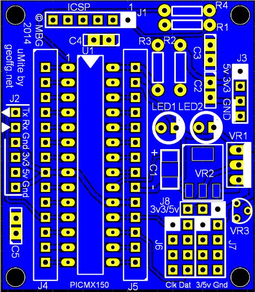

Lads,
OK This is the final FINAL version..
I have added the 2 bypass caps that WW suggested as well as a 100R resistor to protect accidental `bricking' of the PIC.
I am presenting this version for Manufacture now.
SCHEMATIC
2014-04-15_112013_mmite.pdf
OVERLAY
Edited by bigmik 2014-04-16

Now I have a question for the group..
Headers J4 and J5... Should these be female or male? Or user decide?
I gererally subscribe to male pins on PCBs as they wont wear out like female sockets can, but female would allow an LED or resistor to be poked in easilly..
Hmm, conundrums...
Posts: 2998
Posted: 02:57pm 19 Apr 2014
Mick,
Remembering this PCB was originally for your own use then assuming 'compactness' is not an issue I would consider doing the following.
Use short pin female headers soldered onto the board.
Then place enough 2-way male headers into these female to make each pin effectively a male header (yes they will be a bit tall - but thats why I mentioned above if 'compactness' was not an issue).
Now you have the flexibility - male where you want to, or female if you remove the relevant 2-way male header pins. I would avoid the use of single pin males as these would 'spin'. If however you need a single female (Im still talking about the headers! ) then use multiple male headers either side ensuring you don't have any single males. Hopefully you followed this! (A picture paints a 1000 words . . . . . )
OR (as something I have used very successfully for my own use in the past) is:
Why not use Long Pin Female stackable headers mounted on the underside of the PCB. Then you can use the long pins (which are sticking out the top) like normal male headers, and have the option underneath to have females for temporary plugging in 'things'.
This method allows you to then mount the PCB upside down into a breadboard to give more working holes.
Sorry Mick, just added MORE conundrums for you
Posts: 2984
Posted: 08:27pm 19 Apr 2014
Hi WW,All,
I understand what you say about single males and females (they are unstable and twist about too much)
What you say about the long female stackables could be done but the ones I have seen dont have square male pins and are actually flat `rectangular' shaped and dont reliably plug into female header sockets so I wouldnt use them.. These are like Arduino risers...
I am not a fan of mounting the females under the PCB unless it was going to plug into another PCB.. and Compactness is generally what I look for.
I am tending towards ALL Males on the PCB as the Female-Female link wires are readilly available and cheap. I was trying to get an opinion from what others would think about this. On thinking along this, it is of course entirely up to the end user and what environment it is going to be used for..
The fact that the J4 and J5 headers have ALL (except pin 20 Cap C1 +ve connection) it lends itself to a daughter board for USB/TTL relays, LEDs etc. But of course it could also have the pins/sockets facing down on the underside of the PCB to plug this PCB into larger PCBs and thus become a CPU module.. I dont see myself doing either but I am thinking of the possibility of a Training board such as Vasi displayed earlier for learning about basic and various hardware concepts..
If that was designed what would we wish to offer?
LCD? If so I2C or Parallel interface?
Various LEDs?
7Seg Modules?
Switch matrix?
Stepper motor driver?
Buzzers?
On board Logic probe?
But what market would you have? Is there a demand for such a beast for uMite? Should it be for a MaxiMite?
More Mick Ramblings....
MOBI
Joined: 02/12/2012
Posts: 819
Posted: 09:14pm 19 Apr 2014
@Mick,
  Quote  If that was designed what would we wish to offer?
Various LEDs?
7Seg Modules?
Switch matrix?
Buzzers?
Here I go again wrt I2C. I think it is underutilised and as we are dealing with a controller here, we don't really need lightning speed. Is it possible to dedicate the uMite I2C pins to a header so that an external bus (say 5 pin) could be connected to take care of functions listed above. I would also mount the pull up resistors on the external bus as "plug in" to cater for differing I2C speeds.
Just about every stand alone controller would need date/time and the RTC is already I2C so it is not such a big deal provide a bus connector to allow other functions.
The dedicated uMite keypad and LCD are great but don't leave a lot of pins for the outside world. If I were to pick one to fit to the test board, I'd pick keypad as it is "instantaneous" and transparent. The LCD is just as easy to drive in I2C form as the uMite version, also it is just as easy to swap to a 7seg if you want visibility and numbers only.
I have a few I2C designs in my stable that are easily vero-boardable and with source/hex code plus PCB layout if there is any interest in that direction.
David M.

Just wanted to post a quick update of the uMite Prototype Board, "Rev-B" that fixes the registration issue with the DFN part. (and the silly spelling on back)
2014-04-20_210350_uMite-28_Prototype_Board_Rev_B.zip
Take a look and see if there are any errors in there.. If not, then this one's a done deal..!! Next...
Thanks Gang..!
EDIT: Yep, another update... I was thinking, since orders for the board have settled down here at the shed, I think it would be a good idea to pack up the last 6 "full builds" with the 20 flats and send them over to Phil to slot up on the website... It will be a bit to get some "fresh" stock created and this could serve as a slight buffer for the shelf...
Took a peek at the gerbers...
They seem to be in order...
Edited by Zonker 2014-04-23

Posts: 2984
Posted: 09:49pm 22 Apr 2014
Hi Zonker,
  Zonker said   (and the silly spelling on back)
What silly spelling? I have looked at mine for about 10minutes and cannot see any spelling problem....
See I told you my eyes are bad.
Edited by bigmik 2014-04-24
jman
Joined: 12/06/2011
Posts: 711
Posted: 09:55pm 22 Apr 2014
  bigmik said   Hi Zonker,
Dounload should be Download
Jman
