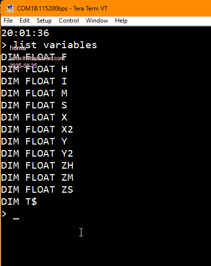

  ville56 said
  matherp said
There is a newline when I use it with teraterm or on the VGA or HDMI output
Sorry Peter, there are no newline ... please see attached screenshot with control chars visible.
List-vars.zip
That is astonishing ...
Matthias
Edited 2025-03-25 05:08 by homa

toml_12953
Joined: 13/02/2015
Posts: 740
Posted: 07:20pm 24 Mar 2025
  ville56 said
List-vars.zip
I get the same output as you do no linefeeds. I use TeraTerm 5.40 on Windows 11.
I tried setting the terminal New-line options but no combination of CR and LF changes it. My terminal ID is VT100.
Posts: 12176
Posted: 07:26pm 24 Mar 2025
Try again now
Worked on all versions with a console set up but not on the standard version without an LCD configured as a console
