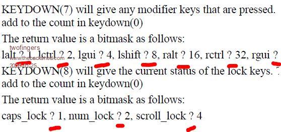

@Geoff
Are the question marks in the keydown description intentional? That seems strange to me. Maybe a typo? It's already in the manual for CMM2.
Kind regards
Michael
Posts: 3372
Posted: 06:41pm 24 Jan 2025
Thanks Michael,
I think that the question marks (?) should be equals (=).  I will check with Peter who implemented this function.
Posts: 12176
Posted: 06:43pm 24 Jan 2025
Yes: should be = and of course you can have more than one modifier key pressed
Edited 2025-01-25 04:45 by matherp
Posts: 3372
Posted: 06:49pm 24 Jan 2025
Also, thanks cosmic frog and disco4now.
Changes made.

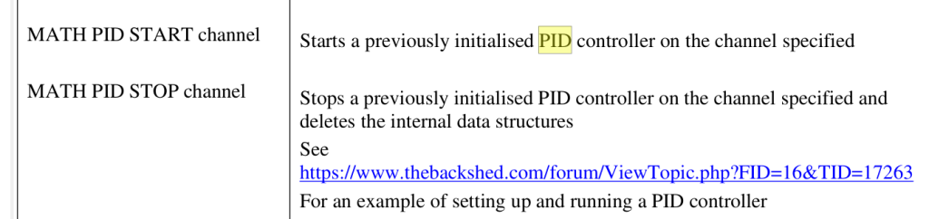

Hey Geoff...Not sure about this but is this still true?
I have a hard time keeping track but I remember "Eureka"

Also...not such a big deal but it bit moi:
MATH PID STOP: The manual shows a link to some example code that also has a MATH PID CLOSE
The CLOSE now generates a syntax error. Maybe a mention to ignore it or something?

  PhenixRising said  Also...not such a big deal but it bit moi:
There is so little on the forum that explains the use of PID control. Why don't you please add a post with the corrected code so that others may benefit?

  PhenixRising said  Hey Geoff...Not sure about this but is this still true?
That is one for Peter.
If I remember correctly, he had it working but with caveats.

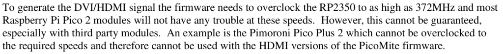

I would change it to
  Quote  To generate the DVI/HDMI signal the firmware needs to overclock the RP2350 to as high as 372MHz and most
Raspberry Pi Pico 2 modules will not have any trouble at these speeds. However, this cannot be guaranteed,
especially with third party modules. An example is the Pimoroni Pico Plus 2 which is marginal at
the required speeds and therefore cannot be recommended with the HDMI versions of the PicoMite firmware.
To give context 1280x720 needs 372MHz which works on my (one) example. High speed VGA needs 378MHz and I simply cannot get the Pimoroni Pico Plus 2 to run at that speed even upping the voltage massively and trying every possible tweak of the PSRAM timings.
Hi Bill,
It's not so much corrected as refined. In an earlier version, there was STOP followed by CLOSE. Now it appears to me that CLOSE was deemed redundant(?) and so STOP serves both purposes.
Example code:
I plan to share the complete motion-control package, including velocity-profiling and position control.
Problem is that there is almost a daily PicoMite revelation and they are always really good ones    which means I'm behind schedule.
MATH PID was only introduced after I'd been successfully running a Basic-only PID. MATH PID is far superior (fast) but right now I'm only playing with numbers and letting the interrupts run for days on end...Rock solid, BTW.
The way it's looking right now is that a single PicoMite can perform the same function as the US$1,400 commercial product that I have used hundreds of

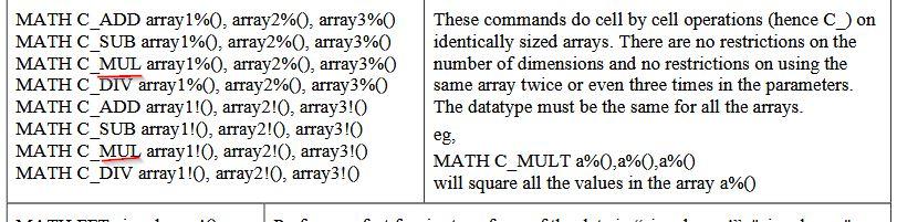

Peter, I don't have a PicoMite to test but I assume that the example is wrong. Ie, it should be:
  Quote  eg,
MATH C_MUL a%(),a%(),a%()
will square all the values in the array a%()
P.S. electricat, I will fix the description of RANDOM

Both MUL and MULT work.
> clear
> dim a%(3)=(1,2,3,4)
> math v_print a%()
1, 4, 9, 16
> clear
> dim a%(3)=(1,2,3,4)
> MATH C_MULT a%(),a%(),a%()
> math v_print a%()
1, 4, 9, 16
