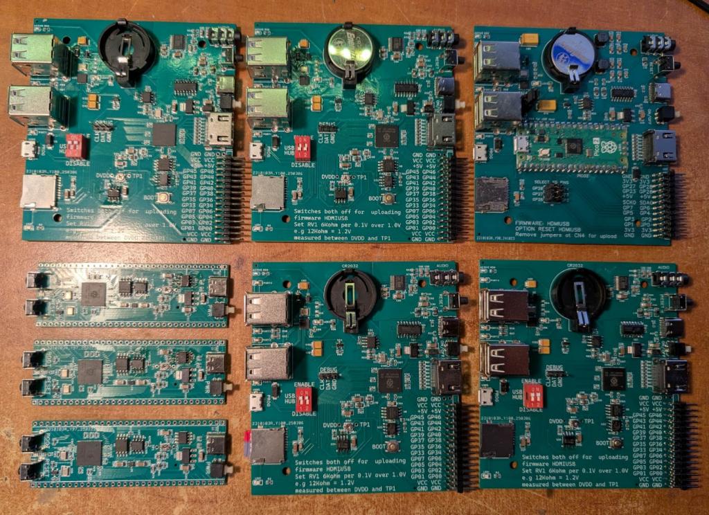

I'm now happy to release the design files for the 2B version of the reference design.
This has I2S audio and the rp2350B giving 22 I/O pins on the external header including all 8 ADC pins. The board is fully tested up to and including 1280x720 resolution with DVDD set to 1.3V
The overcurrent protection for the USB hub is disabled so it will work with all batches of the CH334F. There is a re-setable fuse on the USB 5V line so this isn't an issue.

There are two small changes from my prototypes. First, I'd lost one of the four  mounting holes which has now returned. Second, the external I/O header was too close to the HDMI connector so I have removed 2 VCC pins and reduced the header to 30-pins from 32.
Note that JLC/LCSC is still out of stock of the APS6404L-3SQR-SN PSRAM chip so you will need to source this separately and install it yourself if required.

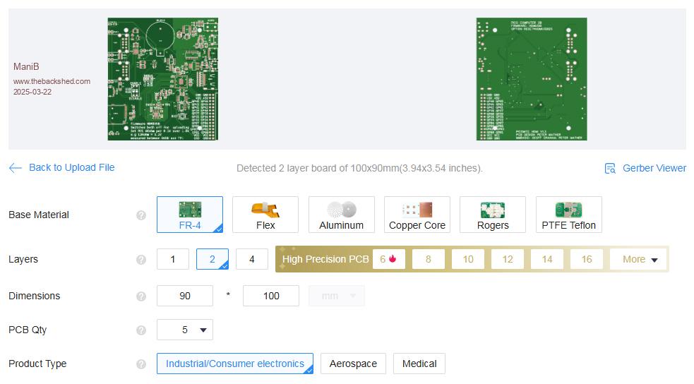

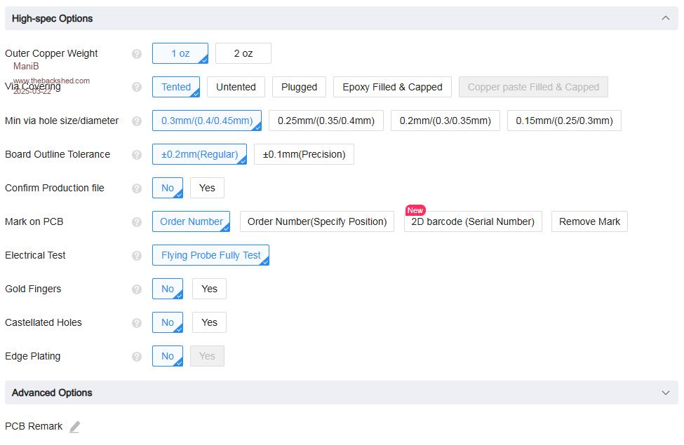

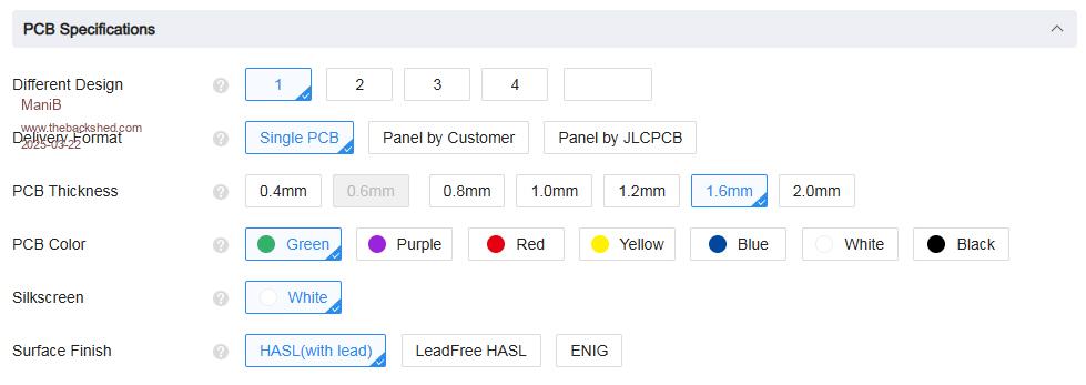

Hello Peter, many thanks for your great work.

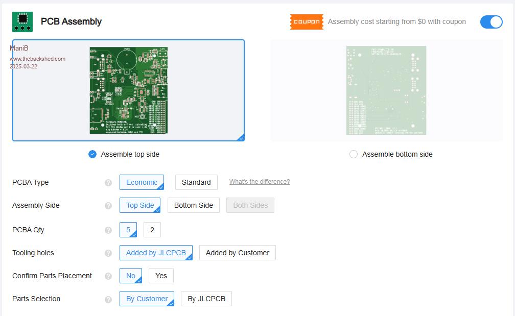

As already announced, I would now place my first order at https://jlcpcb.com/. I have uploaded the zip file of the Gerber files and adopted these settings.
Is that OK so far?
Posts: 12174
Posted: 07:56pm 21 Mar 2025
I just accept all the defaults so if you have done the same you will be fine. Of course you can change colour if you want - just slows delivery by a couple of days

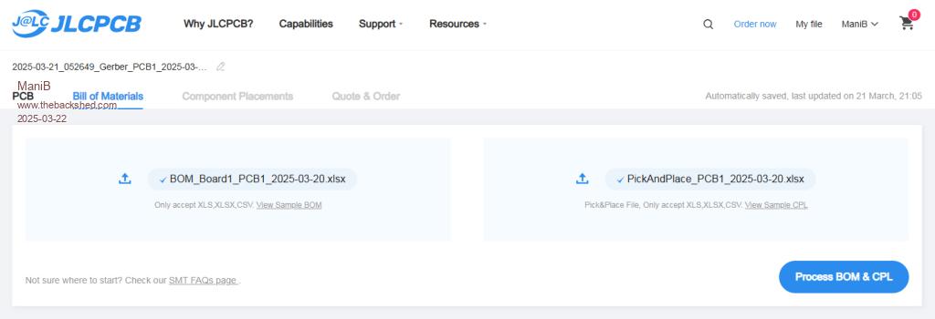

  matherp said  I just accept all the defaults so if you have done the same you will be fine. Of course you can change colour if you want - just slows delivery by a couple of days
OK, then it's actually very simple. Do I also have to upload the BOM and P&P files?
And what about the DXF files for end-plates for the box? Should I order them at the same time? Or is that not important at first?
Amnesie
Joined: 30/06/2020
Posts: 763
Posted: 08:24pm 21 Mar 2025
In the order process you will be asked for those files. The frontpanels are another order you have to place.

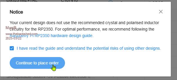

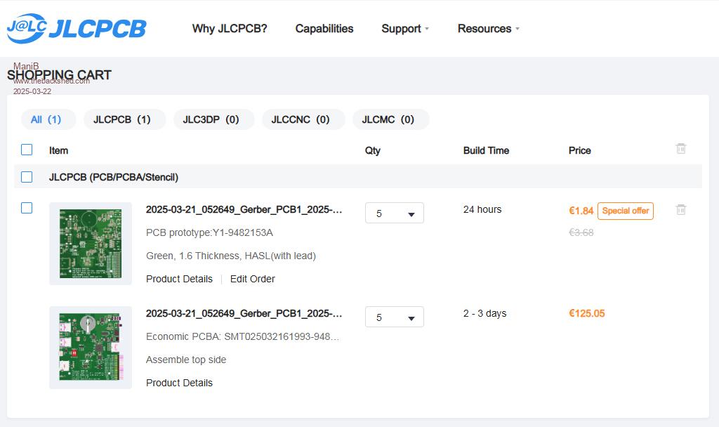

Ok, the question about the BOM and P&P has been answered.
This warning came up, which I ignored:
I now have that in my shopping basket. Do I have everything I need to order?

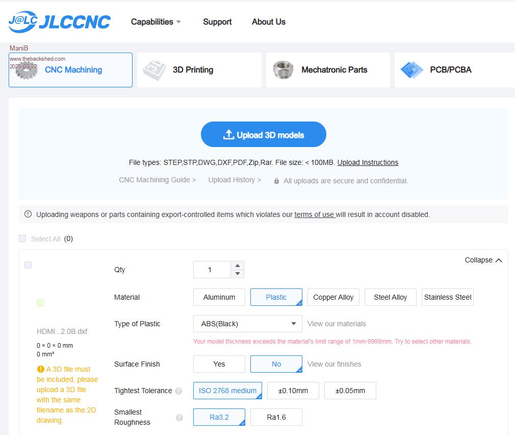

How do I order the DXF files for end panels for the box?
Is this done via ‘CNC Machining’ or ‘3D Printing’?

I have tried this with CNC Machining, but after uploading the .dxf file I get this message:

The dxf files are only the bare outlines of the panels. CNC Machining is the wrong thing to do...
Personally I would import them into EasyEDA and add some markings like text and so on... After that you can save it as an PCB and order it like a normal PCB.

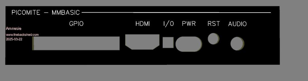

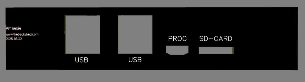

I created some panels as PCB from peters DXF...
Gerbers: (just order as normal PCB and IMPORTANT!! write in JLCPCB additional notes, that it is OK that there are no tracks, it is intended as panel only)... Without this additional note they often ask, if this is right... And you must select:
Mark on PCB Order Number(Specify Position) This way the JLC order number is on the backside silkscreen.

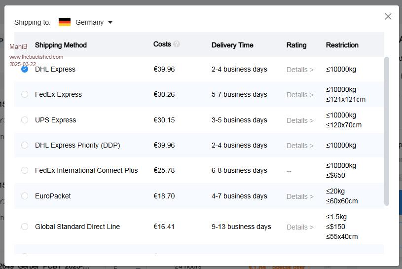

I have added front and back panels pcbs. Thanks Daniel.
Which shipping option should I choose?
