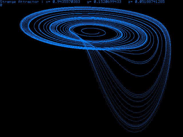

Posted: 09:54pm 25 Apr 2026
Rössler's Strange Attractor
A strange attractor is an attractive set in the phase space of a dissipative dynamical system, characterized by a complex fractal structure and chaotic trajectory behavior. Unlike conventional attractors (points or cycles), a strange attractor is not a simple curve or surface, and trajectories within it are unstable and exhibit high sensitivity to initial conditions.
MODE 1
Dim a=0.2, b=0.2, c=5.7
Dim x=0.1, y=0, z=0
Dim dt=0.005
Dim dx, dy, dz
Dim INTEGER i, x0=320, y0=110
Dim INTEGER CM(15)=(0,1,2,3,4,5,6,7,8,9,10,11,12,13,14,15)
Colour Map  CM(),CM()
Color CM(Int(Rnd*15)+1): CLS 0
x=Rnd
For i = 1 To 50000
 dx = (-y - z) * dt
 dy = (x + a * y) * dt
 dz = (b + z * (x - c)) * dt
 x = x + dx
 y = y + dy
 z = z + dz
 Pixel x0+x*26+y*8, y0+z*14+y*8
 If Inkey$ <> "" Then Exit Do
Next i
Pause 4000
Loop
Edited 2026-04-26 08:26 by javavi
