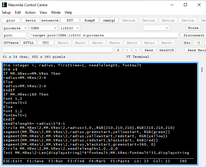

It's kind of hard to explain. I'll focus on one behavior I see.
I'm using a picomite, latest beta, latest MMEDIT and MMCC.
I have a program running. (note: It's using VT100 sequences for cursor positioning)
I'll give you an example.
If I CTRL-C in MMCC to get command mode back and I then enter EDIT mode, I can move the cursor all around, no issues it seems... but let's say I move the cursor to the end of line 14.
' References:
I move the cursor to just after the colon ":" and press the SPACE key to add spaces after it.
I suddenly get:
' Reference:' Reference:
Heck, that's not right... It's like when I press the spacebar... I'm getting chars from a line buffer pasted in somehow.  Makes editing difficult if not impossible.  The unintended characters always come from the current line.

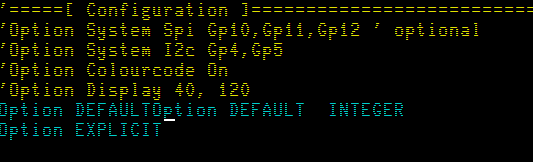

And it's not just end-of-line... if I go to the middle of a line and press the spacebar to add spaces... it inserts all the characters in the line up to that point where the cursor is.
I press the spacebar with the cursor between DEFAULT and INTEGER
Edited 2022-09-10 09:35 by pwillard
Posted: 06:01am 10 Sep 2022
Another update.
This one includes the Linux fixes.
Fixes a bug in picomite editor when OPTION COLOURCODE ON is set. When colour is turned on, the pico has to start at the beginning of the line whenever you edit it to determine the correct colours to use. The way the pico moved to the start of the line is different to the cmm2. Both methods are valid but I hadn't allowed for the pico method.
You now have to select the end-of-line being received - leaving it at CRLF should be OK for most uses.
Cosmetic improvements to the MMCC terminal display.

pwillard
Joined: 07/06/2022
Posts: 347
Posted: 01:07pm 10 Sep 2022
Thank You.  EDIT works again.

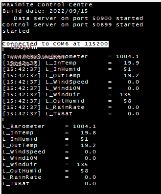

Posted: 05:48am 15 Sep 2022
Today's update is for the Linux users. Printing now works.
If you have colour set in the editor, the printout will be in colour.
Likewise, if you are showing physical line numbers, they will be printed.
Word-wrap for long lines is a bit brutal.
The other addition is the option to timestamp incoming lines of text.
It works well with print statements but not much use if you are sending VT escape sequences. The keep-alive sequence sent by the pico after 30 seconds of inactivity is usually not a problem.
