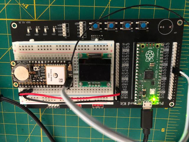

cdeagle
Joined: 22/06/2014
Posts: 273
Posted: 04:32pm 03 Jul 2021
Here's a picture of the PicoMite interfaced with an Adafruit GPS Featherwing. Thanks Peter.

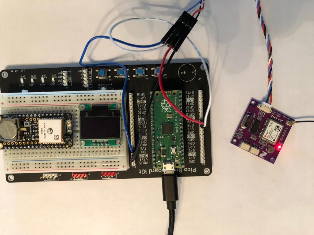

cdeagle
Joined: 22/06/2014
Posts: 273
Posted: 08:03pm 03 Jul 2021
Also works with the Zio Qwiic GPS module.
