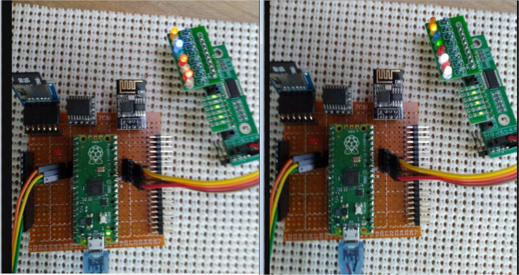

Posted: 02:02pm 07 Jun 2021
This works for me to flash LEDs on an MCP23017:
' MCP23017.bas
 const mcp23017 = &h20 ' A2, A1, A0, R/W all connected to 0V
 Const i2caddr=mcp23017
 const IODIRA = &h00 ' Port A IO Direction register DEFAULT = I/P
 const IODIRB = &h01 ' Port B IO Direction register DEFAULT = I/P
 const IOCON = &h0A ' IO Expander config register - address &h0B accesses the same register
 const GPIOA = &h12 ' Port A General purpose register
 const GPIOB = &h13 ' Port B General Purpose register
 const OLATA = &h14 ' Port A latch register
 const OLATB = &h15 ' Port B latch register
 const GPUPB = &h0D ' Port B pull-up register
 SetPin 14,i2c1sda
 SetPin 15,i2c1scl
 I2C2 open 100, 1000
 I2C2 WRITE MCP23017,0,2,IODIRA,0 ' set direction to output
 I2C2 WRITE MCP23017,0,2,IODIRB,0 ' set direction to output
'  I2C2 WRITE MCP23017,0,2,GPUPB,&h3f ' set weak pullups on all except bits 6&7
do
 mcp17
loop
sub mcp17
'  I2C2 WRITE MCP23017,0,2,IODIRA,0 ' set direction to output
'  I2C2 WRITE MCP23017,0,2,IODIRB,0 ' set direction to output
 print "write to mcp23017"
 for i = 1 to 6
   I2C2 Write MCP23017,0,2,OLATA,&b10101010 '
   I2C2 Write MCP23017,0,2,OLATB,&b01010101 '
   PAUSE     1000
   I2C2 Write MCP23017,0,2,OLATA,&b01010101 '
   I2C2 Write MCP23017,0,2,OLATB,&b10101010 '
   PAUSE     1000
 Next i
 I2C2 Write MCP23017,0,2,OLATA,0 ' turn all off
 I2C2 Write MCP23017,0,2,OLATB,0 ' turn all off
 pause 1000
end sub
Edited 2021-06-08 00:11 by lizby

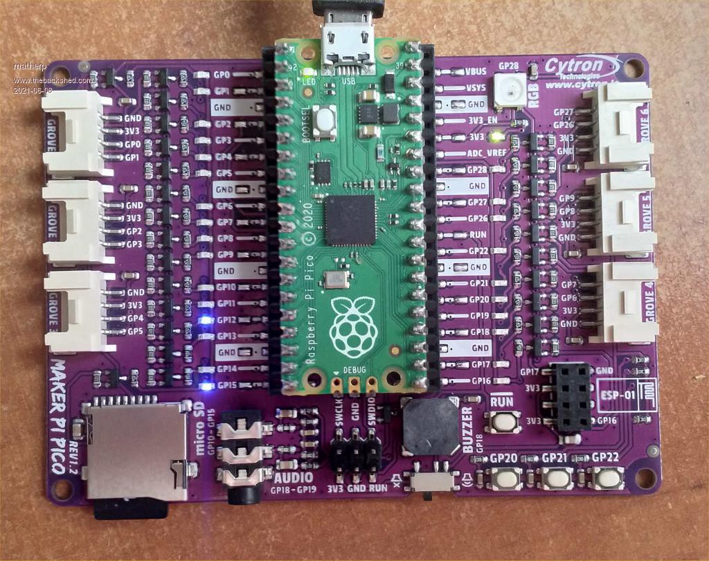

Posted: 11:50pm 07 Jun 2021
a21 SD working:
> OPTION SYSTEM SPI 4,5,6
> OPTION SDCARD 7
> files
A:/
     1280  benchmark.bas
    26240  ccpico.bas
    11008  gui.bas
       36  hello.bas
    15104  loadtest.bas
    20096  loadtest20.bas
    24064  loadtest24.bas
    27136  loadtest27.bas
     1444  mcp23017.bas
     4250  ta.bas
     4700  tain.txt
     1148  taout.txt
      171  test1.bas
       15  test2.bas
       43  test3.bas
       15  test4.bas
0 directories, 16 files

Posted: 12:40pm 08 Jun 2021
a22
"Minor fixes"
That's what we like to hear, Peter. lol
Thanks, that seems to be working a treat now.
Incidentally, I made a similar style SD breakout module to your own but omitted the supply rail cap. Power leads are pretty short so I figured I'd probably get away with it. It's working fine. :)
Posted: 01:03pm 08 Jun 2021
  Quote  MM.INFO$(PIN 24) gives PWM3A
I'm now using this
OPTION SDCARD GP15
OPTION SYSTEM SPI GP10,GP11,GP12
Edited 2021-06-08 23:04 by matherp
