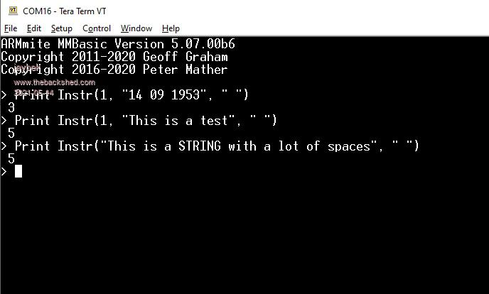

I'm running  ArmmiteF4 Version 5.07.00b12, and this looks like a bug to me

What were you expecting to see?
In all three cases the INSTR function returns the position , starting from 1, of the first encountered instance of the search string, in you example, a space.
The third example has omitted the optional start position so defaults to 1 and again returns the first instance of the search string correctly.

  jaybek said  ... this looks like a bug to me...
don't think so. 3rd character, 5th character & 5th character - looks good to me.

Yes, You are right. Sorry, but I tried to run the little program from 'Getting Started...' by GG, page 44, and it keeps erroring out. I wrongfully assumed that it was Instr() there were cousin it to fail.
But something weird IS happening in the 'Function GetDays(d$)'.
If you, just before the 'If'-Statement, print out the value of 's1', and the your input data is in the correct format, you will get the value '3'.
And then the next line 'If s1 = 0 Then', -  evaluates True!
I've bin coding in StarOffice Basic (Libre Office, Open Office) for more than a decade, and yes there are diffs, but this is a bit unexpected.

Sorry, - but I'm obviously a narrow sighted idiot at times:
My glasses has bin missing for a couple of days, and in despair over that i couldn't get such a simple program to run, I yanked it into Libre office Basic, and made the few tweaks that was necessary to make it run, but i did get the exact same error there!!!
Then it was time for a strong cup of coffe and there they were! My glasses (I hate them! The Elves! I've bin looking there several times!! (Sometimes i love them)).
Running the program again (this time without a cane stick) i realized that the input format was 'dd mmm yyyy' and NOT 'dd mm yyyy' witch i'd bin using the hole time, not paying attention to why there was a StringArray of  month-names.
Wow, this is embarrassing. I discovered that I can still blush at my age of 60!
I really DO hope you all can have a good laugh over this, and i haven't caused too much disturbance. A typical 'Error 40'!
