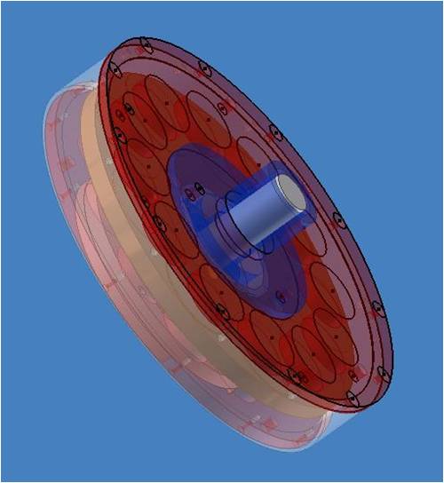

PS: I have 3D CAD modelled the new unit, so I can post some pics if required.
Here is a fully assembled view.

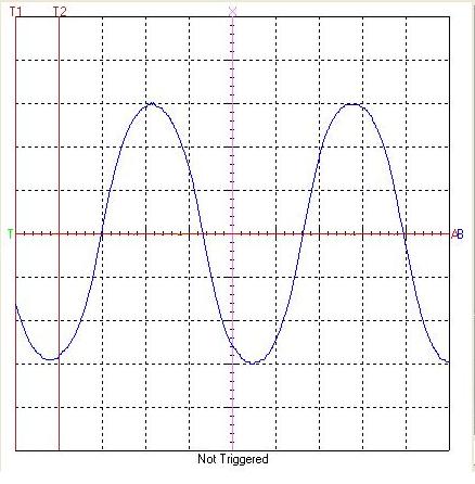

Here is a pic of the output waveform.

Well the waveform looks better than I had hoped for the magnet spacing.
Cut in looks good for low wind performance.

......you sure you need 24 bolts to hold the plates on....

  oztules said   Well the waveform looks better than I had hoped for the magnet spacing.
I was a little surprised as well. I had thought there would have been a little more flat topping. The coils are 2mm larger ID than the magnet OD. This has pushed the coil resistance up a bit. The stator should be able to be delta wired, so the resistance is looking pretty good for that.
  oztules said  Cut in looks good for low wind performance.
The cut in is a little low, for a star connection, so I will look at delta. I will bring all the terminations out, so I can wire any way. Bring out the coloured wire.

  oztules said  ........you sure you need 24 bolts to hold the plates on....
There are 12 x 4mm bolts on the rear plate, and 12 x 6mm bolts on the front plate, that bolt the magnet plates to the spacer ring. The front [blade mounting magnet plate] is bolted to the axle hub with 3 x 6mm bolts, and 3 x 10mm bolts. This is all that is left from the F&P mill. [The front plate, spacer ring, and axle, and bearing hub assembly].
Hopefully, the only machining that needs to be done in a complete unit, is in the spacer, and the surface that is welded to the axle to mount the stator assembly. I happen to mount the flat surface directly to my yaw box, so adapter spacers are needed to position the stator between the magnet rings, to suit the internals and the bearing hub, for clearance. I hope to test with thicker magnets and other stators, and should only need some additional adapters laser cut. No additional machining.

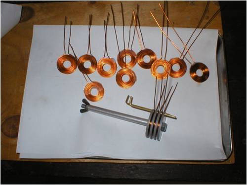

I would like to make some coils that are multi layer. I like the idea of 2 layers of wire coils, that are wound from the inside out, so both ends are terminated at the outside of the coil. This produceds non polarized coils. This will prevent the bunching of the wire that seems to be unavoidable when the coils are wound back and fourth to the outside. I think that very precise coils could be made, with possibly layers of glass between.
Gordon, is this the coil winding method you are talking about?
Or is it some other way I don't know about yet?

A bit hard to see from the pic. I am not new to this technique. I made my original overlapping/interleaved coils a long time ago, I will need to disect one I had spare, and see if the solid wire will work the same way. This is a long time project for me.

I made these coils some years ago when I started building a miniature AXFX. It was to be a triple rotor/ dual stator affair - unfortunately I got the coil connections wrong and they are all epoxy encapsulated. Project abandoned...
The coils were for 15mm dia neo magnets. Wire size is 1mm, coil thickness is only 2mm (2 layers). Winding is started from the middle of a pre cut piece of wire and requires a former like the one in the picture.
Your comment about "non polarized coils" with this technique has me wondering just what that means. Care to elaborate?
