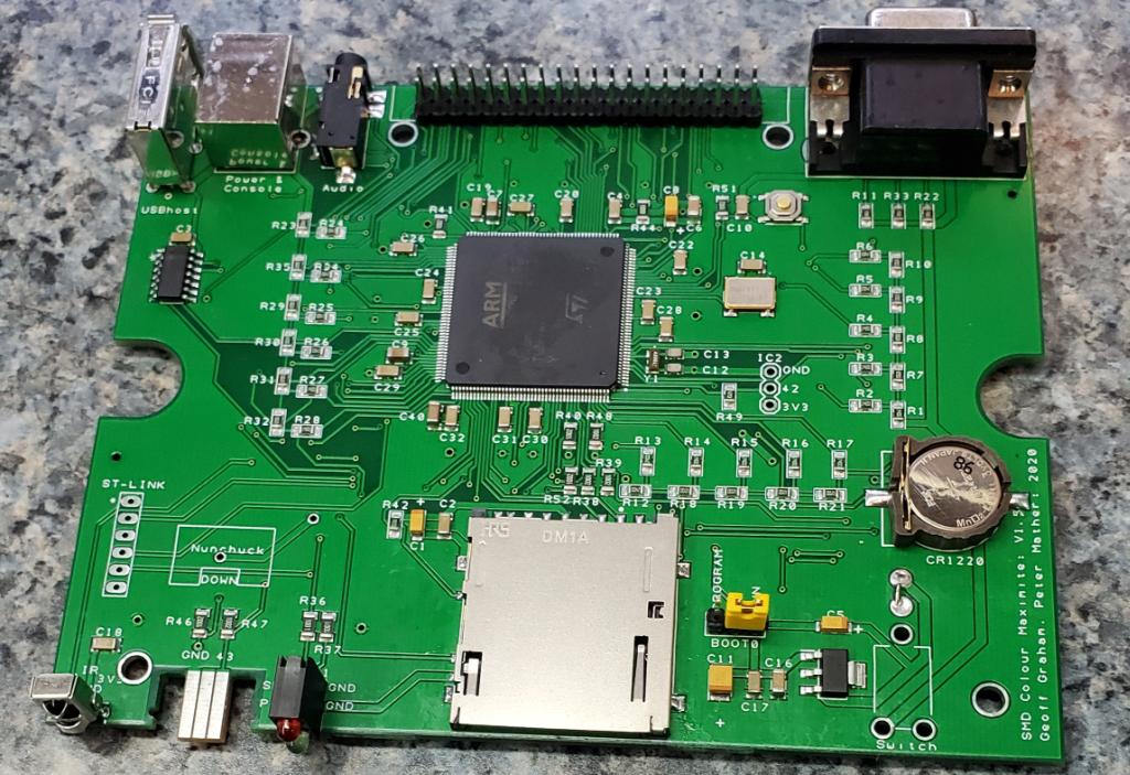

  Quote   At this point the only thing that I can suspect is that the processor chip (rev Y) that JLC is stuffing has bad internal RAM.
Send me a "bad" board and I'll test. Can't see a better solution. Email me direct and I'll let you have my address
This is pretty painful. I have customers waiting for shipments.
I have to make the decision to either refund their payment or ask them to wait perhaps weeks.
WW and Grogster - have you built boards partially assembled by JLC? Do they retain options?

The boards that I can't get to stick to "US" also cannot access the SD card. They all have 3V batteries and the path from the battery to the processor pin is fine.
The difference is that they are not waveshare boards. They are the version 1.5 board with the surface mount parts put in place by JLC.

Exactly! The design is the "same" but the implementation is different.
OPTIONS are stored in this battery RAM. I don't know what else is. That is why I suspect that the RAM isn't right. It's a possibility. Bits stuck either high or low? That RAM is important enough that testing it on powerup might be prudent. It's only a few k.
What else could be wrong? The 'CUBE' programmer? I updated it. Residue? I used Trichloroethane to clean the board and give myself cancer. The big RAM passes the minimum RAM test.
