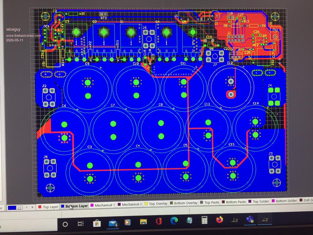

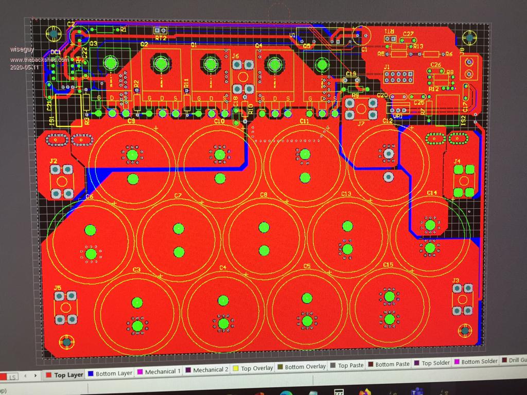

I wanted 3 Fets for a job - you dont have to load the 3d one, the finished board size is 190mm x 140mm.
I also only used 4 caps for the output - I reckon that is plenty. Just noticed 2 little glitches where tracks join to ground plane, now fixed.
Input from solar on the left output to Bat on right, havent run the rule checker yet - still a bit left to do.

It looks a bit sexier in colour, here are 2 screenshots. I included the separate 12V connector Az asked for. The noisy and quiet grounds are tied together in the upper RHS where a 0.1" and 0.2" spaced pads are allowed for a ferrite bead if needed.
This was definitely more fun than sorting out my workshop.......

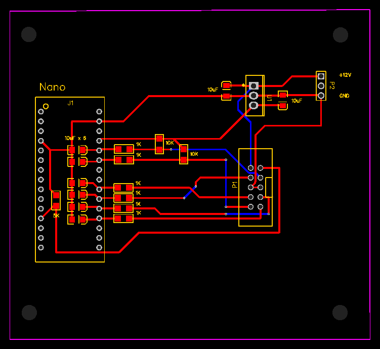

here is the first hack at the brainboard PCB.
I like the very short tracks from the low pass filter to the ADC pins.
All I want, really. The rest just needs to work well enough.

Posted: 06:07am 12 May 2020
I will repost this when it is fixed.

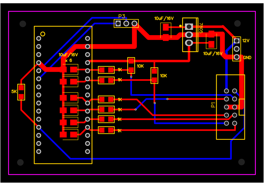

here is a better attempt.
The board is only 75mm x 50mm
$5 for 10, I think I will order them.
There is a connector for 2 user switches. Maybe only need one for EQ.
Just give it 12V referenced to battery ground and go.
Edited 2020-05-12 16:26 by poida

OK Take 2 the first scheme had a fet/diode issue so I added a relay instead.
Good effort Peter - layout scheme is electrically good.
