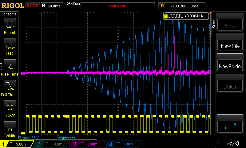

I used the above trim code make the toroid hum during a fast soft start.
Dark Blue is AC output voltage
Pink is primary current
Yellow is 50 Hz sync pulse
We can see a sudden increase in current near the end of the start ramp.
This causes the noise.
What causes the current increase?
The output voltage is under the influence of the low pass filter
on the feedback voltage. So there is some oscillation of output V AC
Most of theses current pulses occur before output AC reaches setpoint
so it can not be resulting from the slowed control loop + oscillation.
I use the filter in this code since WG needs the filtering in his design.
The nanoverter build includes an active filter on the feedback voltage
and so does not need the digital filter as well.

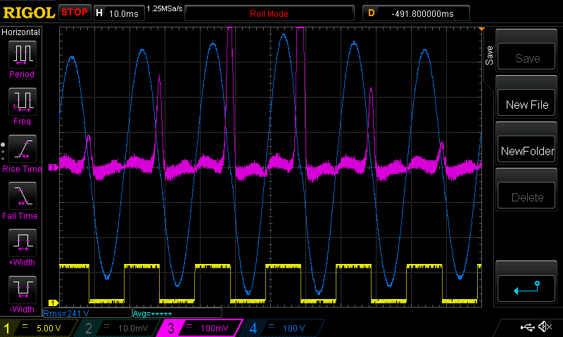

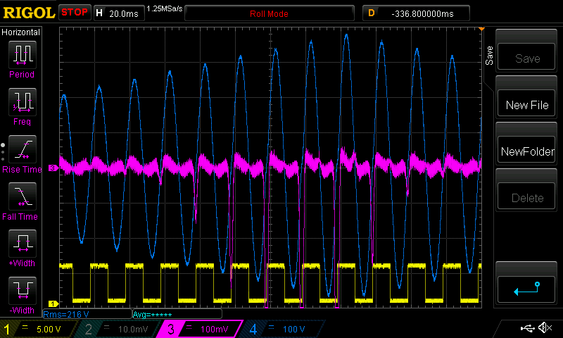

and here I can show what -2 and +2 trim does to my test inverter.
first -2 trim
The primary current pulses coincide with negative going zero crossing
of the AC output.
next +2 trim
They now coincide with positive going zero crossing.
In both cases the toroid makes loud hum during this time.
When I revert to zero trim, the toroid is nearly silent as in the above video

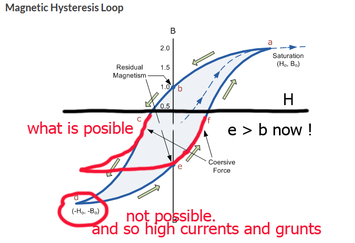

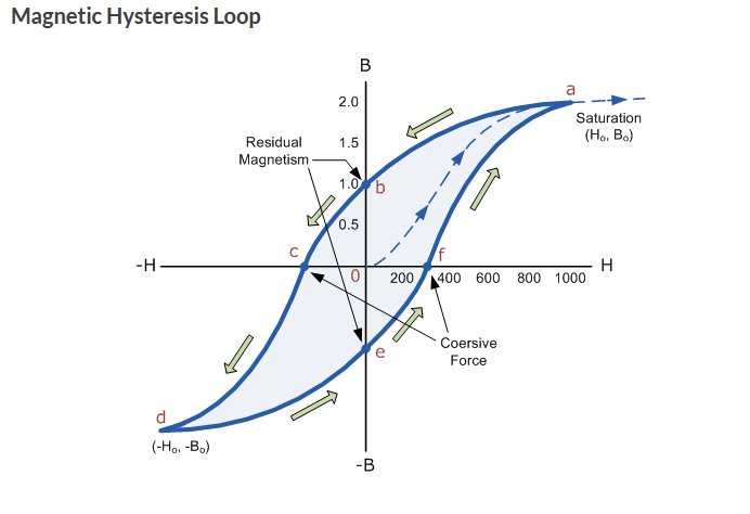

A toroid transformer has a characteristic curve that shows the
magnetising force verses the resulting magnetic flux density.
We all have seen this before.
I like to view H as the current flowing in the primary winding.
B is magnetism in the core. (or magnetic flux)
After a high power thump of DC, due to a failed inverter power board
the core will now be altered. It probably will have some residual magnetism.
I also think the core will also have altered B-H curves for some of the
micro-domains. The alteration will mean
some domains will permanently retain some magnetism to some degree
Note that the H axis is shifted UP from it's previous zero location.
This reflects the permanent magnetism within the core.
With the shift upwards of the H axis, the amount of current needed to take the
core into saturation is less and it reaches saturation earlier in time.
And so it spends more time saturated to a large amount,
presenting a high current load to the power board. And emitting the grunts.
Since we can have large current spikes during one zero cross
and not have them during the corresponding return crossing
I am forced to think that the core is presenting
a different load to the applied voltage coming out of the inverter board
for the two zero crossing events.
This is why I describe it as non-linear.
Maybe I should say non-ideal?
Examples of the large current spikes were given in a previous post
https://www.thebackshed.com/forum/ViewTopic.php?FID=4&TID=11384&LastEntry=Y#176583#176519
The remenent magnetism resulting from hysteresis is not to be confused with
the small proportion of core micro domains that have now a permanent
magnetic field to some degree resulting from the power board failure
and subsequent large DC current pulse.
I am also open to the idea that the entire core may have non symmetrical
B-H curve slopes now, also resulting from the DC current pulse.
I probably dropped a few clangers here. Sorry.

When we interrupt the ramp down, mid way down to zero power, by pulling D8 HIGH
we are starting the inverter.
Since init_done = 0, upon inverter start we will execute init_vars() once and record that is has be executed to prevent repeated execution of this code
init_vars() will set sst = 0 and that will set output power to zero
immediately after the next run through the control loop.
This is where you could have a large and sudden discontinuity in primary current or power.
In summary:
start it up, let it run for a few seconds or weeks or years.
Stop it when you want. Do not interrupt the stopping process
All good
If you have it running, in either ramp up or stable under PID then
stop it BUT DO NOT ALLOW IT TO STOP COMPLETELY, then resart it
there will be a discontinuity in output with growls etc from the toroid.

Thanks for the code explanation - it wasnt clear (due to my (in)ability to read code whether it went through init vars from an interrupted soft stop.
Now I need to use the same emphasis you did so I know it cant be wrongly interpreted - please dont hate me THE INVERTER NEVER GROWLS FROM AN INTERRUPTED SOFT STOP despite the interrupted decaying envelope that was rudely interrupted.  IT ONLY EVER GROWLS FROM A COMPLETE START UP either from cold or after running quietly and then a full soft shutdown followed later on by a restart.
Cheers Mike

The saga continues unabated.
Inverter has been reassembled and started a few times and I did a video of the Startup Rev1
The behaviour is essentially exactly the same.  The startup time was set for 200 - by the way Peter thanks for the tweaks you added at the top for the various settings changes makes all this to-ing and fro-ing so much easier.
The jump at startup can be seen to be ~ 0.9A which given the slowish analog meter could be somewhat higher than that.  Next I decided to double the startup time to 400, the peak current (and grunt loudness) is tamed a bit better to ~ minus 0.35A max at the grunt but here I noticed something new, when I stopped the inverter I watched the clamp meter rise to ~ plus 0.35A towards the end of the ramp (ramping down).  You can see it in the above video, despite the video startup setting of 200 not 400..
I am pretty confident this might be the smoking gun (apologies to AB), could it be that startup eventually adds to the remanence left during soft stop,  until it saturates in one direction and the remanence is eventually neutralised by roughly an equal amount of energy that created it, causing the grunt ??
I dont have an answer to why it does not grunt during soft stop except that the energy is reducing instead of increasing and we are not saturating on soft stop, the energy is decreasing but also causing some significant remanence ?
I also dont have an answer to the issue that if I enter soft stop and then interrupt it when the current is between 100 & 200mA when it next ramps up there is no grunt or discernible DC offset current greater than ~ 50mA.
It has been an interesting endeavour to totally change the sample and hold feedback to a more conventional feedback and the behaviour is essentially identical to the previous method. The noise fix on the V reference seems to have made no discernible difference in the operation.
