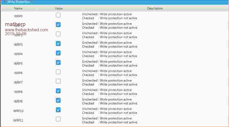

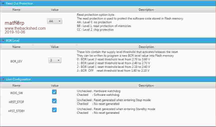

Posted: 05:39pm 05 Oct 2019
To program option bytes use the OB tab on Cubeprogrammer. Mine as follows:
NB: WP values seem to be different each time I read them but in essence there should be no WP
Edited 2019-10-06 03:50 by matherp

My chip must be defect. Each time i read the write protection flags, the bits are different. Either through usb or through serial. This was the last try. In the bin with the F4. But I am becomming more and more charmed bij MMbasic, so I ordered a pi zero. No ADC, but fast.... only wonder how fast it boots with raspbian buster lite. And if you can run it headless after configuration is done. New challenges. Grogster made a board for the pi zero. Ill look into that one.
Thanks all for your help. But it seems all energy in the world cannot save this chineese F4 monster.
