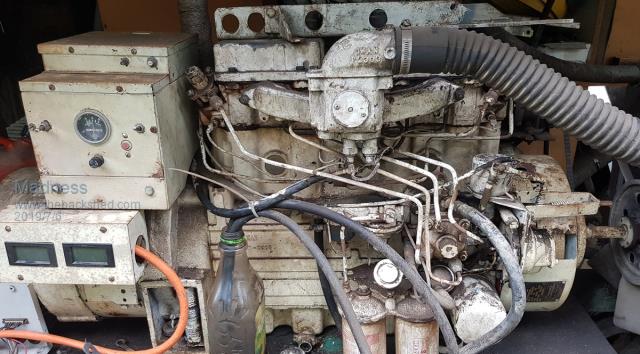

Here is the Onan 10KW, it started life as a marine generator and will make 10KW all day long every day. I rebuilt it after the previous owner thought bypassing the low oil pressure cutout would fix it rather than adding oil. Been sitting quite few years, I originally intended to convert it to run off woodchips. Since solar has become so much cheaper I have given up on the wood gasifier. It will be modified though to run off filtered hot cooking oil, just need to start on Diesel and shut down as you can't start with cold cooking oil.

I have an old Onan generator also
I am very impressed at how easy it is to work on and how well made it is
I think it was made in the late 70s

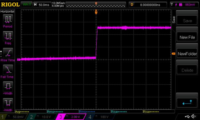

I have experienced a couple of times using the nanoverter board
that after power on things don't work.
I have had to reload the program into nano1 or nano2 for the board to function.
Why is reloading needed?
The Atmel specs show on page 313 (of the ATMega328P specs )
that voltage on any pin except reset to be -0.5V to Vcc+0.5V
and Reset to have -0.5 to +13V
All voltages are measured to ground.
So, no pin to be less than -0.5V to ground.
Let's see the 5V pin (measured to ground, with low noise probe fu, on nano2)
on my two nanoverters.
The first board, using a simple DC-DC 60V to 15V down converter using the XL7017 buck controller, has a reasonable 5V supply for the nanos.
This 60V to 15V converter is NOT isolated. It also can only deliver about 0.5A or less, not enough to power the fans. It runs the inverter fine though.
zero volts, then I apply 50V to supply and we see it go to 5V with no dips or peaks prior to the steady state result.

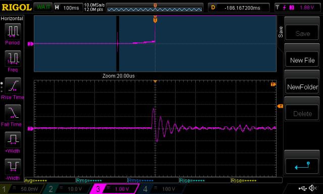

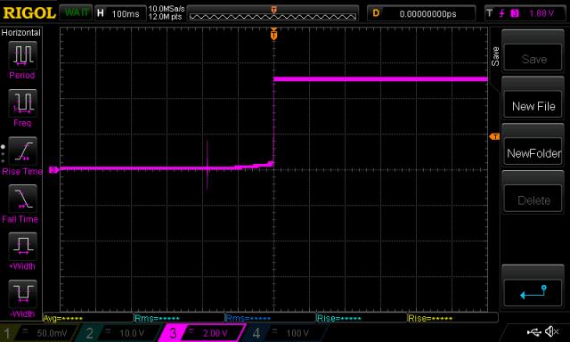

Next we see the 5V supply, on nano2, using the part suggested in the manifest.
This is a flyback converter, which produces an isolated output of 15V.
What is that before the 5V is established?
Let's zoom in to that.
Negative voltage on the 5V supply pin of at least -1.0V to ground.
This exceeds the MINIMUM voltage as specified by Atmel.
And so there is good reason why I need to from time to time reprogram one or the other nano.
I suppose we need to put a low Vf diode on the 5V supply to clamp it to no less than
-0.5V
What say anybody here?
By the way, each and every time I apply the 50V supply to the flyback converter, it produces this negative spike. I don't like it at all and I suspect the 2 linear regulators would much prefer not to see this -1V spike as well.
