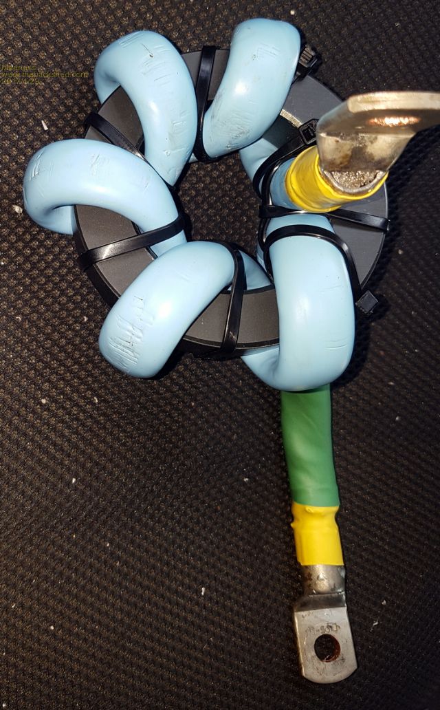

I am going to use the welding wire on a Ferrite Ring 100X65X20, it could take wire up to 30MM diametre. Using this with a single core Toroid I could get idle current down to 0.26A with 6 turns on it. I will get 90MM square wire which will wrap around the ring very easily. Once I get this Inverter sorted out I am planning to build another and use 90 mm wire for the primary, the 70mm I have on it ATM has room to spare and the wire can be compressed to fit more turns around the in circumference if needed. The OD between 70 and 90 is only a few mm.

I got some 95 mm welding wire today, that fits comfortably with 6 turns in the ring. But I have not had time to run it yet, I have Wednesday off so will get to it then.
In the EG8010 data sheet they show using two chokes for a bipolar setup rather than the unipolar setup we are using. If you have not done it have a look at either side of the choke with your CRO, there is some serious white mans magic happening those things.

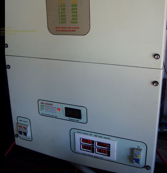

Have not progressed too much further, the darn thing works too well.
With the 4u7 clipped off the VFB, and a small ring with 5 turns for the inductor, the thing ran 5kw and was virtually silent. 6 fets/leg 4011
No I don't know why, it is just perfect.
This is using the inspire boxes... the curves were a problem but not any more.
It is running over 5kw, very very quiet, and the temp seems much lower than I remembered before the small changes.
Will try to get more sens out of it/me tomorrow.

Hopefully that picture above will help those using inspires... the curves are not a problem.... just chop them off, and join like the aerosharp boxes.

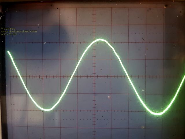

You are right again Oz, (don't know what you are doing??? must be hard to be humble when you are perfect in every way, at least I think that is how that song goes) finally was able to pay around with the Inverter again after injuring my back and was out of action for a week.
By removing the choke all together I got a really good waveform regardless of the load on it. But any of the chokes version I tried today gave various levels of blips at zero crossing through to quite large spikes that affected the waveform all the way to the peak.
I will spend some more time on it tomorrow to see if I can get to the bottom of it.

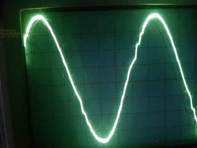

The Inverter is running again, still not perfect as per the picture below and this can only be achieved with the maximum dead time. Short dead time results in nasty spikes and MOSFETs blowing to pieces.
It has been running like this powering the house for 4 days now without a hiccup. It even runs my abrasive metal saw perfectly that my old Trace 4.5KW refuses to start and shuts down with an overload error. I even did some welding today but only 2mm plate so not big current draw. But I have had it running 5-6 KW continuously for a couple hours with my 10 KW (3KW consumption) AC and 2400W hot water system running. The 4 X 140 MM fans were running but not fast enough to hear them. The vertical configuration seems to work well with natural convection, running up around 2 KW with 25 degrees ambient the fans are not quite on but the natural airflow out the top is quite obvious if you put your hand above it. Mid afternoon with 35 degrees ambient will get the fans running with 1 KW continuous load, fans are set to start at around 45 degrees. Overall efficiency ranges from around 90% to 95%.
Next step is to add the Totem Pole drivers to the power PCB MOSFET gates and see if that improves the waveform. Nothing else I have found has resulted in a nice clean wave other than half the MOSFETs which is why I am suspicious that it is it something do with the gate drive.
The 100mm x 65mm x 20mm Ferrite Ring with 6 turns of 95 square mm welding wire has worked well and gives me about 20% less idle current than the E type which is now >40 watts with the big double core toroid. It is quite a bit bigger than it appers in the photo.
