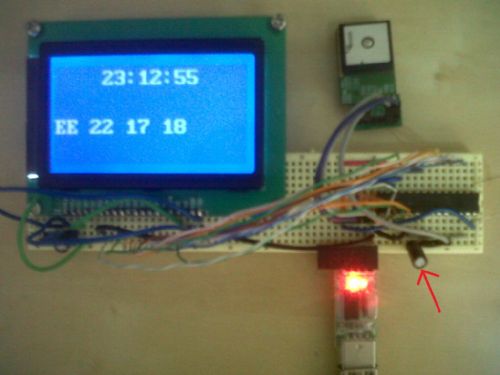

Hi,
I've had my PIC32MX150 working for a few day's if you look at the photo, you can see I'm using a 47uF 16V electrolytic.
I'm powering the whole circuit from a USB to serial TTL interface that has a 3.3V and 5v output, the USB interface is plugged into a powered USB hub that keeps the whole lot running 24 hours a day.
