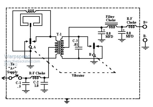

Back in ancient times before semiconductor devices, everything used valves which needed to be run from a high voltage dc power supply.
For things like a car radio that only had the 12v car battery, a thing called a vibrator power supply was used. You might even remember those from your youth.
These had vibrating contacts in both the primary and secondary side of the transformer that worked together synchronously. The contacts in the primary generated an alternating square wave, and the contacts in the secondary converted a higher voltage square wave back into dc. Mechanical rectification if you like. There were no silicon diodes in the very early days.
Now the curious thing about this is that if you could keep the vibrator going, the whole thing is completely bi directional. This is what Wiseguy referred to earlier as "a dc to dc transformer".
If we replace the vibrating contacts with mosfets, we can achieve the same effect of having an isolated dc to dc power supply that is completely bi directional.
One side chops up the dc into an ac square wave, and the other side acts as a synchronous rectifier turning the ac back into dc.
If the transformer is 1:1 ratio and we have two battery cells, one on either side, they effectively become solidly linked in parallel, but without any direct galvanic connection. Power will flow from the higher voltage side to the lower voltage side until the voltages become exactly the same. And the effect is completely bi directional.

Posted: 10:49am 02 Jul 2018
So you could link 16 cells via 16 1:1 windings and they *all* assume the same voltage?
Sounds like black magic to me but I believe you.
Is that 'same voltage' the average of all cells?
And how much or little by way of Amps is there being shuffled around? I suppose that depends on the cell voltage difference and the 'shuffled' current drops to zero once all cells get to equal potential?
I suppose this method would work a lot quicker than my present 'relay shuffling' where each cell gets connected only once every 56 seconds to get a measured boost, depending how much, or little, it needs.

Posted: 10:38pm 02 Jul 2018
They will "try" to all assume the same voltage, but if the cell capacities are greatly different that can never really happen throughout the full charge/discharge cycle. It might just settle down to having some average mean cell voltages that are still different to each other, but not by as much.
The current flow is going to be determined by the internal resistance of the switching circuit. Mosfet rdson and transformer winding resistances for example may be made fairly low, but can never be zero.

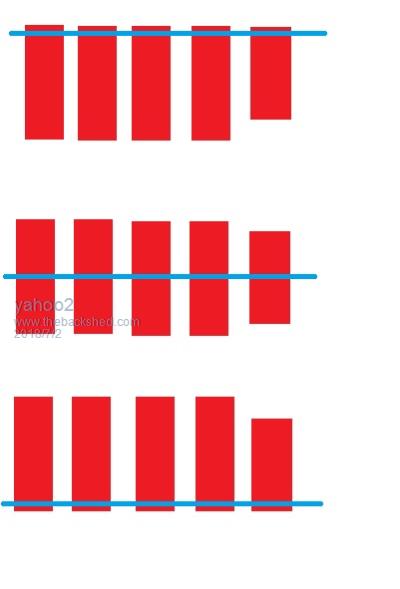

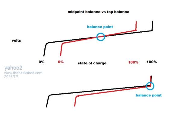

I have obviously done a crappy job of explaining this, maybe I can do it with pictures.
the red line is a cell with less capacity than the black line (rest of the cells). If I balance at a specific state of charge all the cells will be at that voltage EVERY CYCLE and the smallest cell will always hit full or empty before the others.
We need to chose a voltage to balance very close to the top and stick to that voltage so that all the cells hit the "knee" together. Then we trigger our low voltage disconnect before the smallest cell gets to the bottom "knee".
with really old cells I would prefer to balance at the bottom and stay away from full charge but solar being what it is there are almost no opportunities to bottom balance a battery bank.

Thanks Yahoo2 - I think I get you now - a picture is worth a heap of words, but it raises another couple of questions for me.
How do you know the weak cell is at its midpoint of capacity - is cell voltage a relatively reliable indicator of remaining capacity ?
Your method sounds a little like a type of equalisation where you try to set the string capacity midpoint to match the weak battery capacity midpoint. But it appears this also reduces the capacity range for the whole bank ?
My understanding is that an active balancer would give one the best results at all points along the good batterys capacity curve.
All the "better" batterys will assist the weaker battery as far as delivering capacity to load (they would all contribute to the capacity loss of the weaker battery by slowing its progress to low end point) - all cells ideally reach the exhaustion point at ~ the same time. When charging the weaker battery (without balancer running the weak cell would peak out earlier), but the balancer now works in reverse and shares any minute over charge on the weak battery between all the other cells until the ideal total string voltage is reached.
I dont see it as driving the poor little weak battery harder whilst cycling but rather helping it & slowing its demise whilst minimising capacity loss for the whole string. Edited by wiseguy 2018-07-04

  wiseguy said   Thanks Yahoo2 - I think I get you now - a picture is worth a heap of words, but it raises another couple of questions for me.
No , you have it backwards, I am saying DONT balance anywhere away from one end or the other. choose one point and stick to it.
Perhaps there are some things you wont understand until you run a battery bank hard and your active balancer will not keep up and you cook your first cell, or worse, cook someone elses.
Lithium cells dont always give you nice slow absorption cycles, I have seen banks charge for forty minutes and the taper at the end is 12-30 seconds if you are off by even 2-3 watts at the end and you are measuring total bank voltage to control the charge rate, it will not see one high cell you are going to have to dissipate 100-200 amps. The individual cell high voltage disconnect is supposed to be a failsafe not a regular event.
Yes I know that new perfectly matched cells can run for years with nothing keeping an eye on them but this is a DIY site where cheap old mismatched gear is catered for.
