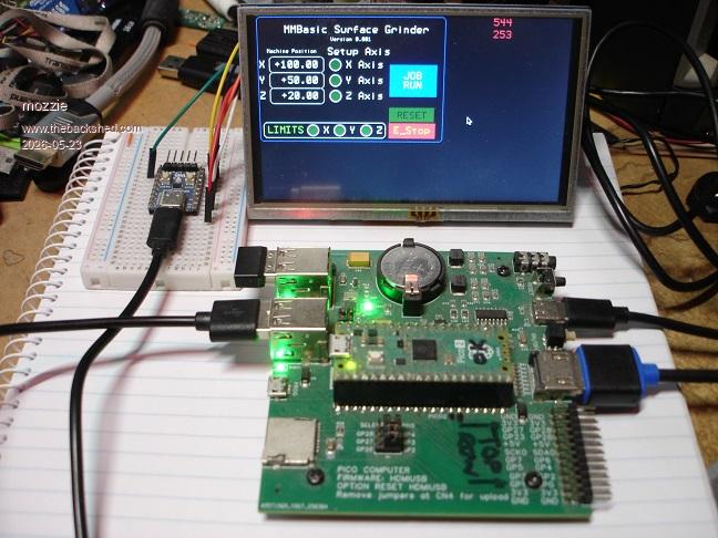

Should have been in bed hours ago but couldn't resist giving this a try
Initial testing shows this is an awesome concept, can now do HDMI with touch quite easily
Couple of minor bugs plus the previous comment above regarding CLICK:

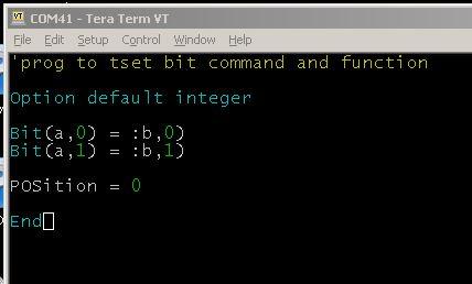

pos becomes POS in command and variable names.
The Pico-Zero showed up as a USB drive a couple of times but a pattern is hard to discern.

  Quote  BIT command is replaced with : in programs.
Can't replicate - please post a program that demonstrates the issue

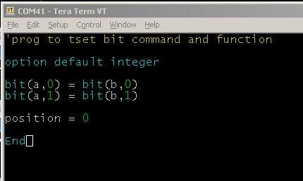

@Peter,
there is probably an issue with BIT function in RC11:
  Quote  '
OPTION EXPLICIT
OPTION DEFAULT NONE
dim integer abc
if bit(abc,0)=0 then
print
end if
the BIT function is changed into
  Quote  :abc,0)=0 then
as always, forgot the version ....
PicoMiteHDMI MMBasic USB RP2350B Edition V6.03.00RC11
Edited 2026-05-23 17:51 by ville56

G'day Peter,
Not the original program but typing the following into the editor:
Save and re-open editor becomes:
Also won't work at command prompt:
> bit(a,2)=bit(a,3)
Error : Cannot find A
> dim a
> bit(a,2)=bit(a,3)
Error : Invalid syntax
So it looks like the function is playing up rather than the command.

... are you considering adding resistive touch support for the GUI functions in the VGI/HDMI firmware or is this a step to far?
is there any hardware available for res-touch with HDMI/VGA monitors that will support that screens (and the controller supported by MMBasic)?
73 de OE1HGA, Gerald
mozzie
Joined: 15/06/2020
Posts: 505
Posted: 08:13am 23 May 2026
G'day Gerald,
There are quite a few available with the XPT2046 resistive touch in 4" to 12" sizes, hence the question on this specific controller, as support is already in the LCD firmware.
The pic in the post above has a Pico-Zero reading the XPT2046 on the 5" touchscreen and sending the co-ordinates via USB-CDC to the PicoMite HDMIUSB. I guess the advantage of this is you only use 8 pins for the HDMI, none more required for touch etc.
Don't want to waste time on taking this idea further if Peter is thinking of baking it into the firmware.
Regards, Lyle.

  Quote  So it looks like the function is playing up rather than the command.
Bummer, I've run out of function tokens and BIT( is the last one defined. Some nasty surgery needed.
disco4now
Joined: 18/12/2014
Posts: 1162
Posted: 09:15am 23 May 2026
I was thinking function CWD$ is a likely candidate for an overlaid function, it should not be in use where performance is an issue.
