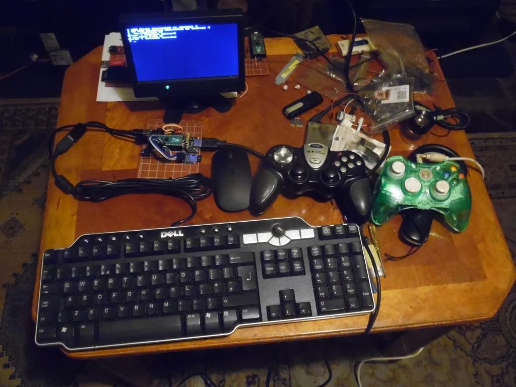

why does MM.INFO(USB 1) say unknown command?
I dug out an old keyboard with 2 usb sockets, plugged a wireless mouse in and it's detected but not the the controllers, are these generic?
Edit my bad it's print mm.info(usb 1). returns 1. sorry

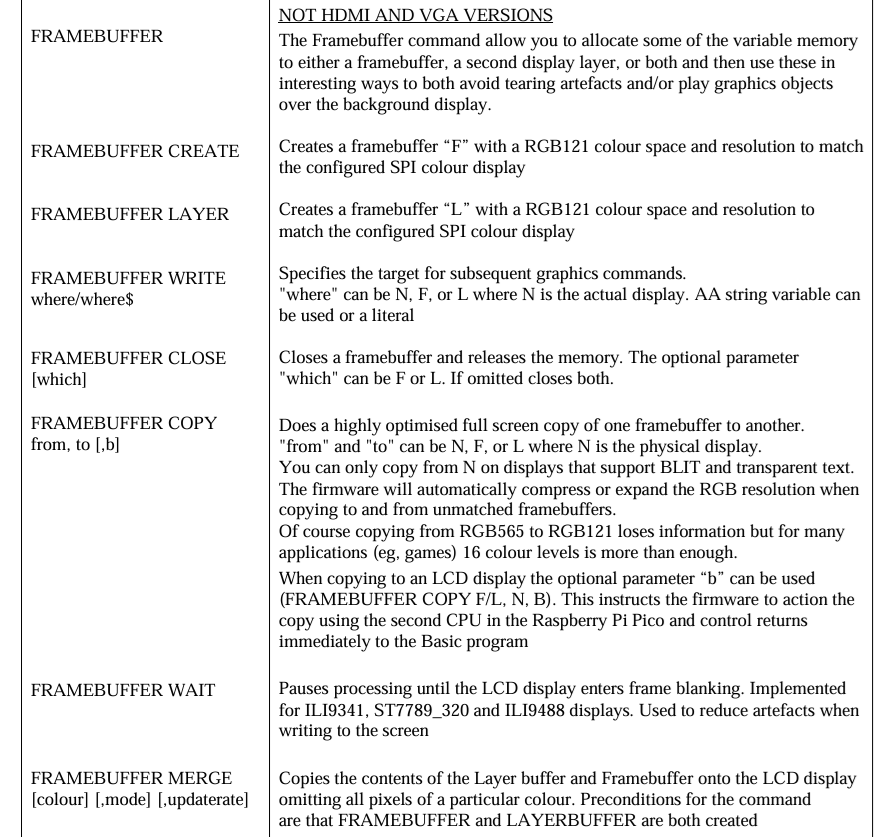

Posts: 6253
Posted: 08:15am 02 Sep 2025
Stan,
On VGA and HDMI the screen memory (FRAMEBUFFER N) is inside the pico. And also the FRAMEBUFFER LAYER memory is inside the pico. The VGA/HDMI shows L overlayed on N automatically (assuming you have FRAMEBUFFER L enabled). The overlaying is part of the video driver, and happens real time when generating the video data that is put on the HDMI/VGA cable.
On an LCD screen the FRAMEBUFFER N is actually inside the LCD itself, so overlaying L is very slow (via SPI get pixel data from the LCD, combine it with data in L, and SPI write it back to screen). The trick that is used is to create a "virtual" framebuffer in memory (FRAMEBUFFER F) and the same overlay FRAMEBUFFER L. The FRAMEBUFFER MERGE command (for LCD's only) merges the RAM values in F and L, and blasts that at maximum speed to the LCD. So the LCD is not read, it is only used as an output device when this happens. This is much faster, and allows to use the LCD for video games.

Posted: 02:58pm 02 Sep 2025
Thanks. MMbasic is so dynamic it's hard to keep up
I tried a test prog, 16 "sprites" 16x16 pixel bouncing around the screen.
Actually blits. I tried box erase each sprite then blit in new position then tried frame F and cls and no box erase just blit 16 "sprites" and copy F,N.
interesting to compare. stan
