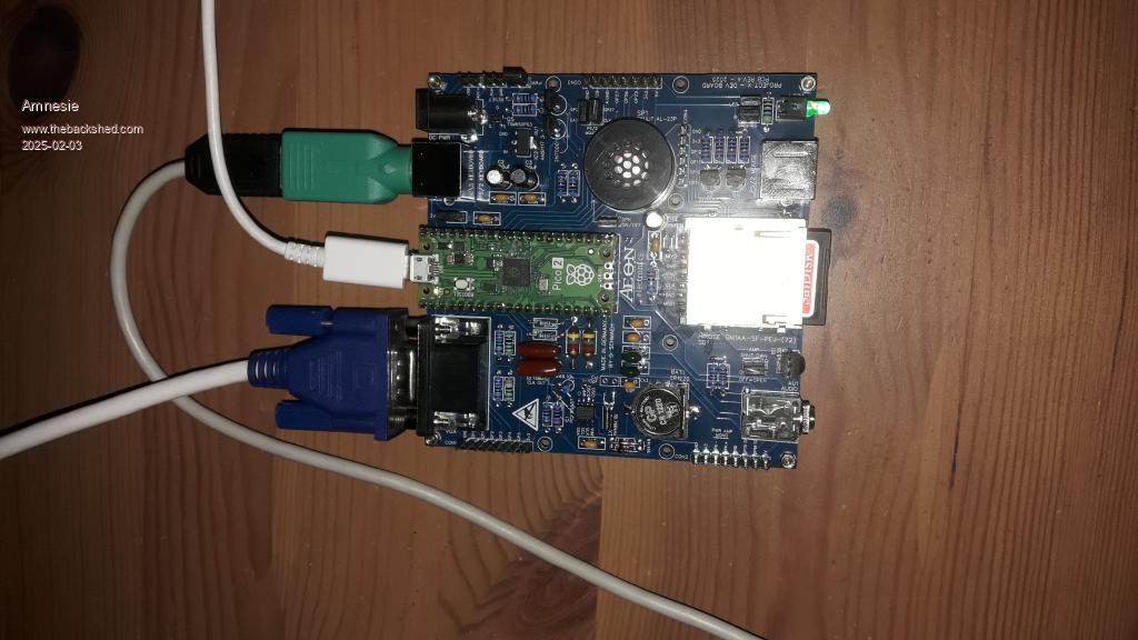

I have found a bug, I think:
MODE 3 16 colours with a resolution of 640 x 480 (RP2350 only)
does not work, just a black screen on ALL my monitors and TVs. If I am typing (blind) "MODE 1" and ENTER, the screen suddenly appears again (in mode 1).. But MODE 3 isn't working.
V6.00.02b6
OPTION LIST
OPTION SYSTEM I2C GP14,GP15
OPTION FLASH SIZE 4194304
OPTION COLOURCODE ON
OPTION KEYBOARD GR
OPTION MOUSE GP27,GP28
OPTION CPUSPEED (kHz) 315000
OPTION SDCARD GP13,GP10,GP11,GP12
OPTION AUDIO GP6,GP7
OPTION COUNT GP0,GP1,GP2,GP3
Tested on my own PCB, which works fine with older versions:
Greetings
Daniel

Posted: 07:04am 03 Feb 2025
Hi Amnesie,
Does your board use a DS1307? Not a DS3132 ? Looks like it has a crystal.
PS2 keyboard AND PS2 mouse ?
Schematics ?
Edited 2025-02-03 17:06 by Volhout

Amnesie
Joined: 30/06/2020
Posts: 763
Posted: 08:42am 03 Feb 2025
  Volhout said  Hi Amnesie,
Schematics ?
Hi,
no it is not a DS1307 it is a PCF8563. There is one thing I hate: Cheap counterfeit China Modules. You can get the (in all ways superior) DS3231 cheap, but try to get the genuine for under 10€ (mouser 12€).
The PCF8563 in contrast costs 75 cents here in Germany (from NXP). For better accuracy I left 2 optional capacitors for tuning, if needed.
Yes my board has PS/2 keyboard AND PS/2 mouse. On the bottom layer of the PCB there is an audio power amplifier, too.
And I didn't used a schottky diode for reverse polarity protection but a p-ch-mosfet.
Sorry I've got no schematics, I did it for myself, but if there is interest I will do a schematic.
Greetings
Daniel
Edited 2025-02-03 18:47 by Amnesie
