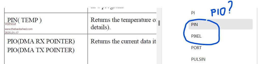

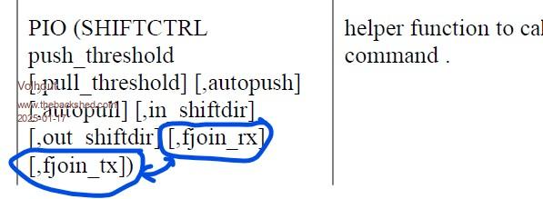

Posts: 6253
Posted: 08:44am 17 Jan 2025
Hi Geoff,
The 6.00.01 user manual could use 2 small changes.
1/ PIO does not appear in the function list
2/ There is a difference in the PIO(SHIFTCTRL ) helper function. The bits for fjoin_rx and fjoin_tx are swapped (join 2 PIO fifo's into one larger fifo). This should be corrected in 2 locations to match the released 6.00.01 firmware.
location 1: the function table
location 2: the appendix (page 189).

Thanks, I have added them all.  Soon we will be ready for another published revision update.
