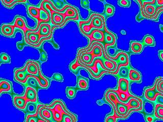

Landscape
MODE 2
CLS Map(1)
r=Rad(35):m%=4
For y%=0 To MM.VRES
For x%=0 To MM.HRES
 h=0
 For i%=1 To 4
   x0=x%/i%:y0=y%/i%
   a=r*i%
   Co=Cos(a):Si=Sin(a)
   s=x0*Co-y0*Si
   t=x0*Si+y0*Co
   h=h+Sin(s/5)*4+Sin(t/7)*5
 Next
If h>-2 Then
 Color Map(4+Abs(h) Mod 7)
 Pixel x0*m%,y0*m%
EndIf
Next : Next

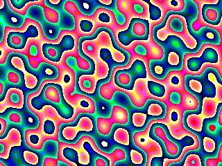

Plasma
MODE 2
Map Reset
Dim integer cm(15)=(0,15,7,1,0,0,0,0,0,0,0,0,0,0,0,0)
Colour Map cm(),cm()
r=Rad(35)
For Y0%=0 To MM.VRES
For X0%=0 To MM.HRES
 h=0
For i%=1 To 3
 x=(X0%-10)/i%:y=Y0%/i%:a=r*i%
 C0=Cos(a):S0=Sin(a)
 s=x*C0-y*S0:t=x*S0+y*C0
Next
 Pixel X0%,Y0%,Map((h+24)Mod 16)
Next :Next
 T=cm(0)
 For i%=0 To 14:cm(i%)=cm(i%+1):Next
 cm(15)=T
 For i%=0 To 15:Map(i%)=cm(i%):Next
 Map Set
 Pause 50

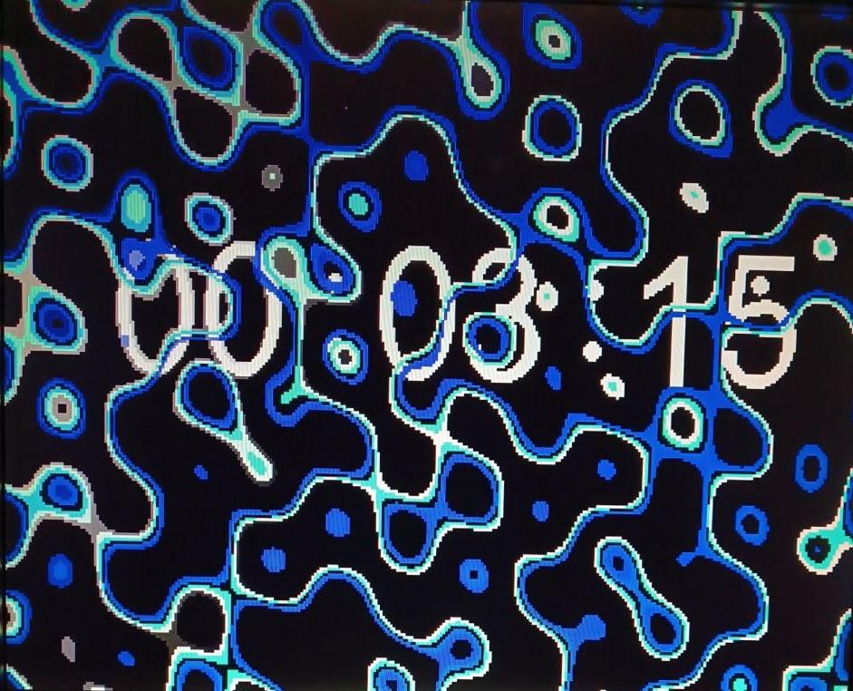

javavi
Joined: 01/10/2023
Location: Ukraine
Posts: 636
Posted: 05:37pm 06 Nov 2025

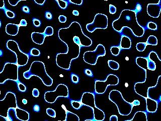

Plasma Watch
MODE 2
Map Reset
Dim integer CM(15)=(0,15,7,3,1,0,0,0,0,0,0,0,0,0,0,0)
Colour Map CM(),CM()
FRAMEBUFFER LAYER
FRAMEBUFFER WRITE L
r=Rad(35)
 h=0
For i%=1 To 3
 C0=Cos(a):S0=Sin(a)
Next
 Pixel X0%,Y0%,Map((h+64)Mod 16)
Next :Next
FRAMEBUFFER WRITE N
XCntr%=MM.HRES\2:YCntr%=MM.VRES\2
XC%=XCntr%:YC%=YCntr%:CC%=1
XDir%=1:YDir%=1
 TC%=CM(1)
 For i%=1 To 14:CM(i%)=CM(i%+1):Next
 CM(15)=TC%
 For i%=1 To 15:Map(i%)=CM(i%):Next
 Map Set
 Inc CC%,-1:If CC%=0 Then CC%=15
 CLS
 Text XC%,YC%,Time$,"CM",6,,Map(CC%)
 Inc XC%,XDir%:Inc YC%,YDir%
 If XC%>XCntr%+32 Then XDir%=-1
 If XC%<XCntr%-32 Then XDir%=1
 If YC%>YCntr%+95 Then YDir%=-1
 If YC%<YCntr%-95 Then YDir%=1
 Pause 50
Loop

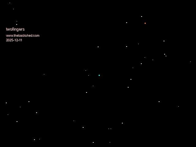

twofingers
Joined: 02/06/2014
Posts: 1785
Posted: 03:00pm 10 Dec 2025
I like this thread because I can sometimes look up how to use certain graphics commands here. Many thanks, Vadim, for your tireless work!
My StarFlight screensaver for HDMI (Pico2, Mode 1 & 3) is a small contribution. The code is optimized for low memory usage (~1200 Bytes):

N - Star Count Index Limit: Defines the total number of stars (here: 120 stars).
S() - Star Data Array: An array that stores the packed state data (coordinates, etc.) for each star. Replaces S(n,5).
ZM - Z-Maximum: Defines the maximum depth (Z) in 3D space (50 units).
ZS - Z-Speed: Defines the speed (1 unit per frame) at which the depth (WZ) of each star is reduced.
SW - Screen Width: Stores the horizontal resolution (MM.HRES) of the display.
SH - Screen Height: Stores the vertical resolution (MM.VRES) of the display.
CX - Center X: The X-coordinate of the screen center (SW/2), used as an offset for the projection.
CY - Center Y: The Y-coordinate of the screen center (SH/2), used as an offset for the projection.
MSH - Max Screen Height: Defines the maximum Y screen boundary for drawing (SH - 2 * FontHeight).
Z1 - Z-Level 1: Depth (ZM * 0.7), defines the first color/character change threshold (Farthest to Mid-range).
Z2 - Z-Level 2: Depth (ZM / 4), defines the second color/character change threshold (Mid-range to Closest).
Adapting it for Mode 2 and the terminal is possible by replacing the star-characters with characters using ASCII codes less than 128 (e.g. CH$=".","+","*"). Of course, it won't look as good then.
There are still 3 million miles to go home ...

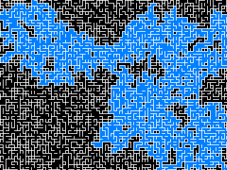

Fill Maze
MODE 2
CLS
S=4
W=MM.HRES\S
H=MM.VRES\S
For Y=0 To H
For X=0 To W
 X0=X*S:Y0=Y*S
 If Rnd>.5 Then Line X0,Y0,X0+S,Y0
 If Rnd>.5 Then Line X0,Y0,X0,Y0+S
Next
Next
X=Int(Rnd*W)*S+2
Y=Int(Rnd*H)*S+2
Fill X,Y,Map(Int(Rnd*15))
Fill X,Y,0

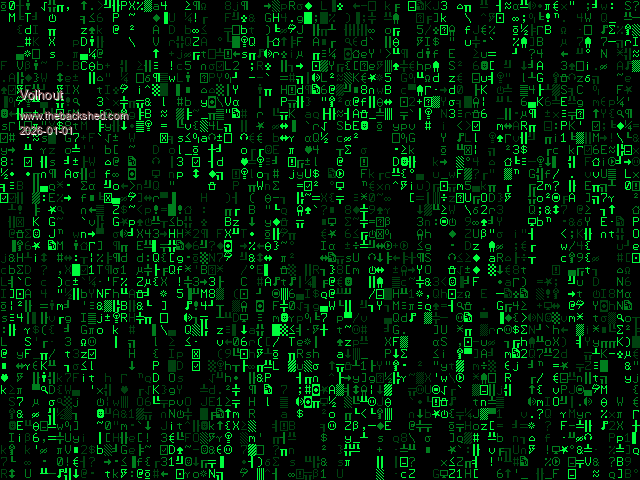

Good to hear that you are still holding on. All the best wished for 2026, and may the war be over soon.
One VGA demo I think is missing in this (your) thread is the your impressive matrix screen saver. Here as a stand alone program.
'SCREEN SAVER - Matrix
Const FW=MM.Info(FONTWIDTH): FH=MM.Info(FONTHEIGHT)
Const CHR=MM.HRes\FW: CVR=MM.VRes\FH
dim matr(CHR),fade(CHR),clr,x
For x=1 To CHR:matr(x)=CVR*Rnd:fade(x)=&hF*Rnd:Next
 For x=1 To CHR
   clr=&h1000*(fade(x)-&hF) And &hFF00
   Colour clr
   Print @(x*FW-FW,matr(x)*FH)Chr$(Rnd*223+32);
   If matr(x)>CVR  Then matr(x)=0 Else Inc matr(x)
   If fade(x)=&hF0 Then fade(x)=0 Else Inc fade(x)
 Next
 Pause 10
Loop While Inkey$=""
P.S. the last maze demo is a most impressive demo of Pico's V6.01.00 capabilities in utmost simplicity. Very nice !!

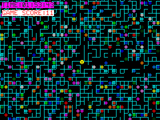

Maze Game
MODE 2
CLS :Font #8
S=8
W=MM.HRES\S: Xc=MM.HRES\2
H=MM.VRES\S: Yc=MM.VRES\2
COUNTER=0: SCORE=0
CONTROL=0: DIRECT=0: SHIFT=0
Timer =0
FRAMEBUFFER LAYER
FRAMEBUFFER WRITE L
Color Map(14)
Print @(Xc,Yc)"%";
FRAMEBUFFER WRITE N
Color Map(7),Map(0)
Print @(0,0);
For i=1 To W*H
 Print Chr$(32+Int(Rnd*4));
Next
GameController
CheckMovement(CONTROL)
Moving(DIRECT)
If SHIFT>7 Then
 SHIFT=0
 Color Map(Int(Rnd*16))
 Print @(Int(Rnd*W)*S,Int(Rnd*H)*S,1);"$";
 Color Map(7)
 Print @(Int(Rnd*W)*S,Int(Rnd*H)*S,1);Chr$(Int(Rnd*4)+32);
 If Pixel(Xc+2,Yc+2) Then
  Inc SCORE
  Print @(Xc,Yc)" ";
  Play Tone 400+100*Int(Rnd*30),400,200
  'Text Xc,2,"GAME SCORE:"+Str$(SCORE),"C",1,,Map(8),Map(15)
 EndIf
EndIf
FRAMEBUFFER WRITE L
Text 4,4,"TIME:"+Time$,"L",1,,Map(2),Map(9)
Text 4,20,"GAME SCORE:"+Str$(SCORE),"L",1,,Map(8),Map(15)
FRAMEBUFFER WRITE N
Pause 10
Loop
Sub GameController
Select Case Asc(Inkey$)
 Case 0
  CONTROL=0
  Inc COUNTER: If COUNTER>500 Then CONTROL=Int(Rnd*6)
  Exit Sub
 Case 27
  End
 Case 13,32
  CONTROL=5
 Case 119,128
  CONTROL=1
 Case 100,131
  CONTROL=2
 Case 115,129
  CONTROL=3
 Case 97,130
  CONTROL=4
End Select
COUNTER=0
End Sub
Sub CheckMovement(CTRL)
If SHIFT Then Exit Sub
DIRECT=CTRL
Select Case CTRL
Case 0
 Exit Sub
Case 1
 If Pixel(Xc+4,Yc) Then DIRECT=0
Case 2
 If Pixel(Xc+8,Yc+4) Then DIRECT=0
Case 3
 If Pixel(Xc+4,Yc+8) Then DIRECT=0
Case 4
 If Pixel(Xc,Yc+4) Then DIRECT=0
Case 5
 Print @(Xc,Yc)" ";
End Select
Play Tone 500,500,10
End Sub
Sub Moving(D)
Select Case D
Case 0
 Exit Sub
Case 1
 Sprite scroll 0,-1
Case 2
 Sprite scroll -1,0
Case 3
 Sprite scroll 0,1
Case 4
 Sprite scroll 1,0
End Select
Inc SHIFT
End Sub
DefineFont #8
06200808
00000000 00000000 000000ff 00000000
80808080 80808080 808080ff 80808080
663c1800 00183c66 dbdb7e3c 3c66dbff
End DefineFont

Labyrinth Clock
MODE 2: CLS : Font #8
FRAMEBUFFER LAYER
S=8:W=MM.HRES\S:H=MM.VRES\S
FAddr=MM.Info(FONT ADDRESS 1)+4
If Timer>1000 Then
Timer =0
TTime$=Left$(Time$,5)
FRAMEBUFFER WRITE L
Print @(0,80);
For l=1 To 12
 For n=1 To 5
  CN=Asc(Mid$(TTime$,n,1))-32
  BYTE=PEEK(BYTE FAddr+CN*12+l)
  MASK=128
  For i=1 To 8
   If BYTE And MASK Then
    Color Map(15),Map(7):Print Chr$(Int(Rnd*4)+32);
   Else
    Color Map(15),0:Print " ";
   EndIf
   MASK=MASK>>1
  Next
 Next
 Print
Next
FRAMEBUFFER WRITE N
Color Map(Int(Rnd*15)+1),0
EndIf
Print @(Int(Rnd*W)*S,Int(Rnd*H)*S);Chr$(Int(Rnd*4)+32);
Loop Until Inkey$<>""

Inspired by Daves Garage, I decided to try to optimize a StarField type display, for as many stars as possible, or trade off stars for speed, whatever you fancy.
The following runs at 20Hz with 600 stars on a 2350 VGA screen at 378MHz, or 10Hz with 1200 stars, obviously this will vary with CPU, and or clock speed and number of stars. It should automatically scale for screen size, the stars do change colour as they come towards you,
Change maxst for number of stars, change the -0.15 constant to speed up or slow down the stars approach, if you want larger stars, you can use Box instead of Pixel, it doesn't affect the speed much.
It works just as well on a LCD screen as a VGA or HDMI, for a LCD comment out the Mode 2 line.
It's based on some code Martin put up a while ago, which itself was based on some code from Juri, though now it's almost unrecognisable. ;-)
'Starfield by Juri Fossaroli
'PicomiteVGA version Martin Herhaus
'set mode here if appropriate
MODE 2
'change maxst for more or fewer stars
Dim Integer maxst=600,h=MM.VRES,w=MM.HRES,hh=h>>1,hw=w>>1,x,y,st
Dim Float stx(maxst),stxx(maxst),sty(maxst),styy(maxst),stz(maxst)
Dim Integer ox(maxst),oy(maxst),oxl(maxst),oyl(maxst),cl(maxst),s(maxst)
CLS
'initialise the stars
For st=0 To maxst-1
If stxx(st)=0 Or styy(st)=0 Then
   stxx(st)=Int(Rnd(1)*40)-20:styy(st)=Int(Rnd(1)*40)-20
   stz(st)=(Int(Rnd(1)*50)/100)+0.50
   cl(st)=RGB(White)
EndIf
Next
'blank out central pixel
ox(maxst)=hw:oy(maxst)=hh:cl(maxst)=0
'initialise box size
Math Set 2,s()
'move stars forward
Math Add stz(),-0.015,stz()
'do the calculation (stx/stz)+half width
Math C_div stxx(),stz(),stx():Math Add stx(),hw,stx()
'do the calculation (sty/stz)+half height
Math C_div styy(),stz(),sty():Math Add sty(),hh,sty()
'set star colour and check for star off screen
For st=0 To maxst-1
x=stx(st):y=sty(st)
Select Case stz(st)
Case < 0.1
 cl(st)=RGB(Yellow)
Case < 0.4
 cl(st)=RGB(White)
Case < 0.8
 cl(st)=RGB(Cyan)
Case Else
 cl(st)=RGB(Blue)
End Select
If x>0 And x<w And y>0 And y<h Then
 ox(st)=x:oy(st)=y
Else
 stxx(st)=Rnd(1)*40-20:styy(st)=Rnd(1)*40-20:stz(st)=Rnd(1)*0.5+0.5
EndIf
Next
'blank out last times stars, replace with new stars
Pixel oxl(),oyl(),0:Pixel ox(),oy(),cl()
' Box oxl(),oyl(),s(),s(),0,,0:Box ox(),oy(),s(),s(),0,,cl()
'copy this times stars, to last times stars array
Math Add ox(),0,oxl():Math add oy(),0,oyl()
'Print Timer:Timer =0
Loop
Enjoy. :-)

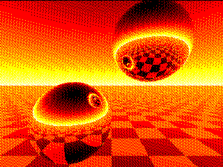

Spheres
MODE 2
Map(1)=RGB(Red)
Map(2)=RGB(Yellow)
Map(3)=RGB(White)
Map set
For N=0 To 239
For M=0 To 319
X=0:Y=-.1:Z=3
U=(M-159.5)/160:V=(N-117.5)/160
W=1/Sqr(U*U+V*V+1):U=U*W:V=V*W
I=Sgn(U):G=1
 E=X-I:F=Y-I:P=U*E+V*F-W*Z
 D=P*P-E*E-F*F-Z*Z+1
 If D>0 Then
  T=-P-Sqr(D)
  If T>0 Then
   X=X+T*U:Y=Y+T*V:Z=Z-T*W:E=X-I:F=Y-I:G=Z
   P=2*(U*E+V*F-W*G):U=U-P*E:V=V-P*F:W=W+P*G:I=-I
   Loop
  EndIf
 EndIf
 If V<0 Then
  P=(Y+2)/V:V=-V*((Int(X-U*P)+Int(Z-W*P)And 1)/2+.3)+.2
 EndIf
 Color Map(3-(48*Sqr(V)+(7*(M+4*N))Mod 16)\16)
 Pixel M,240-N
Next
Next
