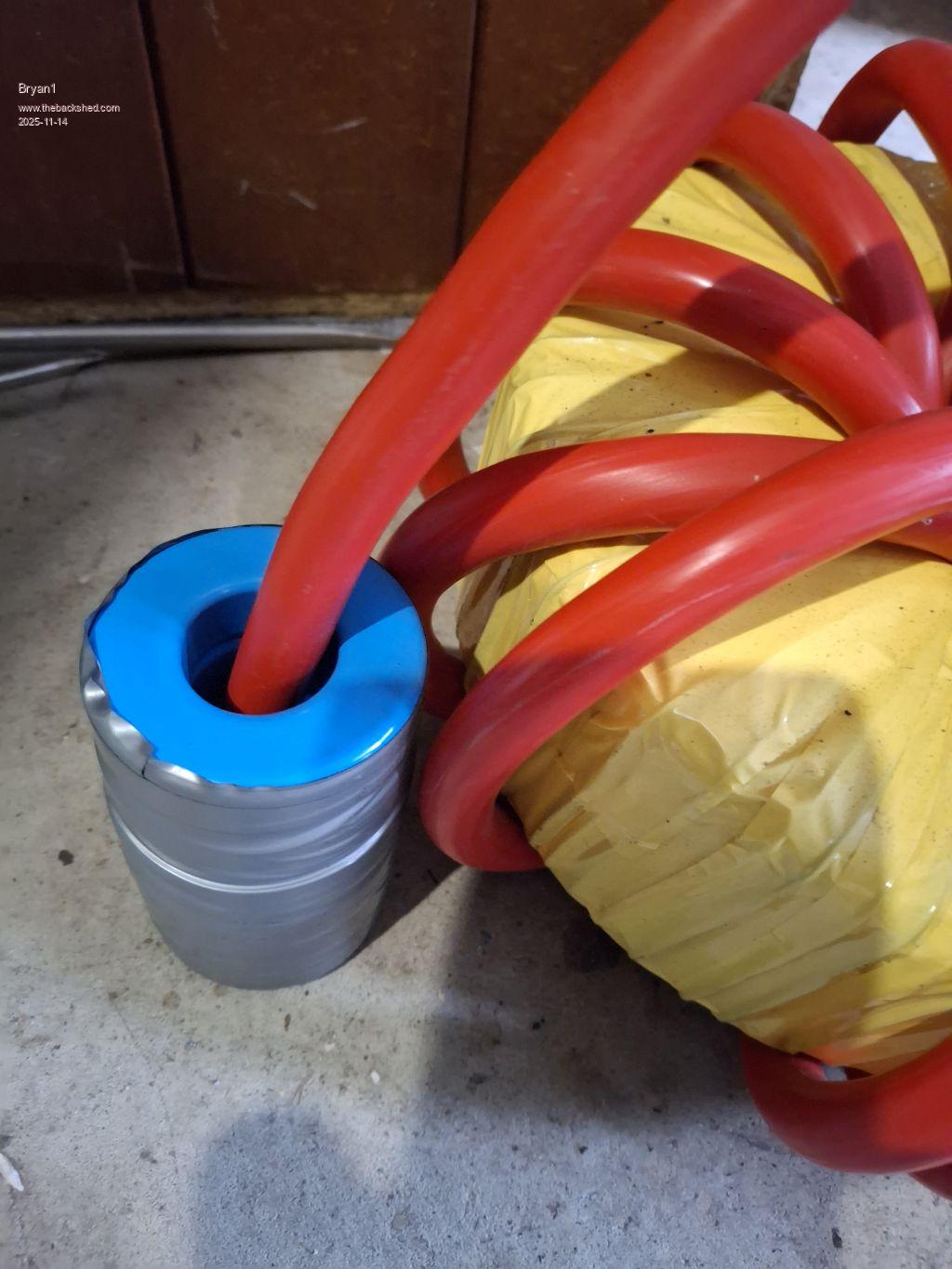

The number of turns is the number through the hole. Looks like 4 to me.

As phil99 said, 4 turns, and with those cores, I think the inductance meter is wrong.

So Keepis I will do the other one and see if they do read the same with my meter and on talking with Roger he did say he had the crimping tool so one has to wonder if he also has an inductance meter too   I did get the 4 8mm lugs today too and still have one lug to put on the primary which I have.

Me thinks if using 65sqmm in these toroids may be lucky to get 2 turns

Those chocks do not have much space in them. The chocks recommended by Dex are perfect but very expensive at about 100 Euros each. Perhaps we can find a better solution.

  Bryan1 said
I am glad I took my inductance meter to work and several goes did say the same result 9 UH So a question for the brains trust is 9uH too low for a choke.
9uH seems low.  I guess the cores you got only have 60u so that could explain the low inductance you are getting.

I posted my data using those cores, that's why I asked about the core code, these are really good cores with better saturation levels.
The following values are out a bit because falling REF DC throws out (increases) dt and no allowance is made for winding R-Loss or Jig switching R-Loss. BTW there is no current shunt R-loss.
CS571060 cores, 5 turns 6 stack resonant inductance @ 20kHz = 22.6uh, 4 turns around 13uH, you could always add another core if you can't fit an extra pass through to get 5 turns.
DSO calc:
 75A = 23uH     (75.9V)
125A = 19.9uH   (75.4V)
250A = 15.4uH   (70.2V) with dt reduced by 20%
  Quote  I have always imagined FETS with 40kW of LiFePO4 battery @ 53 volts with 40000uF on one side and looking into a big Toroid primary wound with a relatively short length of 50mm2 cable and a load condition that makes the Toroid primary look like a dead short.
That's why I harp on about using two 6-stack chokes which allow a good winding length using a smaller gauge cable. The small resistance in the choke cables combined with any remaining inductance in the Chokes is all that stands between FET Survival and FET Graveyard under very high current trip conditions.
It may come down to just the Choke cable R-loss that gives the FETS the last buffer to survive long enough for the current trip to kick in.
I used 2AWG 35mm2 cable is rated at 188A continuous, you can get the same in welding cable rated at 220A, a bit harder to wind though.

           Well took the other toroids and wire into work today and wound the second choke and I did manage to get the bends on the turns pretty close to the same   Now got home and put the meter on 10uH so decided to test the first choke and it came in at 11uH so this meter I have that wasn't that cheap looks like ain't upto the task.

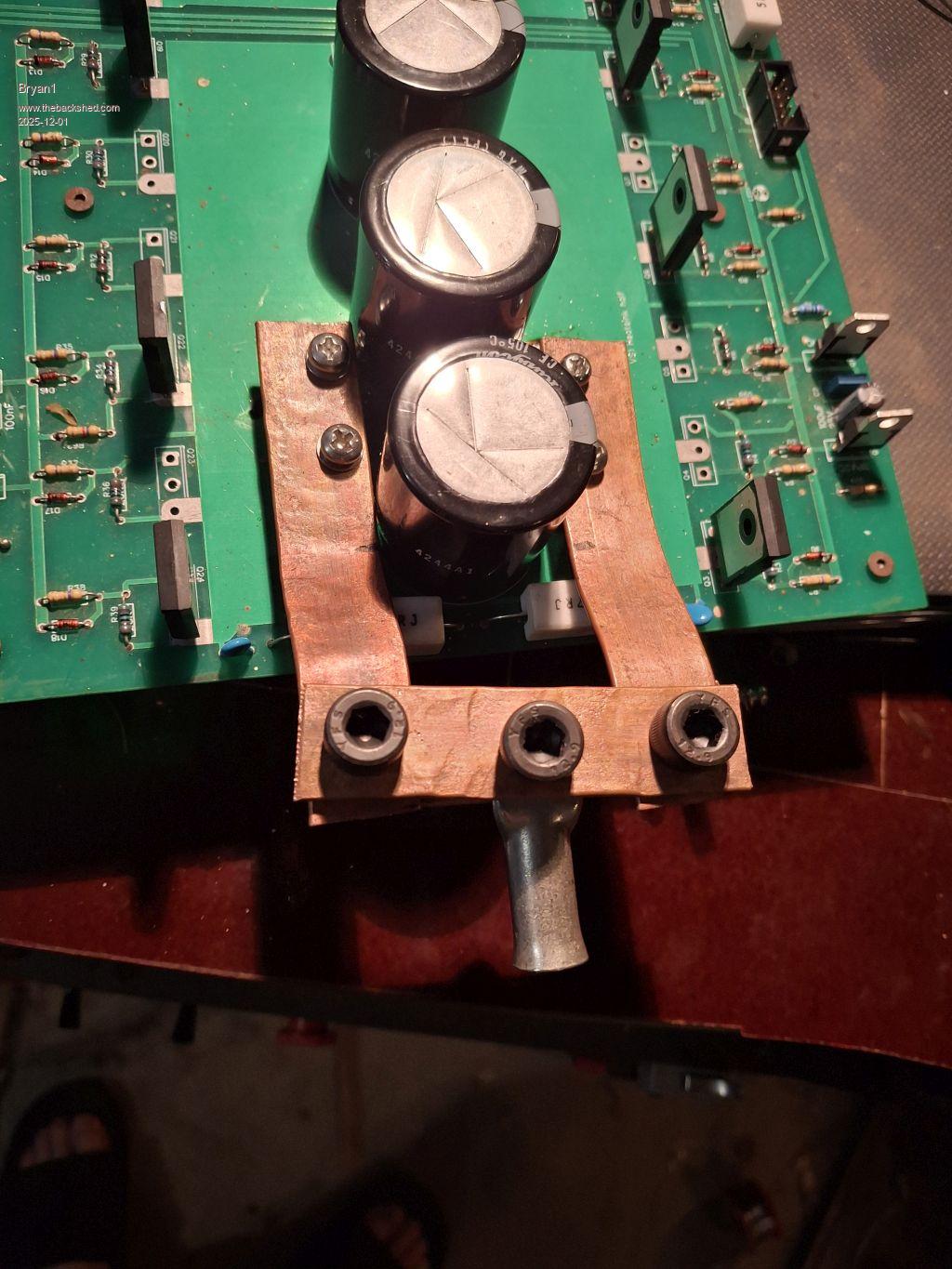

Well spent some time in the shed tonight and got the VS1 connection done
Gotta say it was a bit of fun soldering on the pads and finally worked out the best way to get a good joint now got a single 18x3 copper plate (squashed from 1/2" pipe) coming out from each pad then on plate top and bottom to clamp the choke cable.
I am going to need to flatten more 1/2" pipe for doing the battery connection as there won't be enough from what I did.
Tomorrow night I'll get VS2 done then I can size the choke cables then take then to work to get the lugs on.

Well I scrathed the idea of using those M4 seats as the last thing I need is a joint failure when drawing 4Kw or more and on talking with the sparkie at work I came home with 4 off 50sqmm 150mm long with 10mm lugs on one end.
So got the seats off the pad and my trusty solder sucker copped a beating   and used some Bakers soldering flux to help tin the end, used my fine blow torch and got a solid wire as I did use my mini hacksaw to true up the end.
Anyway my old soldering irons my dad me had seen better days so as Roger did show me his heavy duty soldering iron I do think it's best to use that. Anyway as I was told bakers soldering flux is a big NO NO and with the 50sqmm wire being 150mm long there is plenty of green as the idea when the wire comes off the board it's going down to make the connection with the choke.
So got Saturday arvo planned with Roger where all the heavy wire can get done correctly then not far away from doing the first test.
Regards Bryan
