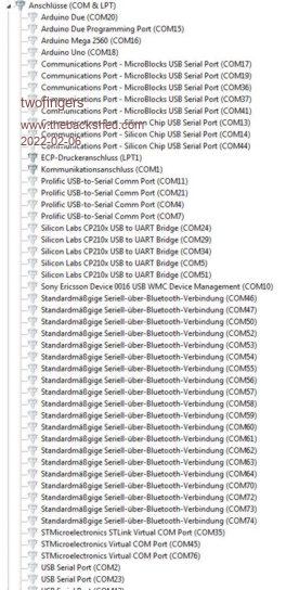

I've been using his tools for a while.
I think he has a lot of useful things on offer. Thanks for that.
Michael
Just an impression to show how many COM ports you can have.(Win7):
Edited 2022-02-06 05:22 by twofingers

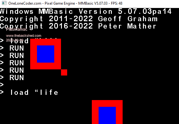

Hi
after :
Box 100,100,100,100,22,RGB(red),RGB(blue)
Blit 100,100,300,300,100,100
Blit read 1,100,100,20,20
Blit write 1,200,200
the next command will crash
*load
*new
etc
Edited 2022-02-09 02:33 by Plasmamac
