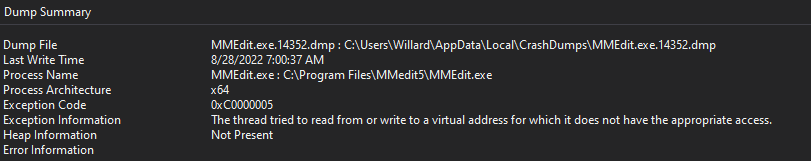

Returning to FM crash
MMCC.inf and video attached.
Latest version. Portable.
MMCC.zip
Video_2022-08-15_175953.zip
Kabron
Joined: 30/11/2017
Posts: 65
Posted: 03:10pm 15 Aug 2022
I guess I found crash reason.
MMCC does not save device type.
Device allways micromite

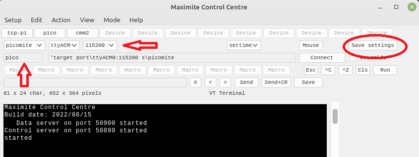

@Volhout,
I will add a prompt for device name if you have left that box blank. On the Linux rendering, that is not obviously a box for entry. I think that was your problem. The inf files are located in the data sub-folder and need write permissions.
Also note the VGAmite refers to the original blackpill, a short-lived offering. In light of current naming, I will have to change that. The picomite selection also covers the VGA version on the pico because as far as MMEdit is concerned, they are the same.
Sorry about all the confusion.

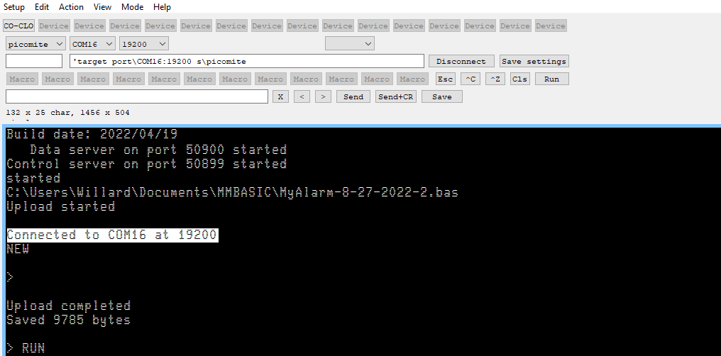

I've been having issues with the latest releases.
When I try to DEPLOY with F2, the MCC insists that my com port changed... (it didn't) and refuses to upload.  Falling back to a version I had from April works just fine.

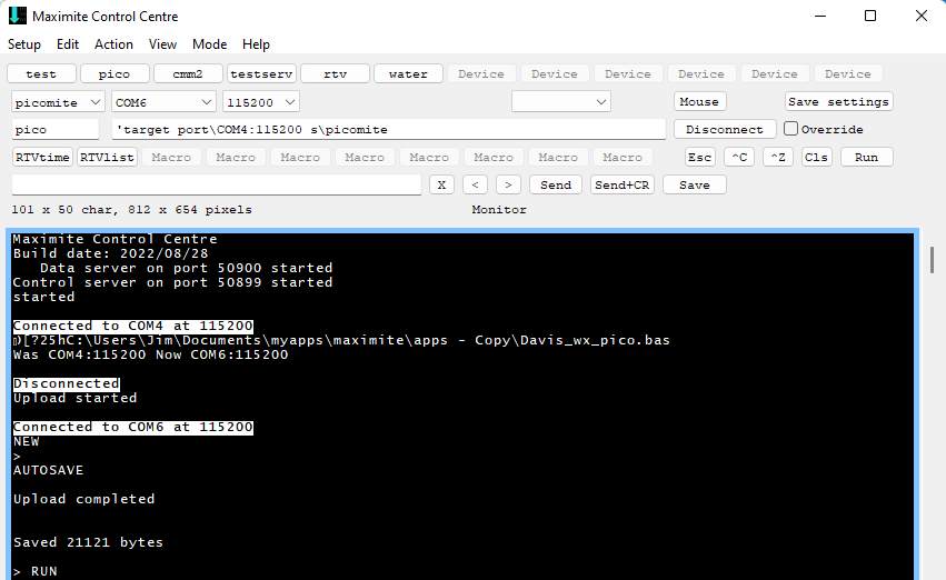

The code that decides to display the "port changed" message is simple:
If currentConnection <>"" And currentConnection <> newConnection
  MMdisconnect()
  notice("Port Changed!"+#LF$+"disconnecting first.",2000)
EndIf
Which means.
If the device is currently connected and the current connection specs are different to the new specs, then disconnect and show a warning.
After that, MMCC will reconnect using the new specs.
I will add a test for Windows users to cater for a change in case (COM to com) but that wouldn't stop a successful re-connection.
I will print more debug information to the terminal window which should help diagnose.
MMCC gets its port information from the first line of your code and if it is not specified there, it use the device specifications in MMCC (to the left of the "connect" button).
It would help if you can post a screen print of the MMCC after a fail. Something similar to this:

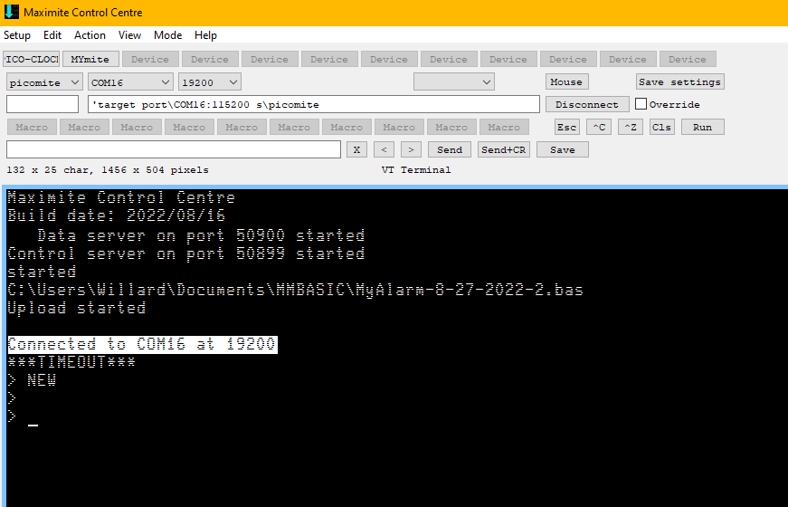

Well, as mentioned...   I get reasonably correct behavior from the earlier release.
So I then installed the 8/16 version again... and I get a slightly different behavior now.  It stopped complaining about CHANGED COM port on deploy... it now just times out.
Was able to reproduce this twice after shutting down MMEDIT and ControlCenter.
Also... If I do a fresh restart of MMEDIT 8/16, and load a program into the editor but then "just goofing" I chose to MANUALLY change the Syntax from default CMM2 to PICOMITE, the program will crash to desktop.
I'm not sure if I need to wipe out persistent settings or not, so maybe that's why I'm getting unusual results.  So, I'm going to do a complete wipe again and re-install.
So... complete removal... uninstall, remove multiple folders... re-install... same thing. TIMEOUT.
Using Teraterm to upload with Autosave works fine... I'm stumped.

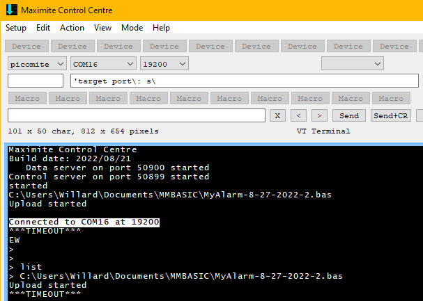

You appear to have a port specification as the first line of your program. Can you share that first line with me?
If the first line of your program has (what looks like) a port specs, that has priority over the MMCC settings unless you have "override" ticked, in which sasses MMCC always wins.
When you were having problems with the "port changed" warnings, I suspect that you had different baud rates set in MMCC and your program first line.
  Quote  Also... If I do a fresh restart of MMEDIT 8/16, and load a program into the editor but then "just goofing" I chose to MANUALLY change the Syntax from default CMM2 to PICOMITE, the program will crash to desktop.
Can you expand on "goofing"? I was never any good at mind reading.
If you do reinstall fully or just delete your MMEdit.inf and MMCC.inf files to reset things, please keep a copy of the two inf files first so I have something to go on.

Goofing:  Doing something I didn't *need* to do... but doing it anyway.
And yes, my first line is:
'target port\COM16:19200 s\picomite
and I was relying on that... not what MMCC had a "saved" setting for, for example.
If I make sure that MMCC config and the first line match...
and then disconnect MMCC from Picomit and then reconnect to Picomite
I still get...
Upload started
***TIMEOUT***
...when I select DEPLOY
I'm not sure if I need to mention that I'm using the latest non-vga picomite beta.
Edited 2022-08-29 21:06 by pwillard
I still get...
Upload started
***TIMEOUT***

Good troubleshooting idea... but this is after a fresh reboot, so no other terminal was running.  For sanity checking... I'm going to drop back to an older version of PICOMITE firmware. PicoMiteV5.07.04
Fresh Picomite Firmware
reboot
Verify communication with PICO.
1st line setup removed from code.
Now relying on MMCC settings
Maximite Control Centre
Build date: 2022/08/21
  Data server on port 50900 started
Control server on port 50899 started
started
Connected to COM16 at 115200
> run
Code is running...  printing updates
Update time: 08:16:03
DST STATE =  1
CTRL-C to break the connection...
Get ">" prompt back.
In MMEDIT, press deploy...
> C:\Users\Willard\Documents\MMBASIC\MyAlarm-8-27-2022-2.bas
Uploading using:  'target port\COM16:115200 s\picomite
Upload started
***TIMEOUT***
I'm stumped...
Again... I can later startup a Teraterm session and do an Autosave upload just fine...
and this was all working a few weeks ago but I was using older releases..
To Be Honest: I'm starting to suspect my PICO is not OK.
CONCLUSION CONFIRMED: It's my PICO.  The PIMORONI PICO LIPO. Different enough to be a problem...
Edited 2022-08-30 04:48 by pwillard
