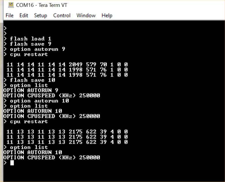

Posted: 09:32pm 21 Aug 2021
OPTION AUTORUN 1 works fine
OPTION AUTORUN 10 doesn't. The option has disappeared from the list after powering up.

Posts: 9329
Posted: 07:50am 22 Aug 2021
weird... I'll try again. It definitely didn't work though. I had a digital clock in flash 10 and I couldn't get it to auto run. I tried by disconnecting & reconnecting usb and also by powering direct without usb. No go. I copied the prog into flash 1 and it works perfectly every time. I'll double check.

This is crazy....
> option list
OPTION AUTORUN 1
OPTION COLOURCODE ON
OPTION DISPLAY 33, 100
OPTION CPUSPEED (KHz) 133000
OPTION SDCARD GP22
OPTION SYSTEM I2C GP12,GP13
OPTION LCDPANEL ILI9341, RLANDSCAPE,GP20,GP21,GP17
OPTION RTC AUTO ENABLED
OPTION GUI CONTROLS 59
OPTION MEMORY 80384, 80384
OPTION TOUCH GP14,GP15,GP28
GUI CALIBRATE 0, 362, 287, 897, 678
Press Reset and it runs fine.
> option autorun 10
Press RESET. Reboots
PicoMite MMBasic Version 5.07.00b11
Copyright 2011-2021 Geoff Graham
Copyright 2016-2021 Peter Mather
not running.
prog is in both slots 1 and 10. I've been running it from both so I know it works.
> flash list
Slot 1 in use: "'clock"
Slot 2 available
Slot 3 available
Slot 4 available
Slot 5 available
Slot 6 available
Slot 7 available
Slot 8 in use: "'WS2812B string"
Slot 9 in use: "'MM+ Demo"
Slot 10 in use: "'clock"
> option list
OPTION SDCARD GP22
... and >poof!< it's disappeared in a cloud of invisible smoke ...
I wondered if it was the RTC stopping it but disabling that made no difference.
EDIT:
flash slots 2 and 8 aren't working either. I'll wipe the lot and reinstall.
Edited 2021-08-22 18:13 by Mixtel90
Posted: 08:20am 22 Aug 2021
Try without the option memory command - that is the most likely area for a bug in the firmware
Posts: 9329
Posted: 08:51am 22 Aug 2021
I've reinstalled, without that bit, and slots 1 and 2 are fine now. I'll try adding that option and see if it messes things up.
EDIT:
Yep, it messed things up. Autorun 2 isn't working now. I tried option memory 0, 80384 and that didn't fix it, but it now reports memory 80384,83456 which is correct for 59 controls at 52 bytes each.
Option memory 0,81920 has restored autorun 2 to life.
Edited 2021-08-22 19:12 by Mixtel90
Posted: 10:08am 22 Aug 2021
Please try the attached - no version change
PicoMiteV5.07.00b14.zip
