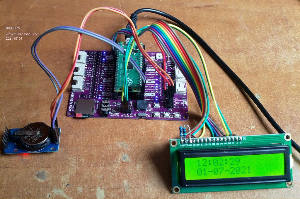

a45
PicomiteV5.07.00a45.zip
KEYPAD and LCD commands now working - see MM2 manual.
Note you should use a 3.3V LCD as in the picture - they are available
