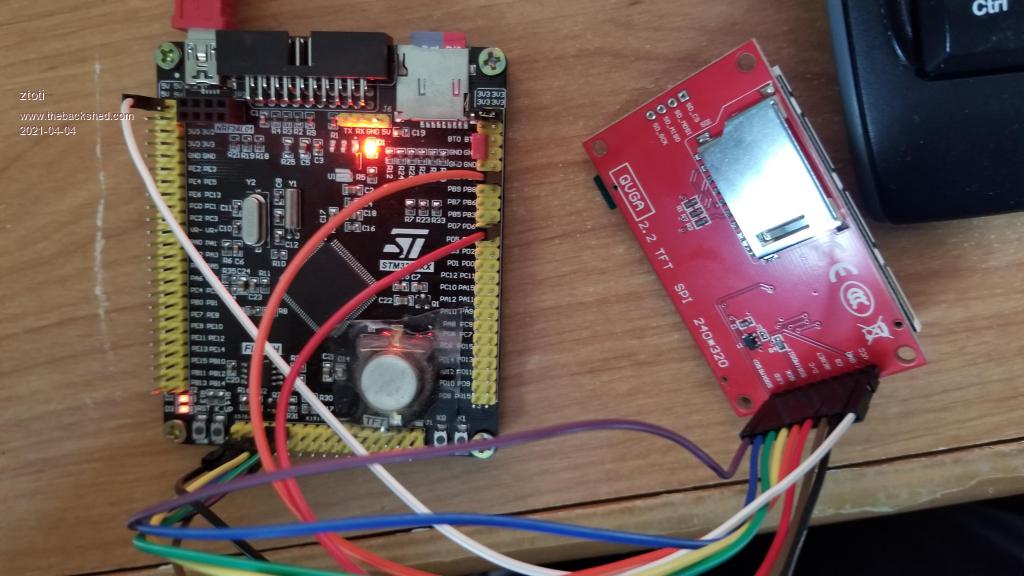

  ztoti said  I connected ILI9341 to the board according with the manual:
OPTION LCDPANEL ILI9341, LANDSCAPE, PE0, PD6, PC4
but I have just black screen. Backlight command works just fine (brightness is going from min to max) and this is it, GUI test lcdpanel doesn't work.
The F4 when flashed should already be configured for the 32-pin, 16-bit ILI9341. Your OPTION LCDPANEL would be for an SPI ILI9341. Which do you have?
If the 32-pin version, try re-flashing, then OPTION LIST, or, per the manual, use OPTION RESET to set the default options.i.e.
OPTION LCDPANEL ILI9341_16, RLANDSCAPE
OPTION TOUCH PB12, PC5

I have SPI ILI9341 and use it in many projects with MM,MM2,MM2+,MMExtreme and no problem at all. I tried also with SPI ILI9341 without the touch panel, same result - black screen.
What I did:
OPTION LCDPANEL DISABLE
OPTION LIST  ......no display config. on the screen
 connect SPI ILI 9341 as on the manual, D/C on PE0, RESET on PD6, CS on PC4
 restart ARMmite
GUI TEST LCDPANEL   just black screen
Attached is the picture how I attached ILI9341 without touch screen (CS on GND)

Where does the LED connect. Can't quite see it but looks like the blue wire. It is connected to the LCD_BL on FSMC pin 28?  The LCD_BL can only drive at logic level so you will need to give the LED pin on the LCD 3.3v directly.
To drive from the LCD_BL on the FSMC you will need something like this.

To avoid inverting the brightness scale, use an NPN emitter follower, no base resistor required. It won't quite give full brightness though. In the SC MM+ LCD Backpack they use two MOSFETs for double inversion achieving both max brightness and correct scale.
A screen I recently bought requires 5V for full brightness, the SC method can do the level conversion. I simply used a 100 ohm trim pot.

Thank you guys for your effort, it start to works after I entered the command in PORTRAIT mode. Anyway, my backlight works fine without any transistor driver, just the command is inverted but it is ok.
It was really strange behavior, I tried 100 times with no success and after I tried
OPTION LCDPANEL ILI9341,P,PE0,PD6 (portrait mode), the display is OK now.
Thank you a lot,
Zoran
