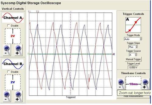

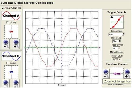

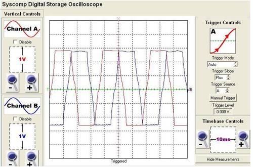

Had some time, so I have put together some graphs. Unloaded, gives a good sine wave.
2 graphs of waveforms as seen on the rectifiers. Light loading at just above cutin, and the second graph producing approx 300W
This graph is the AC waveform across the alternator, for 2 phases. The AC coupling caps do modify the way the windings work. There is no DC current in the coils. The voltage rises at a steady rate, to a maximum and then reverses.
The caps are operating at a temperature of 24C, and the rectifiers are at 31C. These same caps were in the F&P setup. They are passing more current and operating cooler with the lower output frequency of the AxFx. approx 1/4 the frequency.

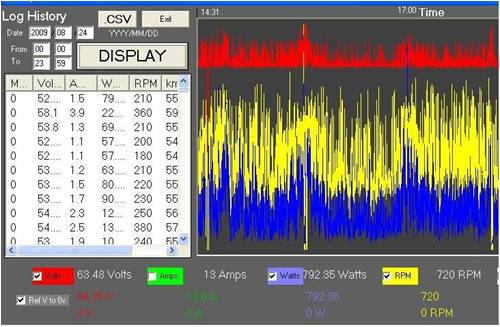

This next pic is some sustained power outputs of this mill, that is furled heavily at winds above 9m/s. This has 2.4m rotor, into nom 48V loading.
The max power recorded has been over 1000W, but this recorded portion gives 790W max. Average is 200-300W. I have detuned this with a modified loading and shutdown at high windspeeds. There are 3 shutdown periods shown on the graph. Protection in storms is important and this system now works pretty well.

Looking good so far.
I can't help but feel that you have the prop and the alt underloaded. 700+ rpm for 700W is much higher than I would expect. The blades must be running about 1.4 x TSR...., and that alt is running at twice as fast for 700w than I would expect....
I wonder if some bigger caps may tame the rpm down a bit, and give the alt some load... ie come back to TSR 6-7.... is this right??... you do have caps in series all the time?

Posted: 01:35pm 25 Aug 2009
Hi oztules,
The first graph shows the waveform just at cutin. The waveform is slightly fatter than an ideal sinewave, but what the heck. The only option is to reduce the magnets and coils, and that would not do. The can was the limiting factor. On my original AxFx mill, the magnets are touching.
The TSR is high, and is similar to my first mill. The mill is fully AC cap coupled. The mill stalls heavily without the caps. Very electrically stiff.
The machine is 2.4m dia and maxxed out at around 12revs per second in 12m/s winds, heavily furled. The TSR is approx 7.5. There would be a point at a lower windspeed where the TSR is higher. I do not have a good correlation yet with rpm v windspeed. There is not sufficient blade noise to indicate a TSR problem. I may be able to do away with the series caps with bigger blades, and only use the cap voltage doubler. These are early days yet. The magnets are not even properly encapsulated yet.
One set of my new blades[2.9m dia] are much thinner, so these will operate better with a higher TSR[same loading as present]. The 2nd set[3m dia] are longer versions of the current blades. These will require more loading[probably candidate for no series caps]. I need to do things with a system, to reduce the number of times the mill is lowered and raised.
All will be tested eventually. Have to wait for the weather to ease up a bit. The weather must be hammering your place by now. Wish U had your mill flying?

My mistake. Upon a quick real calculation, TSR is pretty close, it was the volts/rpm that had me in a spin.
It will support significantly bigger prop with direct coupling... it would put out some serious power then. not as much as phils I suspect, but much greater than 1kw for sure... will be worthwhile.... furling will become far more important then from a heat perspective, than Phil suffers.
It would also lend itself to even bigger blades again, and low furling to harvest the low wind power very effectively.. and forget about high power all together.

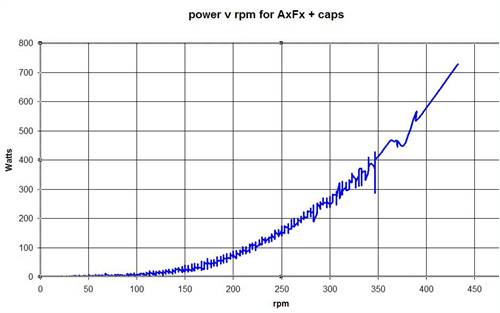

I have modified my piclog and have improved the dynamics of the rpm and current measurements. now have additional analogue and additional digital filtering of the raw data. The effective data sampling time is increased to 2 sec, but for 10sec logging interval, is still fast enough.
My suspicions with the erroneous rpm was confirmed.
Here is the power v rpm graph for the mill. Cutin is around 50rpm, approx 5W output, increasing with a cubic loading up to 433rpm producing 728W. Here is the graphed data, for a 2 hour recording session. The data was only sorted, no outliers found.
The full potential of this alternator is clearly not reached, as there is no flattening of the output curve.
The larger blades will be tested asap.
This mill produces 50Hz AC output at 500rpm. The cap arrangements, with 3phase cap doubler and Series cap coupling work at lower frequencies as well as those obtained with a F&P mill. I have 12 x 560uF 350VDC back to back caps in the doubler, and 6 x 820uF 350VDC back to back caps in the series arrangement. I tried a larger series cap system, but this overlaoded the mill, and power output decreased. This is correlating well for the winds and rotor size/furling point that has been tested.
This last test confirms that caps really give almost ideal loading characteristics for even a battery loading. This stator would normally be useless on even 48V loading, but caps allow it to perform probably better than a stator wound with optimum turns for the load, but without caps.
Would be good for some other serious windmill enthusiasts to provide results from their own cap testing experiments.
Gordon.
