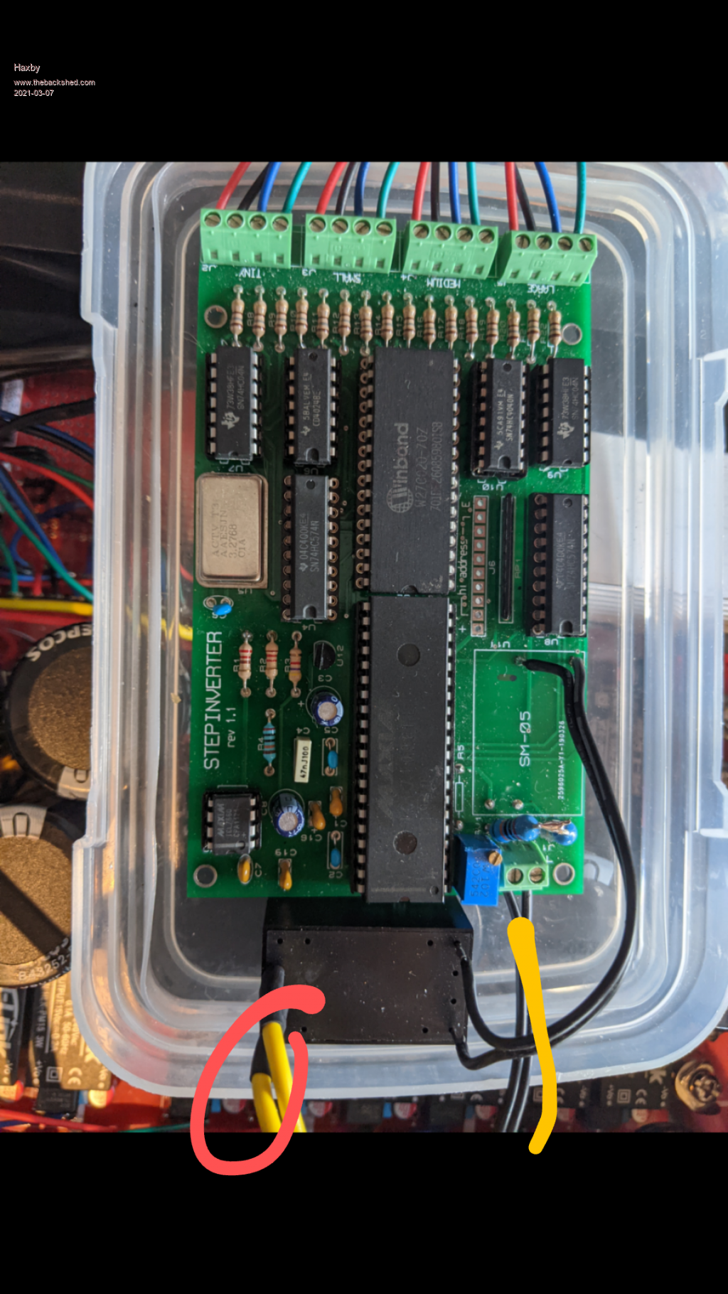

Posted: 04:45am 07 Mar 2021
Update:
So I'm testing with small loads of 100 watts and virtually everything is going well with my warpverter. Hooray!
But.... I think my warpverter voltage sense input is sensitive to picking up noise.
At around 320vdc in, and when I'm actively turning the scratchy Variac knob, sometimes the warpverter turns off all IGBTs for just a split second.
The warpverter is running from a hi-link 5v smpsu and that supply is filtered through a common mode filter. The warpverter sense terminals are not filtered at all.
Should I add another filter or a capacitor for the sense terminals?
Red circle in the photo shows filtered HVDC input. Yellow line shows voltage sense wires.

Vsens resistors are 3.3k and 400k. Could these high values be the problem?
