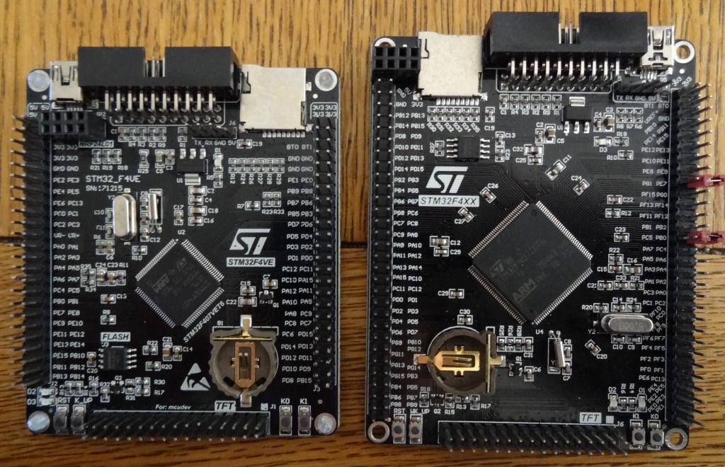

I ordered two of the same board from Banggood and they arrived today, but as you can see, they messed up and sent me two different boards.
The header pins were badly bent in shipping, but I straightened most of them out before taking the photo.

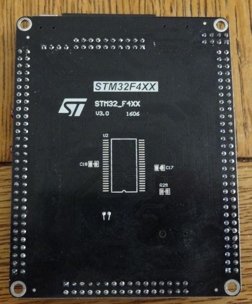

The larger board also has pads for a chip (RAM ?) to be soldered on the back.
I also ordered a couple of the displays to go with them (they're both the same).  I was looking for some displays with female connectors to dock straight onto the STM board, but the cheap ones on Banggood and Ebay all seem to come with male headers, so I'll need a female-to-female ribbon cable or similar to connect them.  Maybe an old IDE hard disk connecting ribbon would work?
I shall experiment with the boards and let you know if I can get either/neither/both of them to run Peter's firmware.
Edit to add: Both boards accepted the firmware.  Thanks to Peter for his very clear instructions in the O.P. of this thread.  Both boards report the same memory (144K Flash, 114K RAM).
The larger board has BT1 and BT0 swapped side-to-side and "moved up" one pin (there are only two 3.3V pins above them not four).  Also, although there is a GND adjacent to BT0, the pin on the side adjacent to BT1 is now VREF+, so you have to use a jumper lead rather than a link to connect it to GND for the first stage of flashing.

The smaller PCB is the ciorrect version and should work fine. However for the bigger.....
The MMbasic firmware uses physical pin numbers to protect reserved pins from normal MMbasic operations like initialising the pins state on boot. I'm pretty sure the display won't work on the bigger screen and you may find things like SDcard don't work either. Pin mappings will be all over the place and even using SETPIN PB6 etc won't work as that also maps through the pin number table.
Edited 2019-10-02 04:05 by matherp
