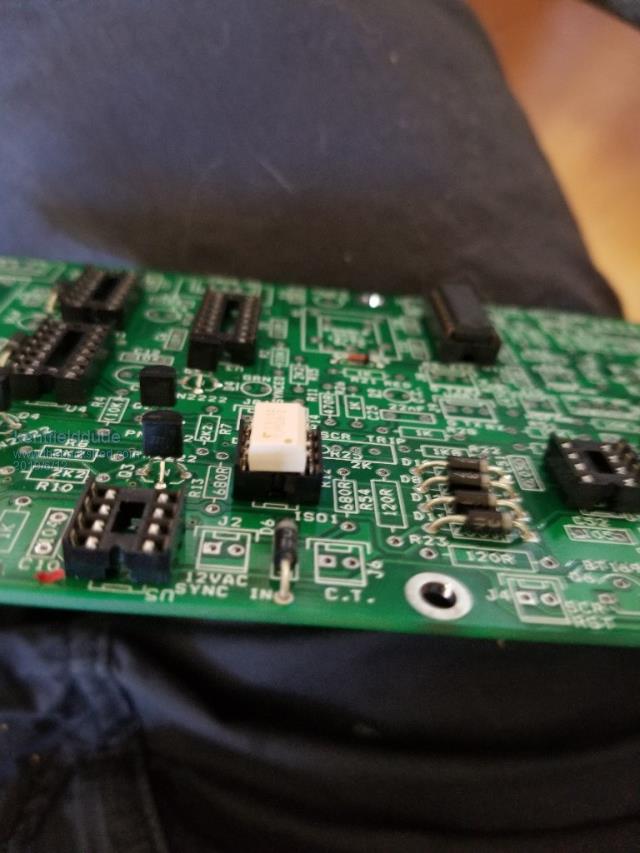

Is this the right opto? I saw some were using single version
renewableMark
Joined: 09/12/2017
Posts: 1679
Posted: 10:24pm 12 Jun 2019
Mine had 4 pins, have you got a link or a better pic of the part?
If you got the tlp523-2 that is a 2 channel, the top channel just wont get used.

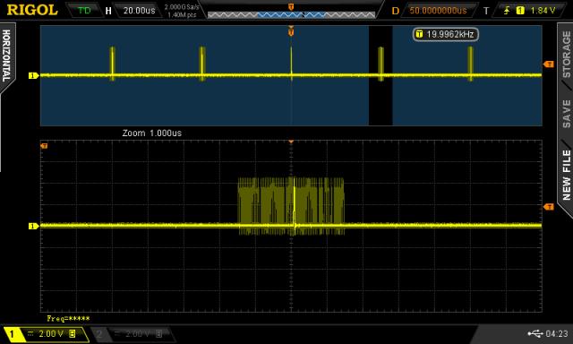

Below is a capture of the STM32, running an interrupt code that just pulses an output pin, at 20kHz. The capture is triggered on one pulse and in the lower screen shows all the occurrences of the following pulse. There is jitter in the interrupt service starting time of about +/- 1.5uS.
If I did this with the Nano, we would see only one pulse, superimposed on itself, and my oscilloscope's performance is insufficient to discriminate anything much less than about 5nS. No point in showing that capture here.
This jitter is the result of the STM32 running a bootloader that must poll the USB status registers even if the USB cable is not connected.
Programming the STM32 can be done without a bootloader of course (that's how I managed to load the bootloader in the first case!) but it's a pain.
Then you get much less jitter, down to the DSO's time resolution.
