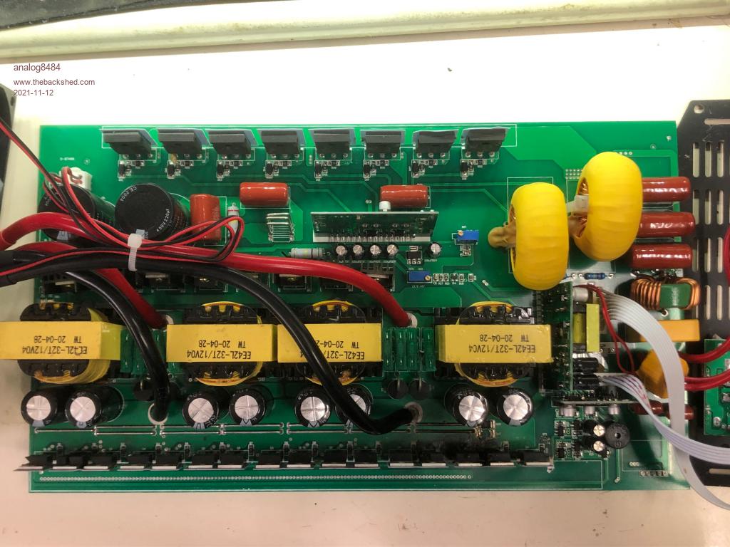

The inverter is a commercial unit with 12VDC nominal input and 240VAC/60Hz nominal output rated for 2000W continuous/4000W peak.  Actual input was about 13.6VDC in the test.  Regarding pre-charge, I have a fuse/switch on the positive line between the battery and inverter and I used a resistor (10R/100W) to pre-charge the inverter until the voltage on the inverter input terminals reached the same voltage as the battery before closing the fuse/switch.  The pre-charge resistor was left connected.  So, I don't think the inverter input capacitors were discharged when I restarted the inverter.
Below are some pictures of the inverter.
Overview:

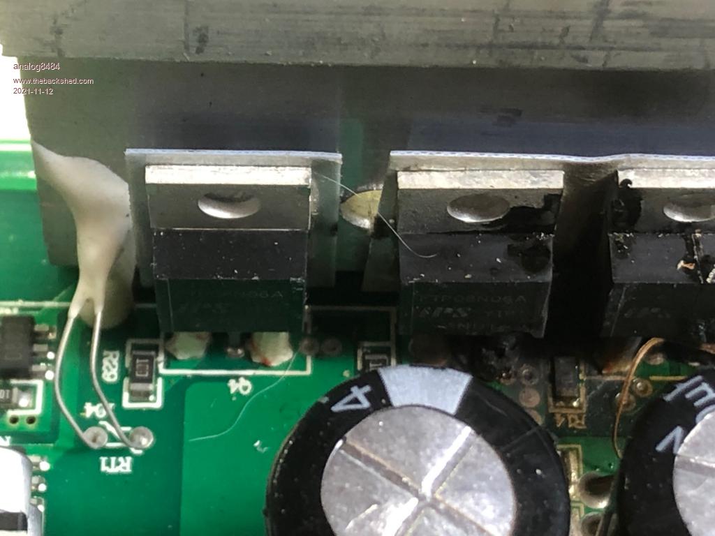

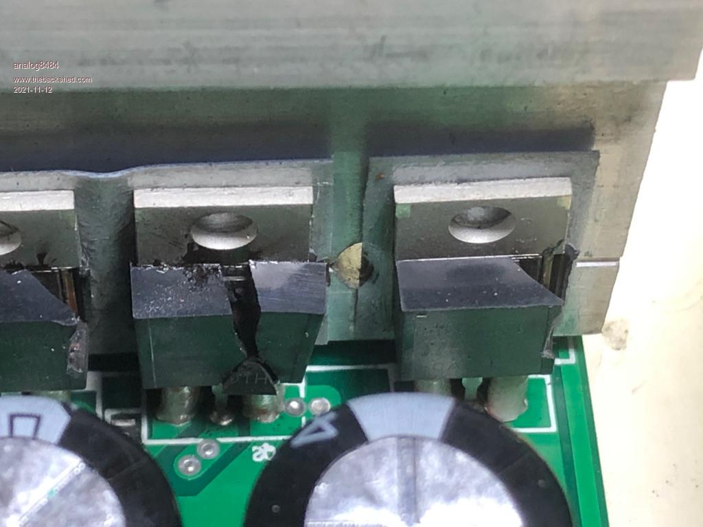

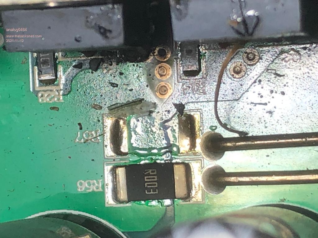

Blown input MOSFET's:
I believe these are input current sense resistors due to the low value and one was blown off.

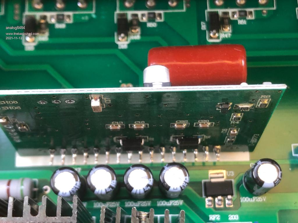

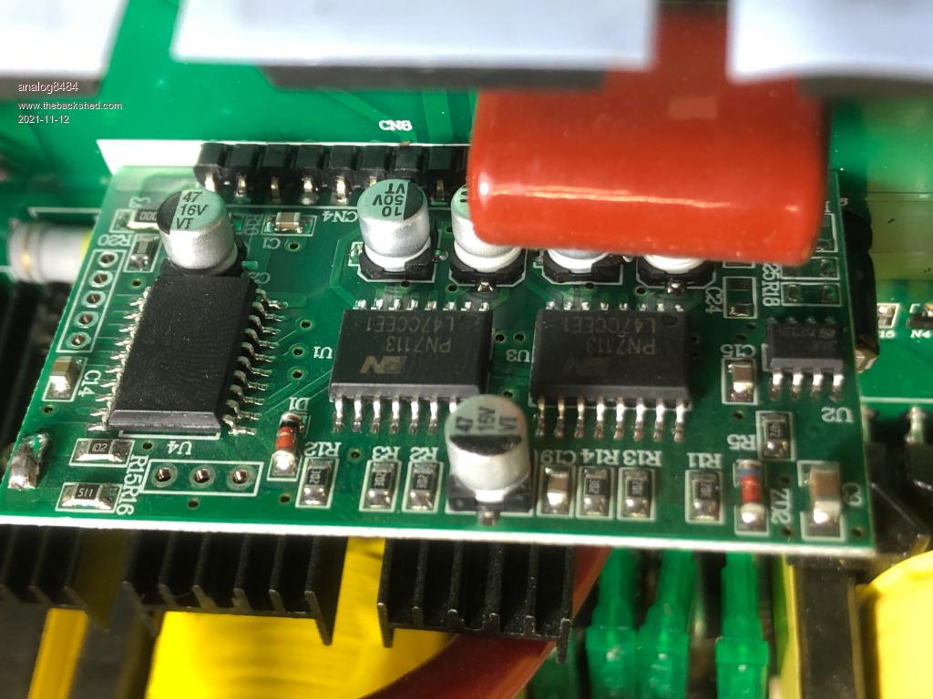

Control Board that looks similar to egs002:

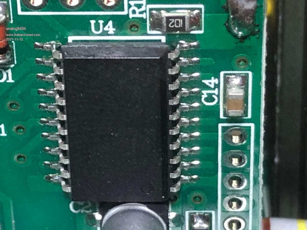

Close up of the controller with no markings that I suspect is an eg8010 clone:

I must say the little sinewave PWM PCB looks a lot like the EGS002 PCB - in engineering we call it being "inspired" by someone elses design - the word copy never occurs.
Your inverter is quite different to the types mostly encountered on this forum. It first converts the input nominal 12V to ~ 350 -400V and then chops up this voltage with HF variable PWM to create a sinewave which travels through the big yellow inductors and is filtered further by the 3 red poly capacitors to create a fairly smooth AC output.
Due to the amount of trouble this type of inverter has, especially its inability to drive higher start up currents required by many types of load we went in a different direction.
The majority of experience here is to run from mostly 48V and a few 24V systems and we create the variable PWM and apply this to a big choke & toroidal transformer system that has plenty of overload capability to start up big loads with ease.
Your inverter failure might just be one of those things that if you replace all the dead FETs with at least IRF3205 or stronger IRF3206 or strongest overkill IRFB7534 types it could work or it could go bang again as there may be a fault also on the secondary side which could be FETs Diodes even failed poly capacitors that caused the original "bang" and reflected all the damage onto the primary side.
Depending on your level of expertise and patience it might be a cinch or a nightmare to make it work again - cant be much more help from here, cheers and good luck ! if you have a local "technical" friend I would take advantage of their help if offered.

The EGS card appears to be driving the high voltage output side,(Correct me if I'm wrong) so much the same as the low frequency drive just has a high voltage buss so no need for a step up transformer, still has choke and output filter.
As there was no load attached the IGBT's gate drive and EGS might still be ok, but check it to be sure.
Its the converter that has stuffed up, and its quit typical that the high voltage rectifier mosfets are shorted as well, when the low voltage mosfets are blown to pieces.
Why the rectifier and low voltage mosfets have blown? one possibility, I should say CHAIN of Events, If there was some sort of inductive spike on the battery supply to the inverter, this could go through the little transformers to be converted to a high voltage spike shorting the rectifier, this could overload the little transformer and blowup the low voltage fets, when the fets blowup they cannot be producing any square wave or enough power through the little transformers to  blow the rectifiers to pieces, so no visible damage to them, have seen this before.
This could be caused by interrupted signals from the power supply and low voltage bridge driver and the result is the same.
Its worth checking all associated drive components etc and repair where necessary.
The exact cause of this inverters destruction I don't know, just the likely problems.
Whether you get it working or not, it is always a learning experiences, and that experience is often handy for other things.

The side that blew up is the push-pull DC-DC converter. Each of those transformers has a center tap connected to battery positive. The ends of each primary are alternately pulled to ground by the FETs, each transformer having four FETs controlling it. Often all those FETs are driven by a transistor buffer from a TL494 or equivalent PWM chip. You should snip the FETs off and scope the gate pins to see what the signal looks like. The egs002 looking circuit controls the upper 8 FETs that don't appear smoked.

With regard to how a problem on the secondary can take out the primary. Suppose a shoot through of some sort occurred in the output section, the FET/IGBT(s) is taken out and essentially becomes a short across the secondary of the 4 x up converters (shoot through at 400V is pretty much always destruction).  Have you measured across all the output devices - my guess is that they might be ok, shoot through is not proved yet to be the culprit but if it was, at least some of the output devices would usually be damaged/shorted.
If output devices are dead, the poor primary converters are now trying to run into a shorted secondary load, huge currents now flow from the Battery into the primary FETs and within milliseconds there are bits of plastic and smoke flying around the place.
The impedance of the primary has to be really low by design as the supply voltage is only 12V nominal and currents of ~ 170A+ are required for ~2KW+ and if we believe their 4kW surge rating 340A+ are required.  As there are usually no current limiting parts - including fuses - unless there is a whole bunch of 30A blade fuses in parallel - (normally they are the only parts left intact whilst most other bits are turned into vaporized metal and plastic) its not pretty when things go wrong.
The secondary diodes and the primary mosfets both have a lot of stress placed on them at startup as the 350/400V capacitors are usually discharged and it relies I believe on the 2 x R003 resistors in parallel on only one of the 4 boost converters which is no doubt used to control the SG3525? switching to limit the throughput power of all the converters and just hope they are all sharing nicely.
Some of these inverters are of Asian origin and are just built to a price (a whole lot less than you paid) and are sometimes copies of reasonable equipment, but in cost cutting and copying sometimes subtle design features are compromised leaving them prone to self destruction with no obvious reason.
Summary: if the output devices - including rectifiers polycarbonates and mosfet/igbts are all ok then it is likely that only the primary boost converters failed for some reason.
Your challenge is now to find all the dead bits including any FET drive buffers from the SG3526, remove and replace them all without causing further damage. Access to a good solder sucker would be very handy and if used properly it will help minimise further damage.
Then when finished you can either try a current limited 12V supply (no load to the output) or whistle a happy tune whilst you connect it back to the LIPO vaporiser.......
I consider myself to be fairly competent to tackle a repair like that but don't take 45+ years of experience for granted - this may not be an easy repair for someone with relatively limited experience & equipment. You might be lucky but remember even when built as designed and without abuse or even a load it still went bang.  There are ways of supplying low currents and control voltages and "fooling" circuits into run mode & minimise chances of damage before applying lots of current - but that's beyond what I'm prepared to try to describe in detail here.
Lastly don't think of no load on the inverter as zero load for the components, as when starting from cold the "load" is at least the boost capacitors rapidly being charged up.
I cant really dress this up nicely as it is what it is ! Maybe the gods will be kind to you and it will be just some routine parts replacements and it will run again, who knows?

  wiseguy said  With regard to how a problem on the secondary can take out the primary. Suppose a shoot through of some sort occurred in the output section, the FET/IGBT(s) is taken out and essentially becomes a short across the secondary of the 4 x up converters (shoot through at 400V is pretty much always destruction).  Have you measured across all the output devices - my guess is that they might be ok, shoot through is not proved yet to be the culprit but if it was, at least some of the output devices would usually be damaged/shorted.
The output IGBT's all appear to be shorted out based on what I can measure but there is no visible damage to them.  Same with the rectifier diodes.
That's a great description of what I observed.  I still wonder why the input stage over-current/short circuit protection didn't really help.  I do remember hearing the buzzer going off as the explosions happened.  So, the inverter definitely detected a fault condition.
Yes, the LFP battery used has internal resistance < 20mR.  I think that contributed to the  severity of the failure event.  My AGM battery's internal resistance is more than 10x?
Actually, there are 8 30A fuses and they are all fine.  So, I think the short circuit current was very high but didn't last long enough to burn out the fuses.
Yes, it looks that way.  Definitely a design compromise.  Are you aware of a high frequency inverter with more robust design?
The output stage is definitely all shorted out.  Thanks to your great insights I am now more convinced that the failure started in the output stage (eg8010 bug or control signal interruption/noise).
I usually use a bench supply limited to 5A for such testing/repair.  However, I am now going through a warranty repair/replacement claim so I don't want to make any changes to the board at this point.  If I get to keep it later then I may attempt repair more for the learning experience.
I can see that.  I wonder if that happens on warm restarts as well.
Thanks for all your help.

There are a few things that can blow inverters up.
Poor solder connections are a big one. The last photo you put up of the IC u2 looks to have been soldered very lightly.
If you lose drive to mosfets they go bang, if one goes bang they almost always all decide to join the party.
Anything that is plugged in can cause problems too.
the 8010/egs002 board is one point where things can go pear shaped.
Any other chips that are plugged in can also be points of faulure.
Also there is always the question of whether the assembly line had good static electricity protections. Mosfets are easily damaged by static, and it can take a while to show up.
good luck with fixing it. Make sure that you change any drivers for the mosfets.

Sorry I said the chip was U2 but it is in fact U4 when i looked again.

wiseguy
Joined: 21/06/2018
Posts: 1335
Posted: 09:52pm 13 Nov 2021
My testing usually starts at 30mA at 12V and depending on results will eventually be set higher than that in stages as required.  But that would also be after I have applied current limited voltages etc to the secondary first to check that it appears to work ok.  At my age I try to avoid the sudden loud bangs and stressful stuff as it might not be good for the ol ticker.....
  analog8484 said  I can see that.  I wonder if that happens on warm restarts as well.
I am assuming that the inverter has an on off switch of sorts (not one that carries 350+ Amps) the on off switch usually just shuts off the boost converter driver section. The 12V input capacitors remain charged but the output ones will usually lose charge fairly quickly.
Ok so the outputs are shorted - so now we know how/why the primary died. After another look I can now see the bunch of green fuses - totally missed them until prompted by your comments.   Warranty replacement would be the best outcome not sure what you have over there, we have a "consumer affairs" government office here where if suppliers won't come to the party they will take up your fight with the importers/sellers and can fine them heavily if they wont comply.  We also have a statutory warranty scheme that says goods sold must be fit for purpose and last a reasonable time commensurate with purchase price. A 12 month warranty just scares off the faint hearted, the statutory warranty can be up to 5+ years - it is not well advertised though, maybe you guys have a similar scheme ?
Cheers Mike

  Godoh said  There are a few things that can blow inverters up.
Pete
Thanks for the info.  I did pick at the legs of the eg8010-like and sg3525 controllers and they seemed solid but various manufacturing deficiencies are certainly another possible failure cause.  I do wonder if the shoot through problem had been ongoing and stressed/degraded the MOSFET's over time.  One potential reason why the problem didn't kill the inverter before could be that the previous DC power sources used couldn't provide the destructive current surge that LFP battery could with its much lower internal resistance.
