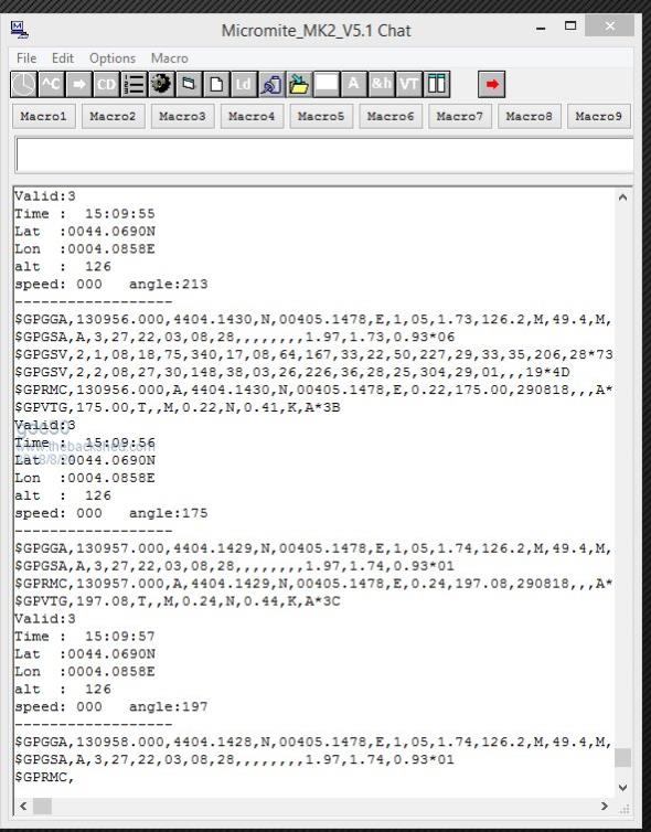

This update (no version change) fixes a couple of bugs in GPS handling.
2018-08-29_211035_Armmite1.3.zip
In addition I've included a diagnostic for GPS.
Use
OPEN "COMn:baudrate" as GPS [, timeoffset] [,monitor]
e.g. OPEN "com4:9600" as GPS, 2, 1 'switches on GPS monitoring
Monitoring will output to the console the GPS messages as they are received. The critical message is GPRMC. The code looks for the parameter after the time to be an "A" to indicate data is valid. If the parameter is a "V" this indicates the data is invalid. This drives the GPS(VALID) function and no other GPS functions should be used unless GPS(VALID) is non-zero. Monitoring can be turned off with:
CLOSE GPS
Re-opening with the monitoring parameter set to 0 or missing will run normally.Edited by matherp 2018-08-30
goc30
Joined: 12/04/2017
Posts: 435
Posted: 01:22pm 29 Aug 2018
hi peter
test update ok, no pb, gps work correctly
it is a good idea to put monitoring function
re-opening Com is also good
tomorrow I will test function "send frame to gps" but it is more complexe because not all gps card have this possibility
Edited by goc30 2018-08-30
